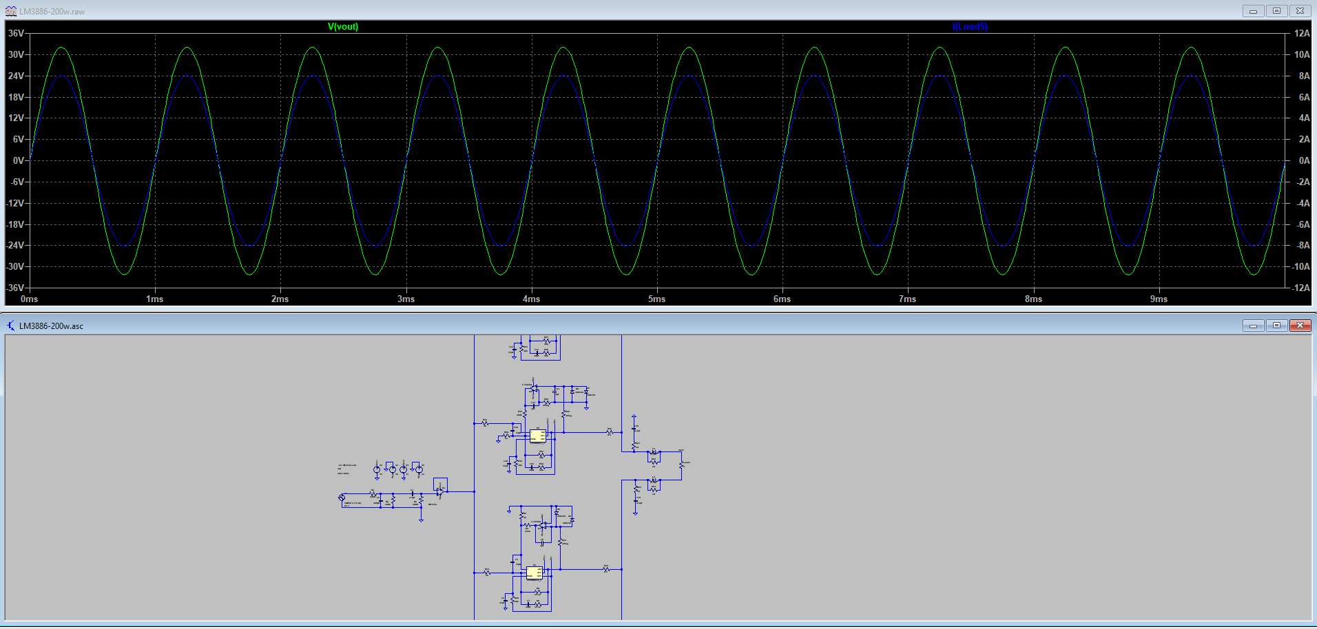

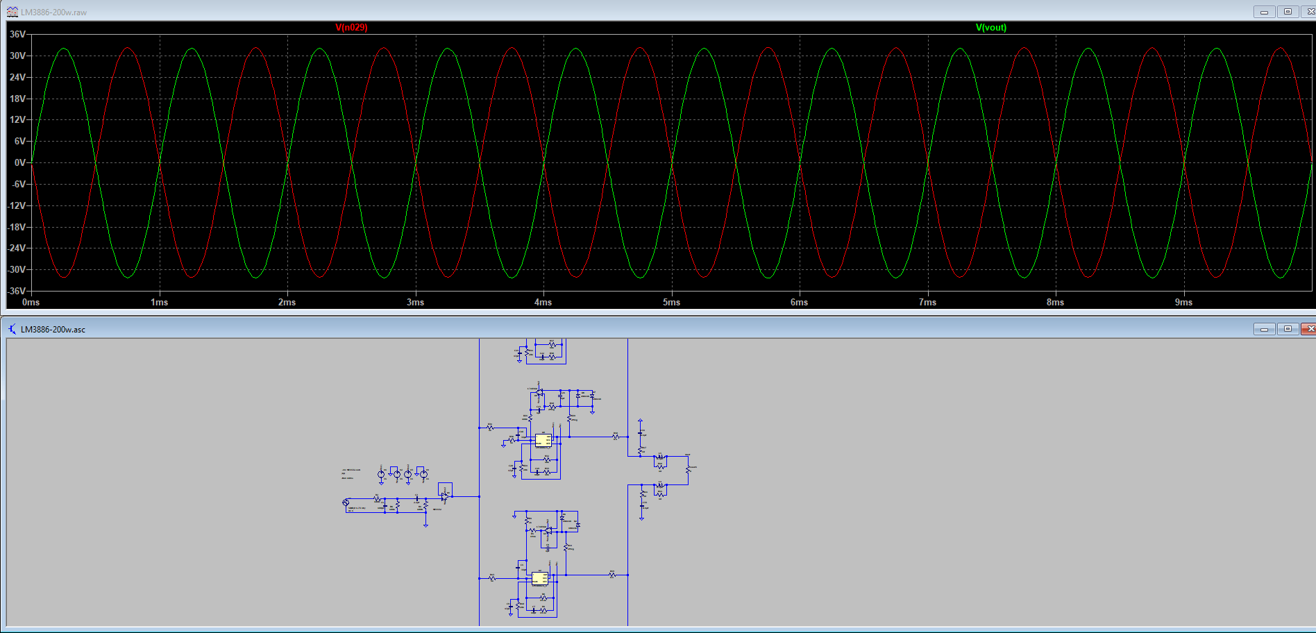

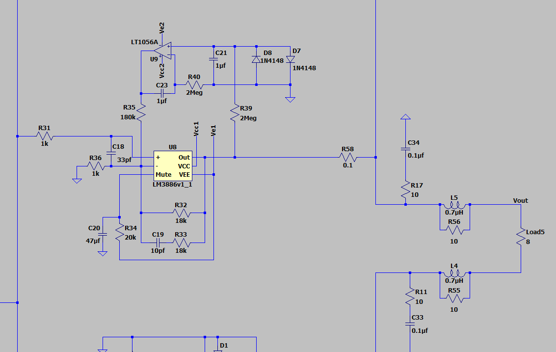

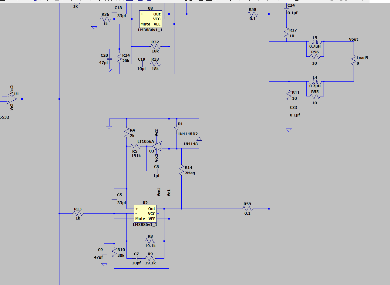

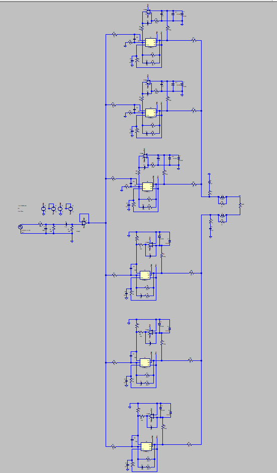

Hello,
I have drafted schematics in the LTSpice of the six LM3886 that could be a really cool project to attempt. Attached are simulation files and LM3886 model. Importing the model basically requires to copy it all into your LTSpice internal directories and then edit all of the files to correct the path string.
