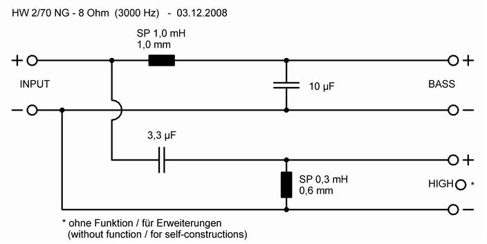

6 Ohm Woofer & 8 Ohm Tweeter
Has anyone had any experience (or possess the knowledge for an educated opinion) regarding matching different impedance drivers, via a crossover circuit - e.g. 6 Ohm woofer & 8 Ohm tweeter (or vice-versa)
I know impedances alter with frequency so could I get an unlucky mismatch or a lucky match or ……… “is 6 Ohm and 8 Ohm close enough for jazz”?
Thanks in advance, grateful for any help & advice.

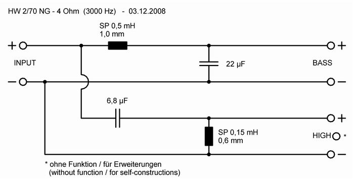

As mentioned, without driver and cabinet details it is hard to rough something up. But matching a 4 ohm (nominal) bass to an 8 ohm (nominal) tweeter is almost standard practise at the budget end. Usually all that is required for level matching is a wirewound resistor attenuator on the tweeter. A wirewound input resistor and a Zobel is also good on a tweeter, but the shunt coil gets smaller.
You will notice that the root of the product (LC) of the filter values stays the same for a given crossover frequency. The ratio of root L/C is proportional to the impedance. DC voicecoil resistance of a nominal 8 ohm driver is usually 6 ohms. For a nominal 4 ohm driver it is usually around 3 ohms.

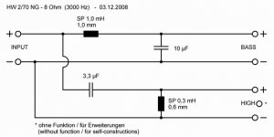

You can simulate the speaker with similar Visaton drivers here. The complete answer. :cool:
Downloads
Everyone's comments are uncovering, for me, an even greater degree of potential complexity than I had considered. I had thought, naively, that if TS values were followed forensically, together with a perfectly calculated crossover - accounting for driver response & sensitivity, in a rigid cabinet, then one would have built the "perfect" speaker - yes I know nothing's perfect. So all I would have to do is "amend" the 8 Ohm to 6 Ohm using the parallel resistor as Dug suggested. I also thought that using a Zobel circuit would stabilise the impedances enough (bass at least........can Zobel be used for tweeters or would it be audible at high Hz?) that the drivers fluctuating impedances with frequency wouldn't have much effect on crossover component values. I can design crossovers from impedance, capacitance & inductance tables and "match" speakers with the same impedance and choose a sensible crossover frequency BUT I don't have analysis equip to see the effects, only ears. So........ is Dug's suggestion (my preferred route) as good as it gets without an oscilloscope.
