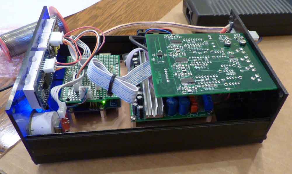

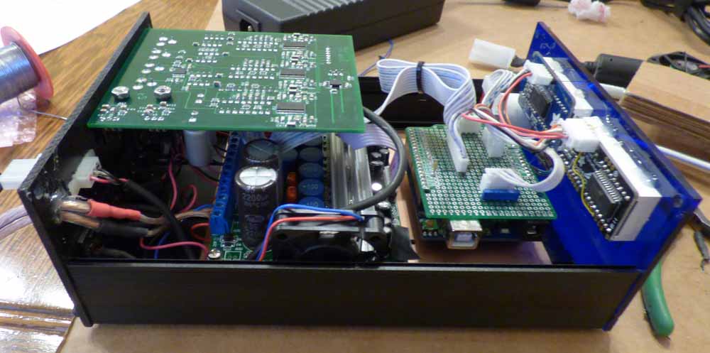

The PGA4311 is simply 2 PGA2311s in the same package and is loaded exactly the same as a pair of PGA2311s. My Arduino code is currently
loading 3 PGA2311s. Altering it to run 1 more would be a little more than trivial as I also run the channels independently. It is also using NJW1119A
Bass/mid/treble tone control chips.
Do you work with Arduinos? The code is very similar to C. If you want to try
you can have a copy. If you buy an official Arduino they are around $25. Chinese knock offs (I use them) are between $5 and $10 out the door.

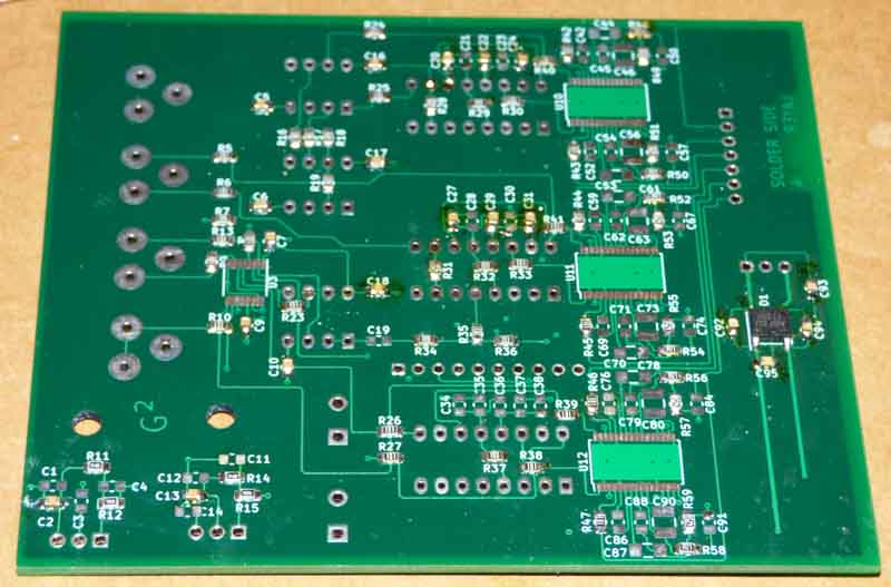

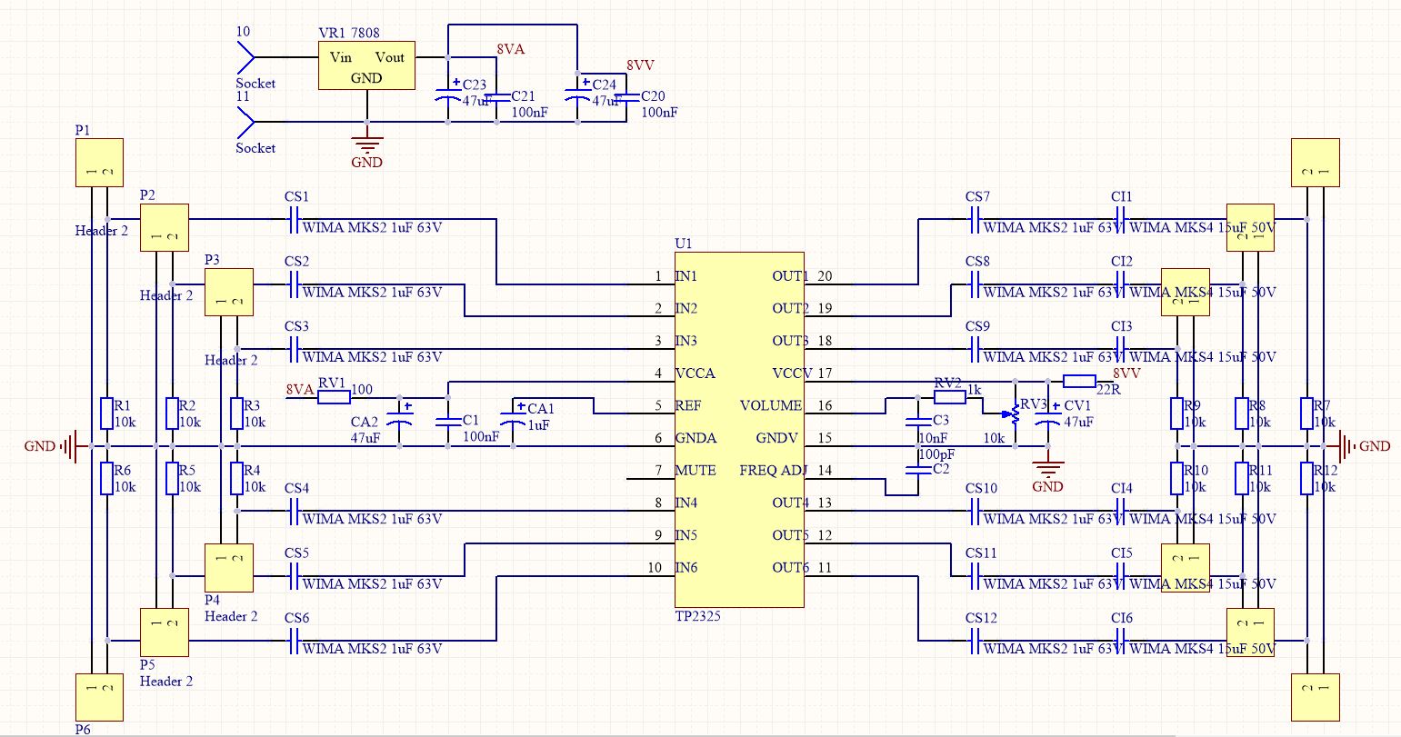

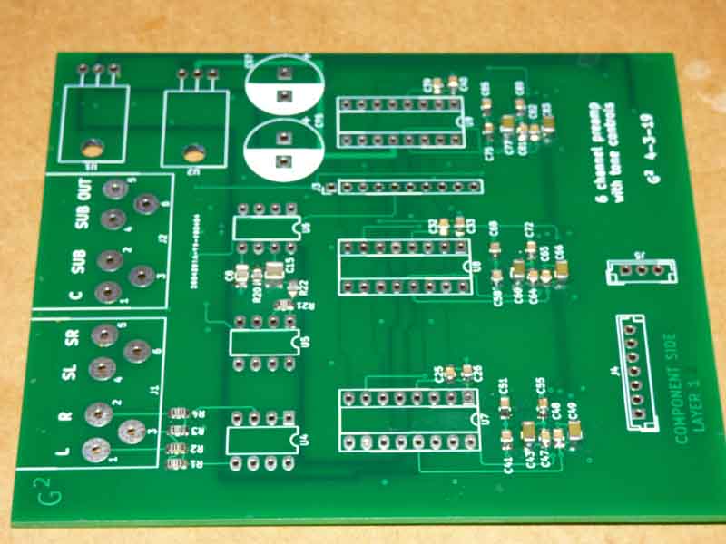

Hello
I will oder tomorrow the PCB
What do you think about routing?
Board is 100x100mm and empty space is used for CLC-filter for the amp section.
I just received the PCB. Footprints are all good.
I just wait for the IC socket. I forgot to order it befor. I want to have the possibility to remove it easy.
I have 4 pcbs I can sell for the shipping fee. If some is interessted you can PM me.

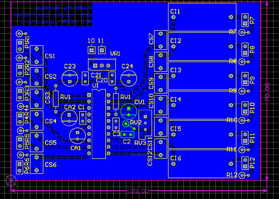

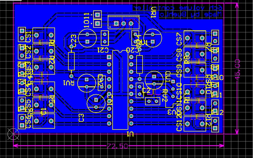

I decided to made new version with some relais for chose if sound goes through PT2325 or direct from Preamp to Amplifier.
So the signal path can be shorted. Some amplifier has such a function.

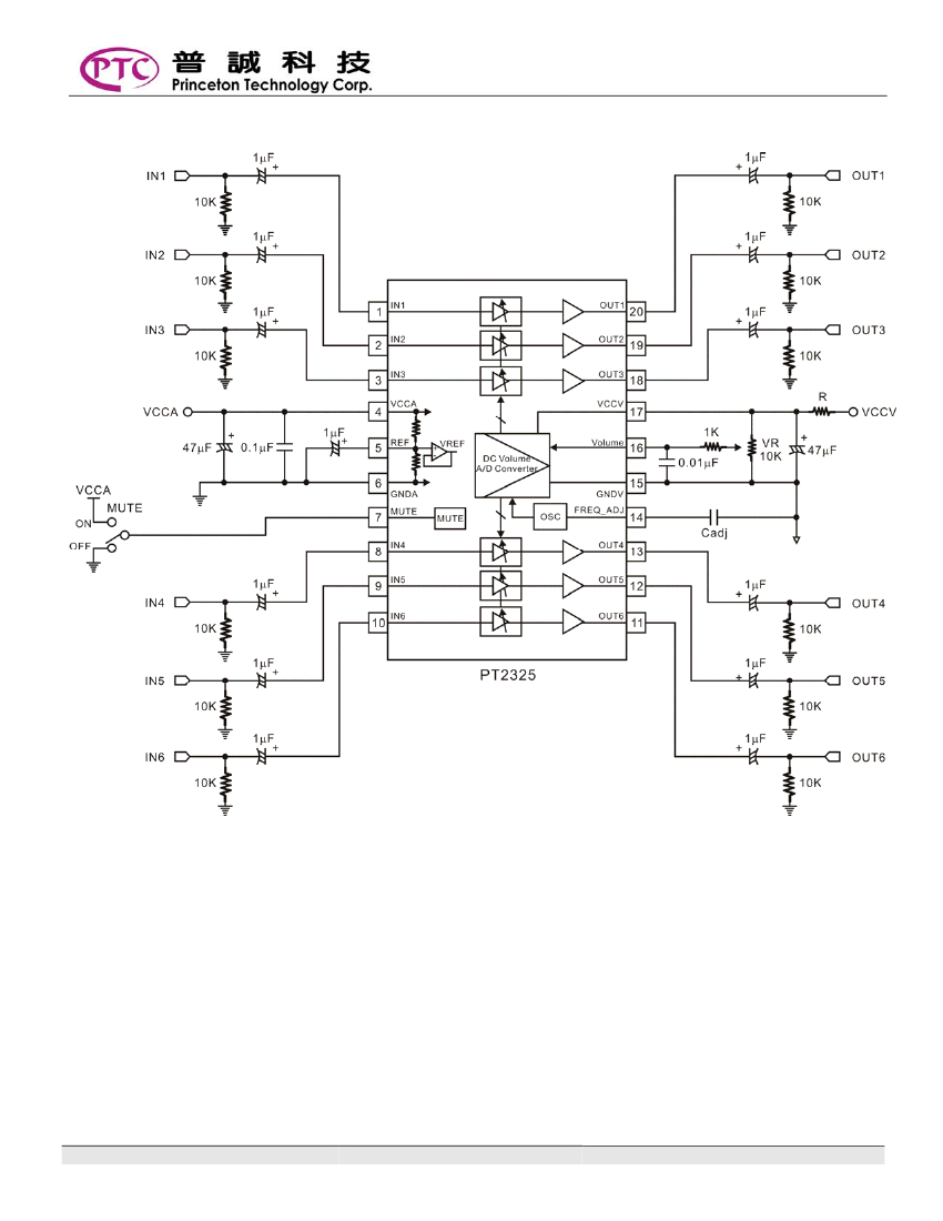

I have designed something similar however using electrolytic capacitors on the output stage. I am struggling to figure out the correct value for the current limiting resister connected to pin 4 VCCA and Pin 17 VCCV. I have tried 22 ohms on pin 17 and 100 ohms on pin 4 however there seem to be some issue when I turn on the volume control in between I can see the speaker pop. In addition is it ok to connect the pin 7 (mute) permanently to the ground so that the mute function is disabled. Please help
