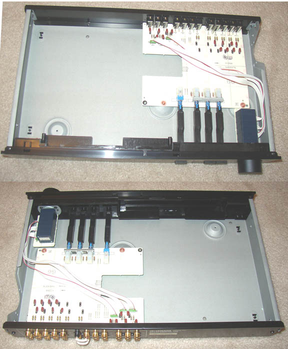

The basis for this project is a Yamaha MVS-1 Master Volume Control I bought from the local Goodwill store for $15. It has a nice 6 channel pot and three input selector. It will switch between two 2 channel sources and one 6 channel source, and also has Tape inputs and outputs. It is a purely passive device with lots of room in the case. I figure I will reverse engineer it to make it an active pre and add the headphone amp and sub crossover. I might also add a NOS DAC and USB input.

Here is a pic of the insides. I have one of the PE $5 buyout toroidal trannys that will fit in the corner easily. I might get rid of the stock PCB and just keep the selector switch part of the board. The RCA connectors are crap and will be replaced. Seems like it should be pretty straight forward.

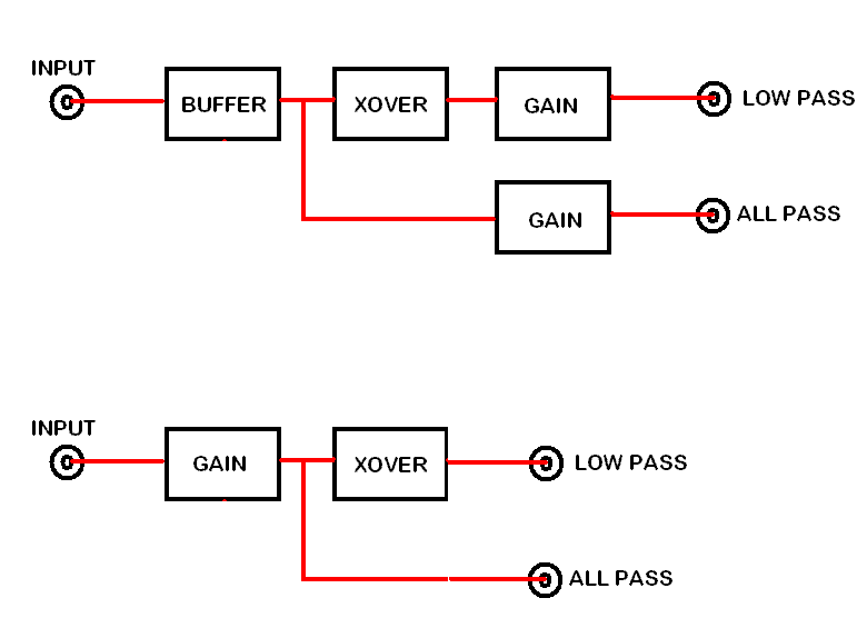

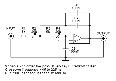

This is the sub crossover I want to incorporate. I want it to be part of the 2 channel inputs. Should it be placed after the gain stage (after the OPA2132 with gain of 3) or should I place a buffer after the input, then feed the crossover network, then a gain stage?
