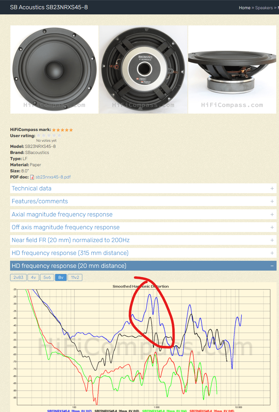

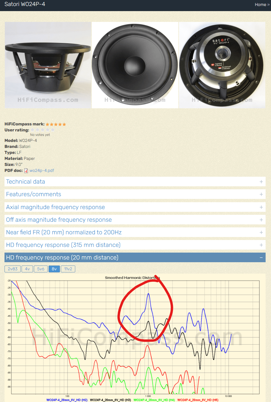

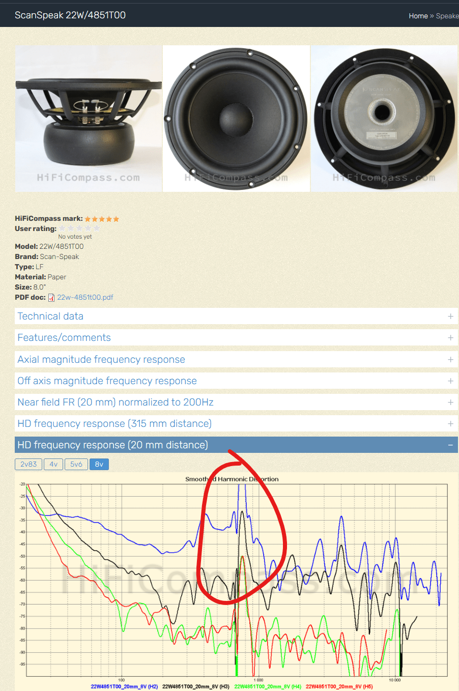

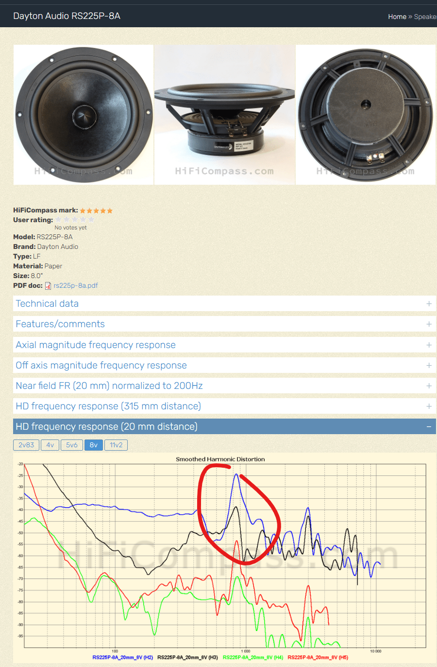

I agree the RS225 looks like the best so far. Every 8" with a paper / plastic or similar cone has a nasty distortion spike somewhere around 1KHz. (Thanks for hi-fi compass!) So this leaves me so far with a short list of:
Seas L22RNX
Dayton RS225
SB Acoustics SB23NBACS45

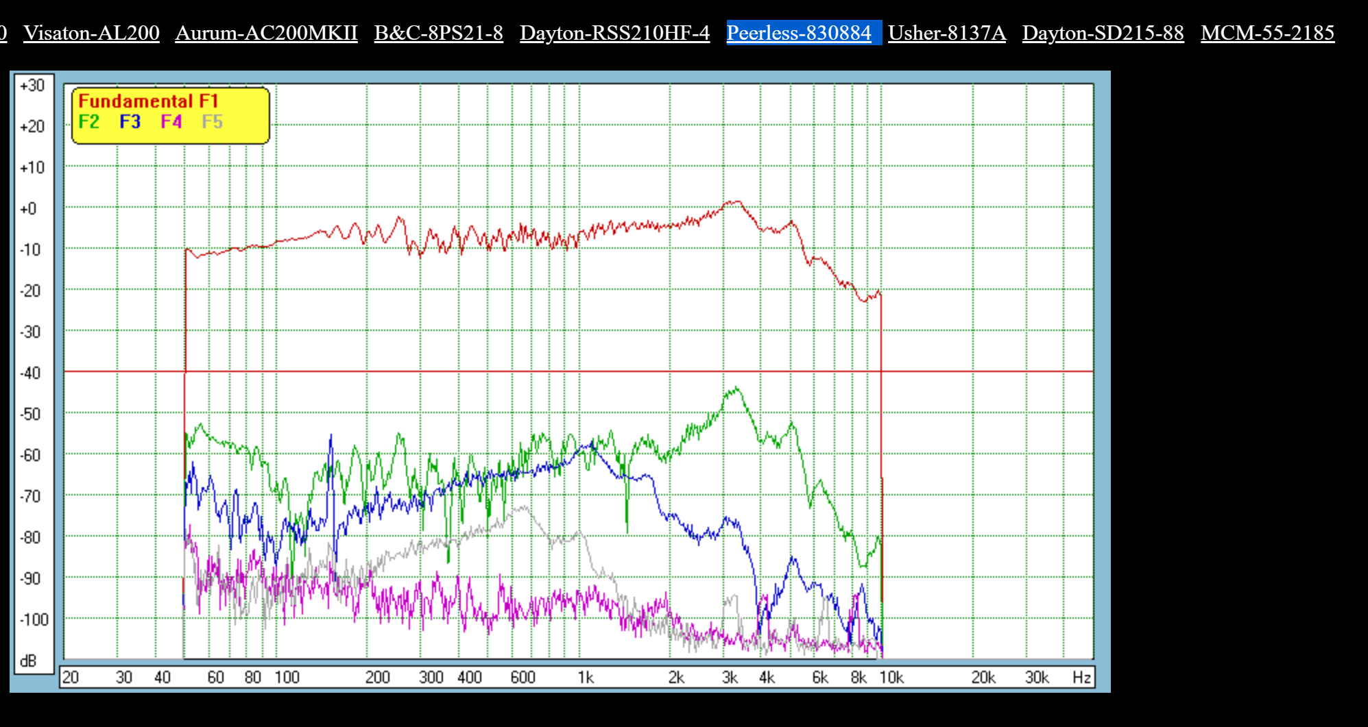

Peerless HDS Exclusive 8" (830884) looks superb from Zaphs data but I think these are discontinued?
Anyone got distortion data for the Seas?
The Wavecor WF223BD02 looks very nice too. Is there any 3rd party distortion data?

What are the midrange and tweeter? If woofer/midrange crossover is ~400Hz, higher distortion at 1000Hz is usually out of the active driver's band.
