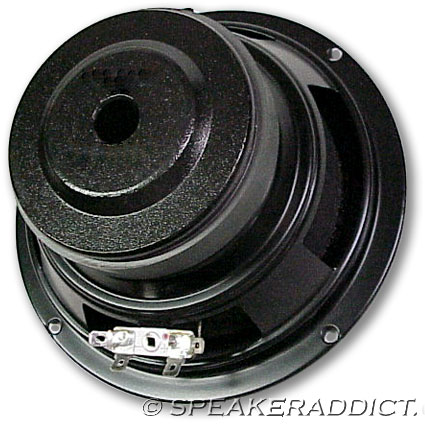

You missed out on a Parts Express factory buyout 6.5" that fit your requirements pretty nicely (299-114), I used them in my travel trailer, sound quite good. Others have used them in a wide variety of cabinets.
PE has some other 6.5" speakers that may work for you, but at a higher price.
Woofer Selection Guide at Parts Express
Tang Band and Peerless would be the likely suspects, but you say those are not what you are looking for.
sreten: Yes I've looked at that Aura driver, fs is too high. It sims with a Fsc of 143hz. almost 5db down at 60hz from my current favourite
weltersys: We saw those and bought 10.... however they turned out to be rubbish and distort as soon as you drive them with more than 15W. I think the xmax figure is wrong and it is actually 3mm. they are identical looking to a Dayton Audio sub driver with 3mm xmax.

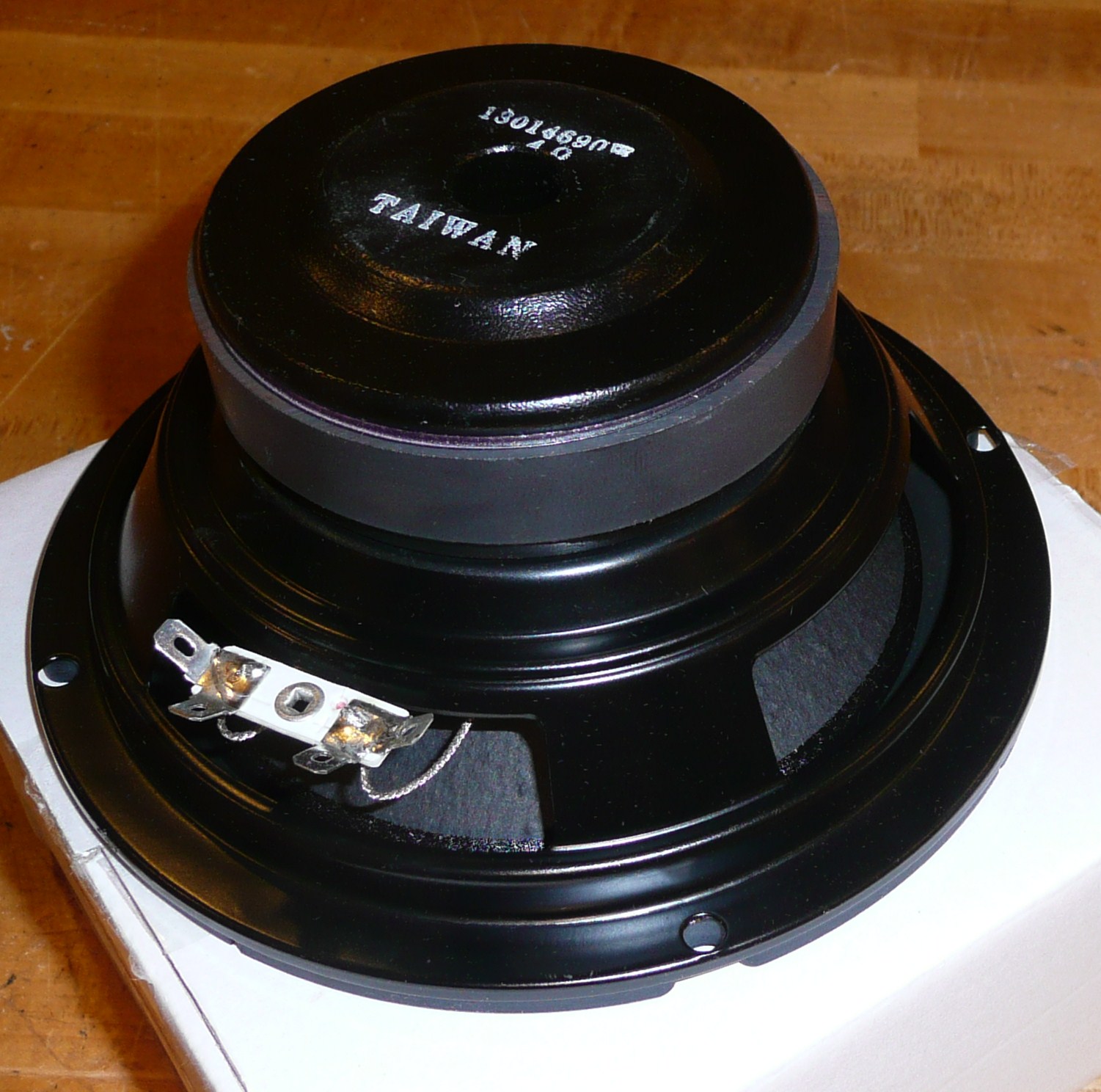

6-1/2" subwoofer with a deep profile, high-pulp, long fiber cone laminated with a protective coating that also dampens resonances. A hefty 1-1/2" dia 4-layer voice coil with 5/8" winding length provides long x-max/excursion, ensuring plenty of high-impact, low-distortion output. A bumped & vented pole piece reduces performance-robbing power compression & prevents "bottoming out" the long voice coil. Great subwoofer for multimedia systems, home theater, and multi-driver configurations. these are also PERFECT REPLACEMENTS FOR VEHICLE FACTORY ORIGINAL SUBWOOFER ENCLOSURES - EXACT 6 1/2" DIAMETER
Specifications
Model HOR6515
Nominal Impedance(ohms) 4
Power Handling RMS(Watts) 80
Power handling Peak(Watts) 160
Usable Frequency Range(Hz) 35-2000
Sensitivity(dB) 83.5
Voice Coil Diameter 1.5
Coil Former Aluminum
Magnet Composition Ceramic Ferrite
Core/Pole Details Bumped-Vented
Basket Material Stamped Steel
Cone Composition Laminated Paper
Surround Composition Rubber
Dust Cap Composition Laminated Paper
Net Weight 2.75
Shipping Weight 3.9
Thiele & Small Parameters
Resonant Frequency(fs) 38 Hz
DC Resistance(Re) 3.25
Coil Inductance(Le) 1.61 mH
Mechanical Q(Qms) 6.74
Electromagnetic Q(Qes) 0.64
Total Q(Qts) 0.59
Compliance Equiv Vol(Vas) .55 Ft3
Max Linear Excursion(Xmax) 4.5 mm +/-
Mounting Information
Sealed Eclosure 0.15-0.65 ft
Vented Enclosure 0.5-1.25
Overall Diameter 6.5
Bolt Circle Diameter 6.125
Baffle Hole Diameter 5.6875
Magnet Diameter 3.5
Depth 3.125
Mount Depth 2.875
$20 on eBAy, postage paid in the USA.
