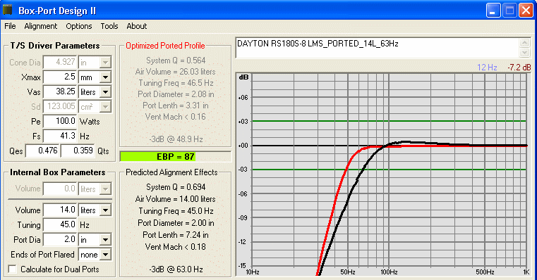

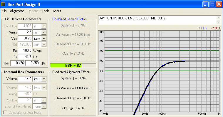

I have one loaded with a Double Chamber Reflex.
It can be in a 14L sealed or ported box too. Optimum Q. I plan to do this after I finish some other boxes I'm working on now.
