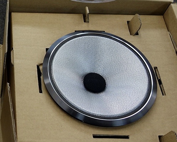

Have you had a chance to work with the one from the D4? (2022 release with minimalistic spider)

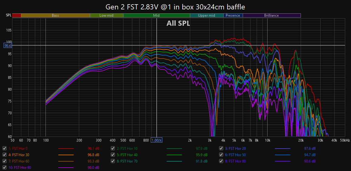

Why go with a wave-guided tweeter when you can go coaxial? The cone serves as the waveguide and the dispersion is symmetric horizontally and vertically.
I’m not at liberty to tell you what Continuum is, or isn’t. And won’t publish measurements til we’re ready.

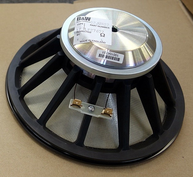

tktran303, wht is the ref of that new white kevlar unit, please ? LF27677 8 ohms ?. They have a lot different according the loudspeaker serie at B&W.
About the coaxial... that is never really pretty when you see the datasheets... certainly not easy for most diyers if no DSP. It is also 90° at best from what I understood (some BC and BMS ?). I like a lot what did 5thelement on his deep DIY BW 801 like, with the little tweeter that swaped the dustcap.... because time align should not be bad... that's not the case with most of the coaxs vmeaning you need to work with FIR and delays. (or I assume with coil pass band on the mid if staying passive... hard and expensive)

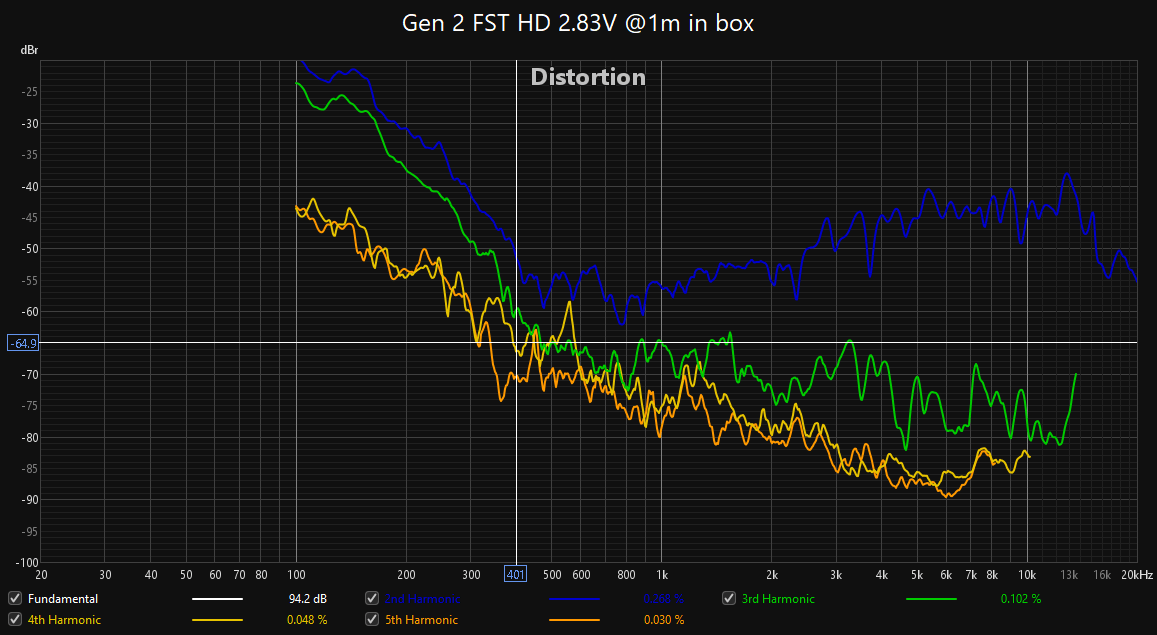

@tktran303 - I agree the breakup can be audible and aggravate IMD behavior if severe. My NE180s didn't exhibit this breakup shown above. Only a slight edge reflection around 1k.
Did not have a chance to play with D4 mid drivers yet. Mine were from 2nd gen continuum in LCR series with double neo motor. I also have N800 mids with yellow aramide / kevlar. Those have very stiff spider. Also sound very nice. The double neos are very efficient around 98 dB / 2.8V. Have contemplated a coax with LCR mids that have removable phase plug. Could fit some LPG Ti domes in there. No issues with IMD if LP xover is high enough.

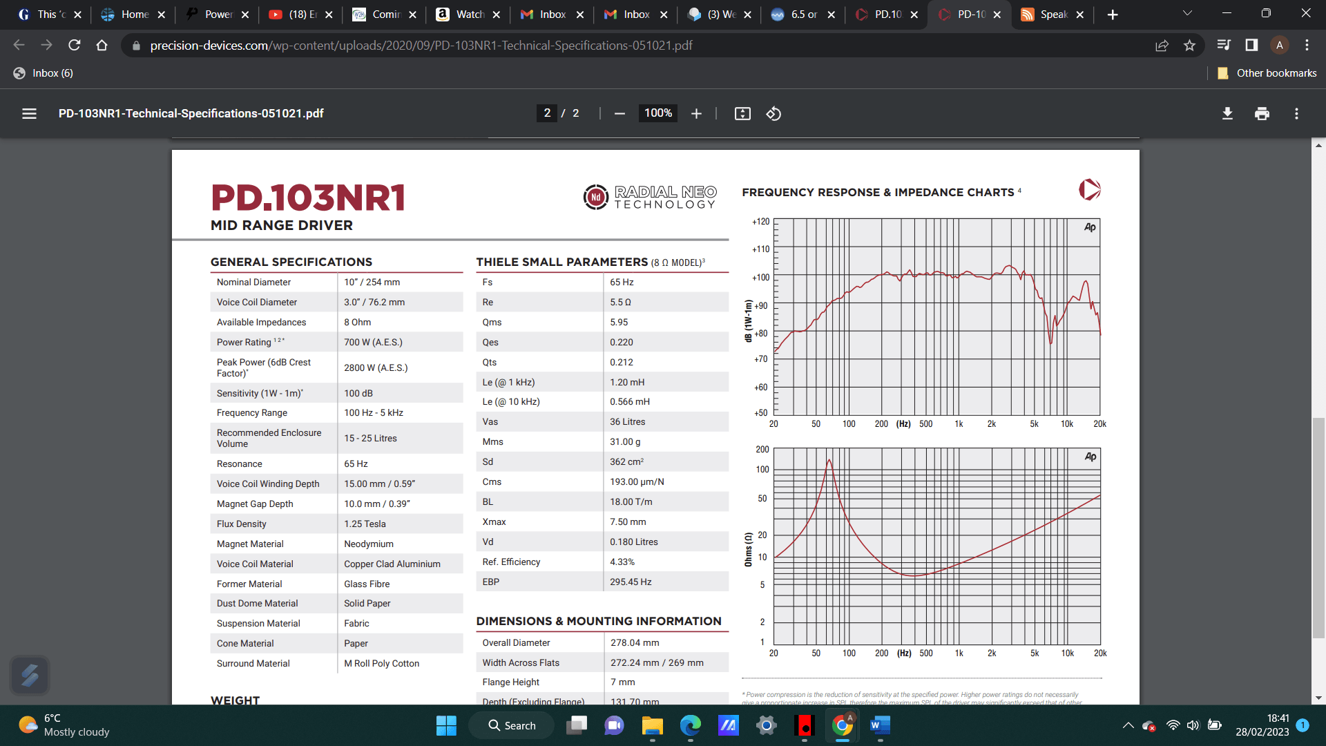

For a large midrange driver I would recommend the astonishing Precision Devices 10 inch https://www.precision-devices.com/products/all-products/pd-103nr1/ Just look at the spec:
Frequency response : 180 Hz to 2,400 Hz +/- 1.5 dB!
Great 31g Mms with Bl of 18 giving a super fast (for a 10 inch driver) ratio of 1.7
Unlimited power handling... 700 watts true AES with 2,800 watts AES peaks !!!
Low Qts, perfect in 15 litre sealed box.

nice driver indeed. I looked into PD.103NR1 and also 18Sound 10NDA610, another 10" high-sensitivity midrange, and didn't pull the trigger mostly concerned with potential beaming/dispersion mismatch and limited info I found online. Interestingly I have Beyma TPL-150H above, in an active system, currently crossing at 1.3kHz and 1.2 could be easily done. It's great to read you heard this PD 10" with TPL and found them to be a good match!

Also find the Precision Devices PD.103NR1 super interesting, and calculated around 1500 hz before beaming.
But also diden´t find much to read about it on the net, so alittle suspicious and around 265 $ but "big Thornann" sales them so maby okey.

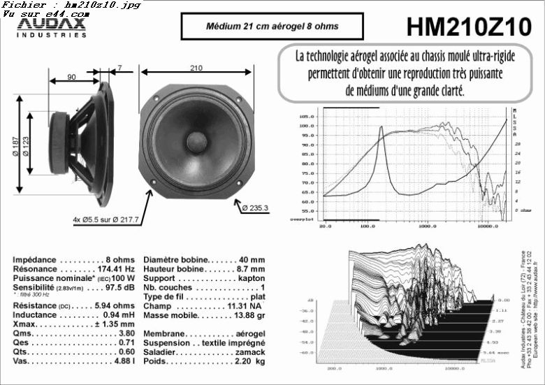

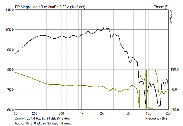

Today i use 2 x 8 inch Aerogel-cone Audax HM210Z10 99 dB in MTM, from 340 hz up to 1850 hz with success. ( but 97-98-ish is more correct for them)
