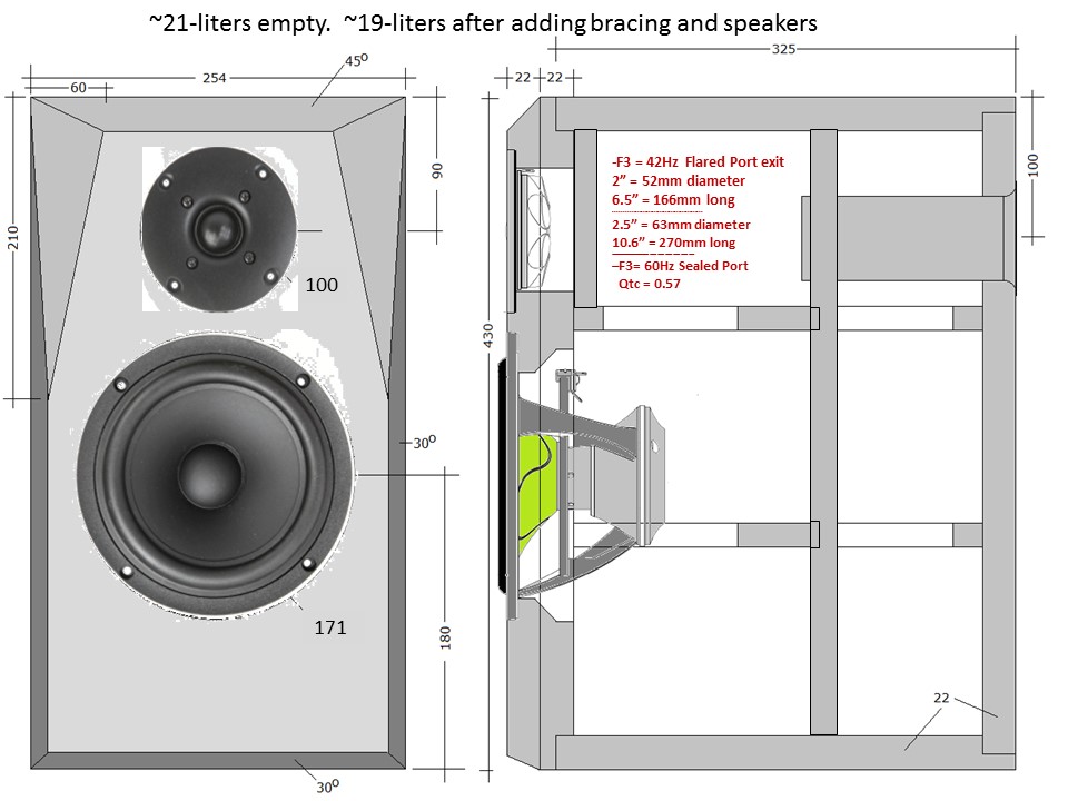

The 6.5" SB_Acoustics SB17NRXC35-8 is a popular paper cone midbass, and there are a few designs with the SB29RDC-4 1.1" dimple dome tweeter using a 1650-1800Hz crossover. Attached one example.
A 0.8cuft cabinet can reach -F3 ~ 42Hz. $130 - $150 for drivers and crossover parts. Selecting lower cost iron core woofer inductors and standard grade capacitors gets close to your budget. More info available on these drivers in different cabinet builds... like stepped baffle for time alignment and fewer parts LR2/LR2 crossover for lower total cost. Get latest prices at PartsExpress and Madisound(drivers)
