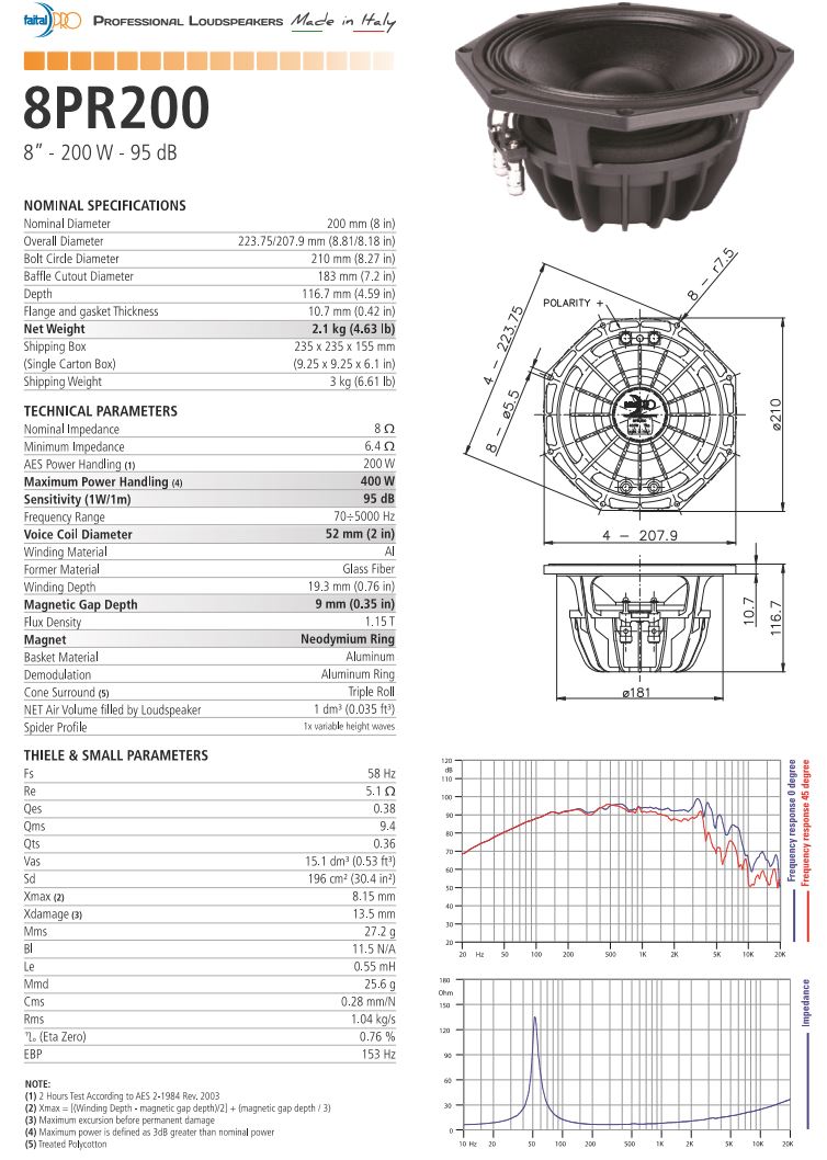

For a smooth transistion at 2kHz from the midrange to a 90H x 40V horn, the polar pattern of the midrange should approach 90-degrees at 2kHz. Naturally, this midrange should not show any signs of cone break-up around 2kHz. The goal to "get in clean" and "get out clean" around 2kHz often requires BW3/BW3 crossover circuits for both constant power and rapid attenuation of any midrange cone break-up, or non-linear "SPL blips" common in compression drivers. At first glance, the Faital 8PR200 looks decent, also B&C 8PE21

The next big challenge is narrowing down the 8" choices. I was happily limited for the 6.5"s.. The Faital looks a good start, 18sound have some interesting options too. And Beymas catalogue of 8"ers is verging on ridiculous... Any more pointers are appreciated :p
