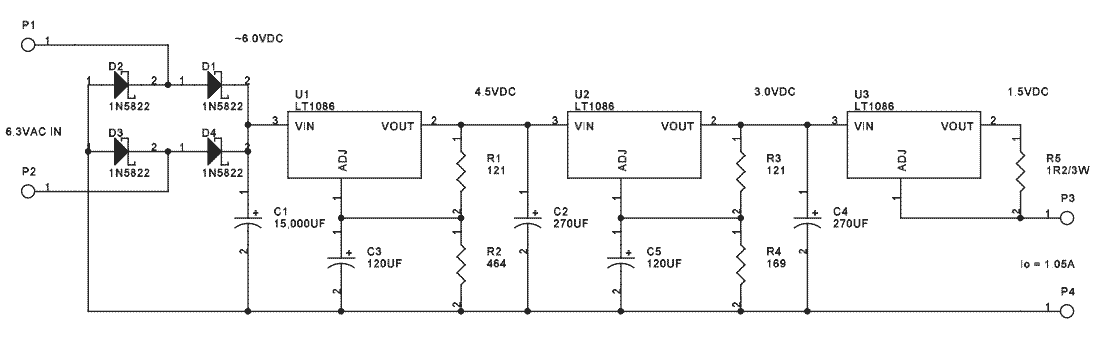

6.3v Heater Regulator Schematic
Anybody have a favorite. From what I can find in the Bottlehead archives, Ronan had incorporated both voltage and current regulation in a design, but the links have long ago ended and the schematics won't come up from the archives. I seem to be leaning toward the LT1084 but am certainly open to suggestions.
Thanks!
cantskienuf said:
Ronan Reg
Is this the one you were thinking of? It is called the Ronan Reg Classic.
dave
The Ronan reg would be overkill for a IDHT. Nothing wrong with overkill mind you...however Ronan reg seems more appropriate for a tube like the 26 or other DHT's.
For a 6,3v heater...for say a driver or preamp stage. I would just go with a LM317 or LT1086 current reg. Just set to the current to what the particular tube wants. Say 600mA for a 6N1P and you have a dead silent tube.
