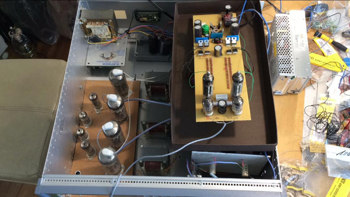

My brief experiments with a 100 KHz heater didn't get past the breadboard stage, so I can't really say how it would have turned out in real life. The tubes in question were 811A's which conveniently do have a 6.3 volt 4 amp heater. The "power supply" was a simple push pull amplifier using a toroids for the driver and output transformers. It was driven from a HP204D audio oscillator which goes up to 1.2 MHz. It kept blowing mosfets, so I gave up. This happened about 15 years ago and the mosfets and toroid cores were old surplus and probably just too slow. It worked OK at lower frequencies but I had to go up to the 100 KHz range to clean up the audible artifacts that could be heard as the frequency was changed.
I had planned to revisit this some day, but I wound up trading most of my old transmitter tubes for TV sweep tubes where I have concentrated my design efforts. I have a nice 30+ watt SE amp running on my workbench right now that uses a new topology to emulate triodes.

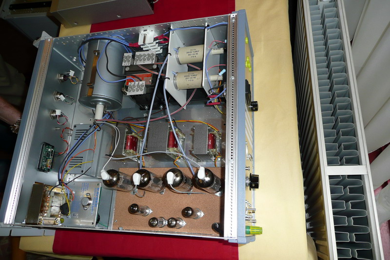

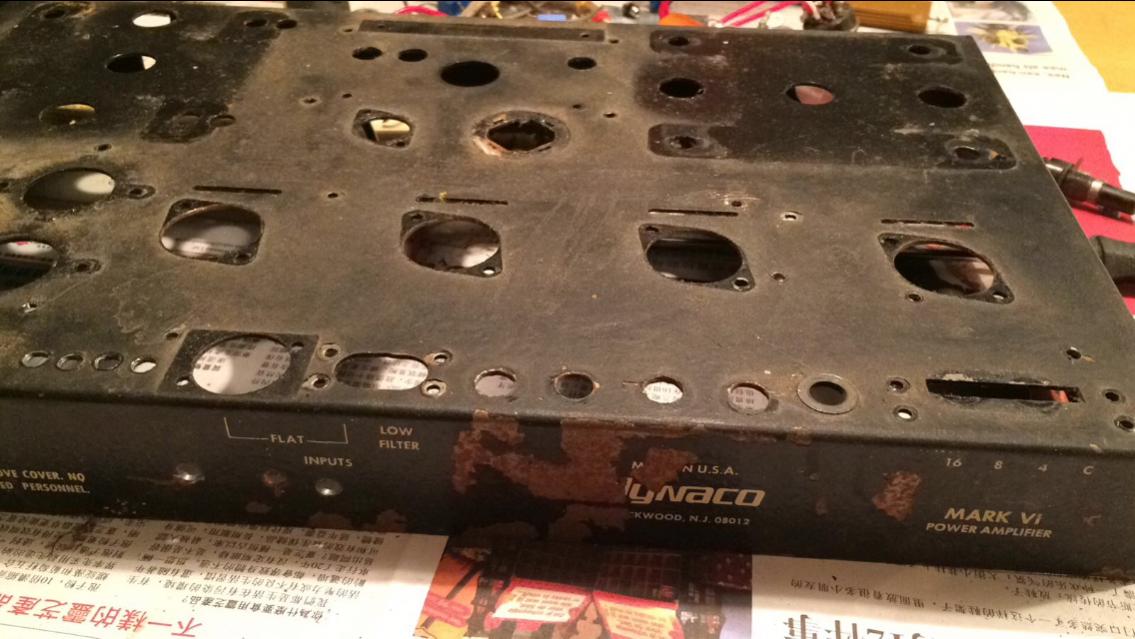

Screen driven a la David Berning (Patent 3,995,226) works really fine. Redesigned a Dynaco Mark VI set this way.
I also designed a HV amp for my ESL's using these tubes (Also G3 driven). I get about 5KV P/P on the output before clipping. This is sufficient enough to drive the Acoustats.
My goal is it to replace these amps with Zotl HV amps as these can be much smaller and more efficient.

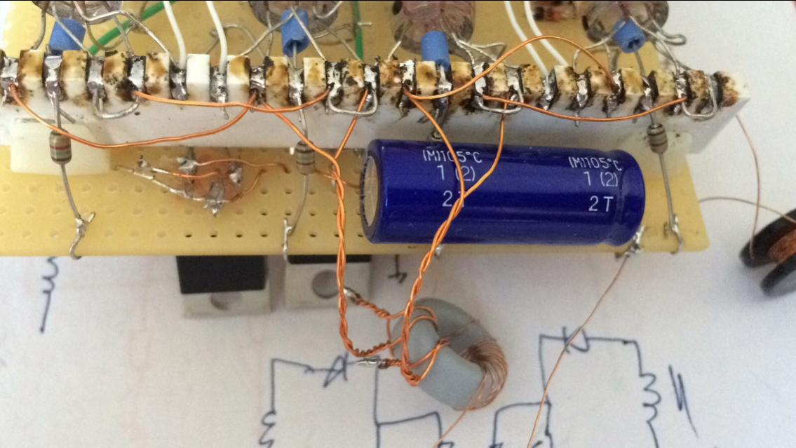

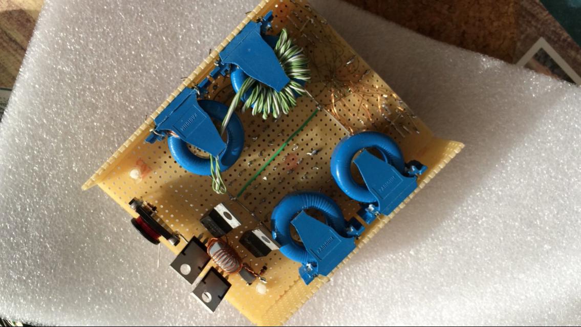

The heater wires shouldn't act as antennas as these have a very low resistance to ground plus they are "shielded" by the anode as well in most cases.
At 500Khz i do not have any issues at all (i use HUF75345P FET's).
