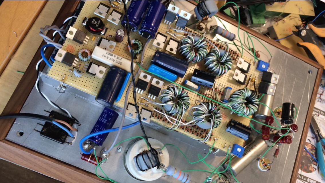

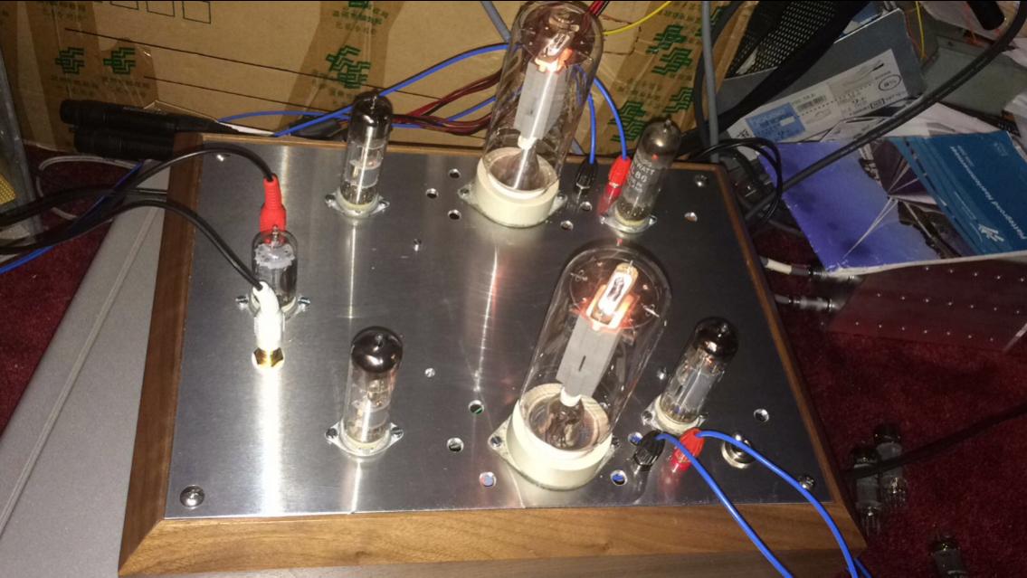

I use a 500kHz sine wave without disturbing harmonics and center tap transformer to eliminate noise.
Interesting would it be too much to ask if you'd mind sharing a schematic ?
So its a 500 khz sine wave generator of sorts ?
Looks kind of complex.

I based this on a David Berning Zotl as he described it in his Patent:
Tube amplifiers for high-end audio by The David Berning Company
I used his MicroZotl schematic as a starting point.
