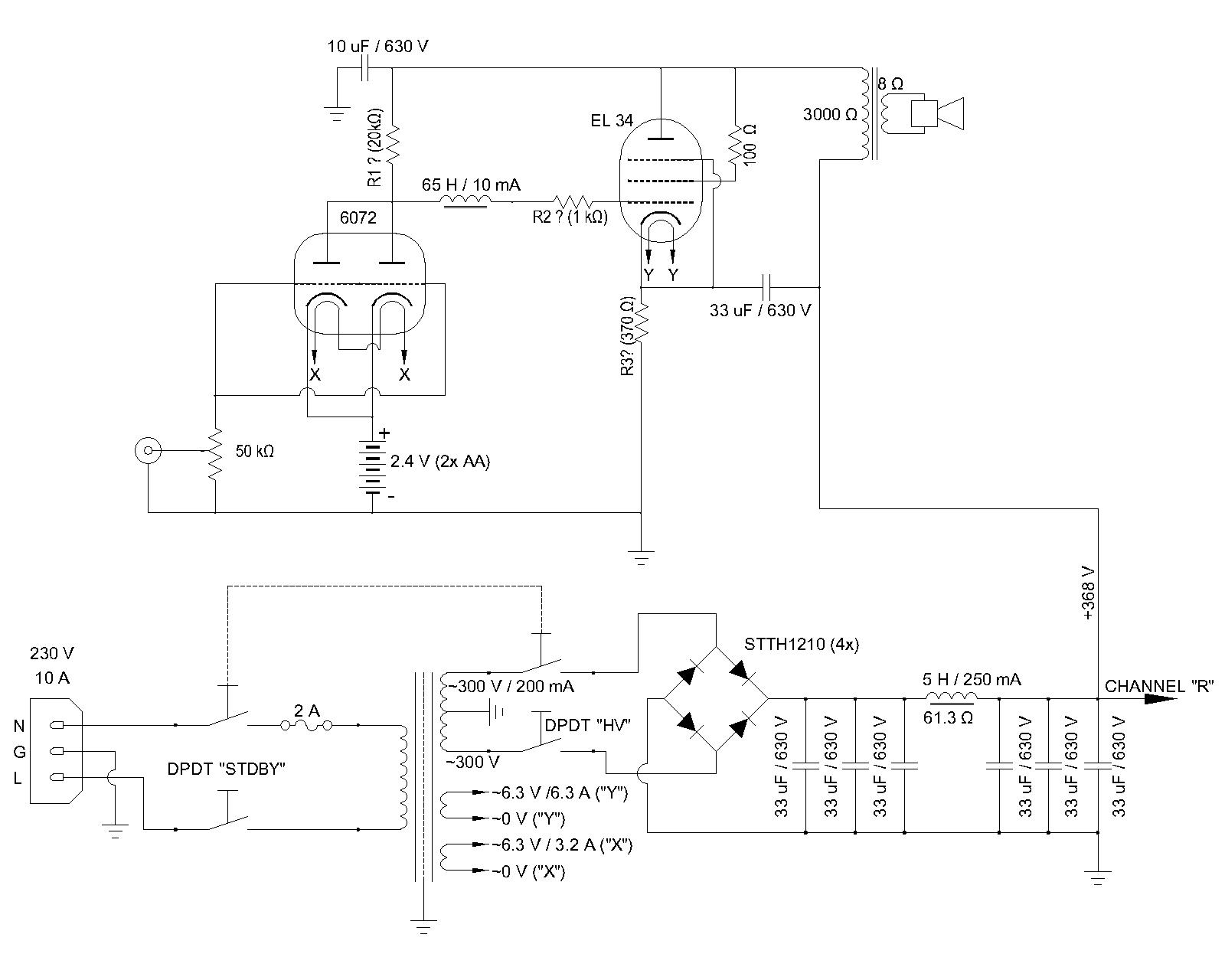

Hello, fellow DIYers,
I cobbled up the following (incomplete, needs some resistors values) schematic for paralleled 6072 / 12AY7, (with choke load) driving EL34 in triode mode with "ultrapath" & S/S PSU, with "ultra-fast" soft recovery STTH1210 diodes in FWBR (I know it's not often seen on this forums, just that I have some @ hand, as well as some some massive toroidal PT -225 W!, heavy choke & some nice locally made OPTs (C core, with 0.5 mm silver wire in the secondary)....I would like to use paralleled Solen "fast cap" polypropylene capacitors in the CLC filter. For the output stage operating point I used the recommended value from Amperex EL34 datasheet (OK, 368 V instead of 375, guess close enough to notice), should push about 5-5.5 W out (plenty for my case, with Lowther DX3 in Mauhorns "Signature I", >100 dB/W/m on the business end);
Couple of things still need advise:
- are these diodes (rated @ 1200 V / 12 A, t=48 ns) in need of bypassing with small capacitors (0.01 uF/1 kV) & resistors (470 kΩ / ½ W), like eg DRD PSUs?
- any recommendations re size of DC blocking capacitors? (don't think I am worried about reactances at anything lower than 50 Hz, though)
-any opinions on benefits with DC heating for both stages (space under 12"x 11" chassis is a bit tight, though)....
Any comments welcome!

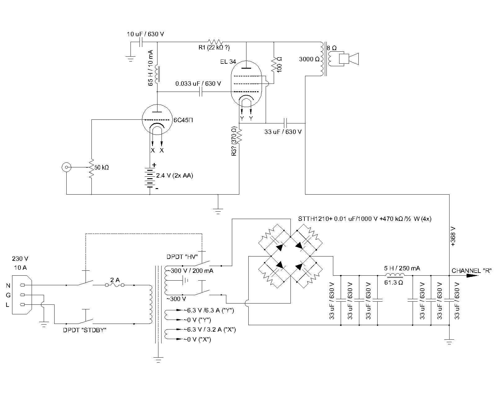

Hello, it's me again🙂:idea:
Another try, this time with 6S45Pi (again, choke loaded) driving EL34 triode connected , caps & resistors added parallel to rectifying diodes; same Ultra-path connection as before.
