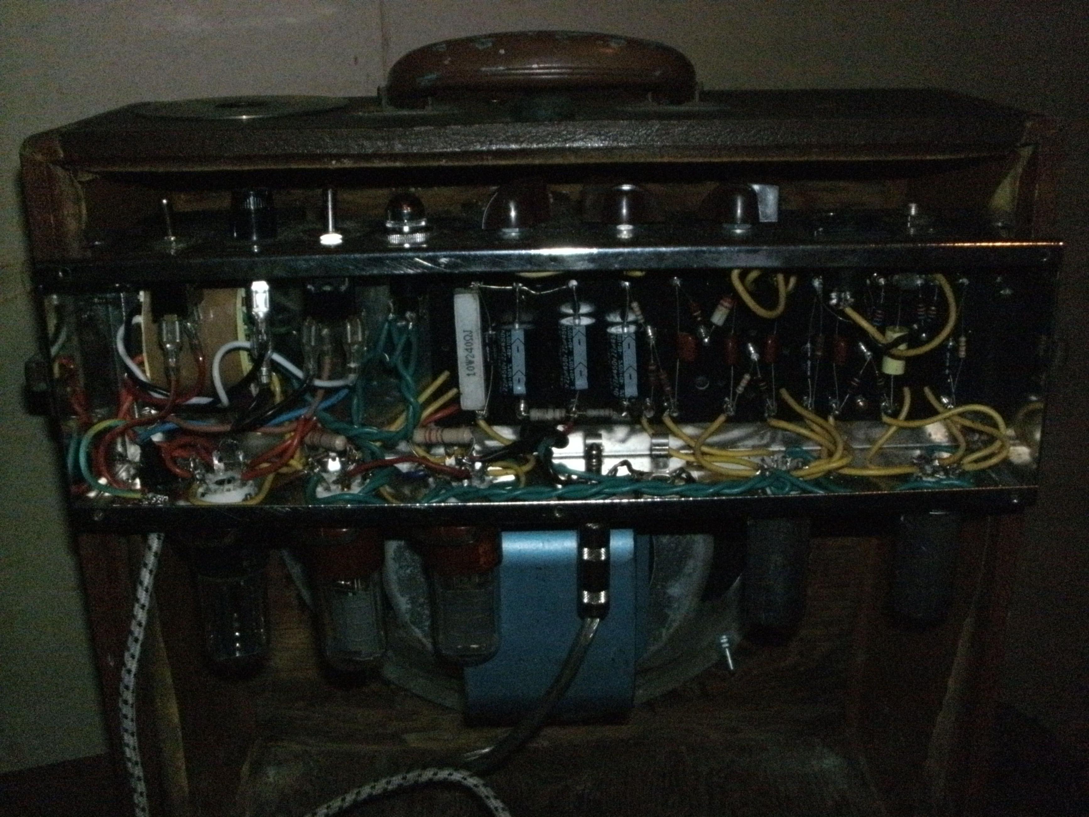

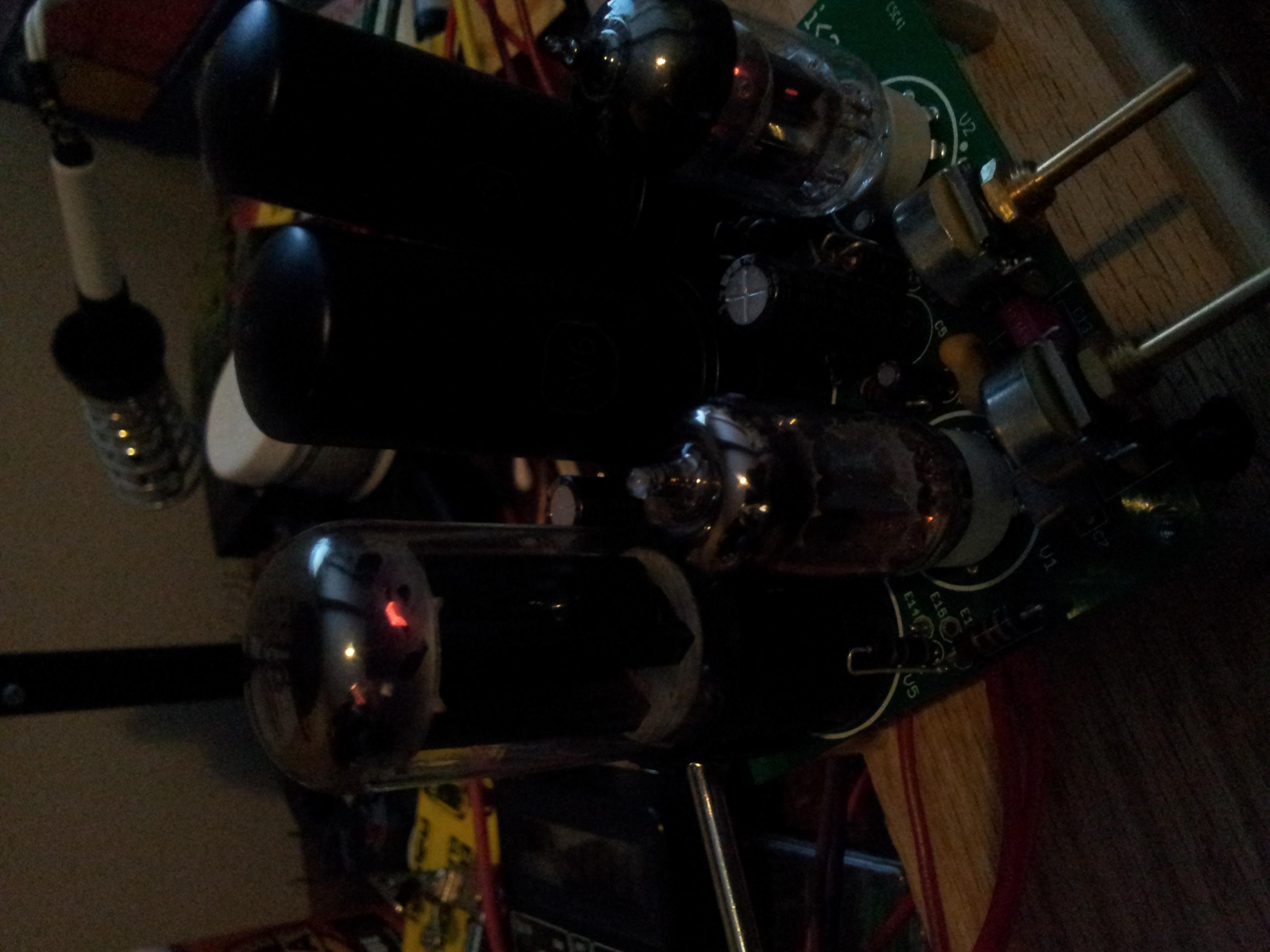

WOO HOO!!!! Got the rectifier to glow! I ended up shaving the polarizing keys off my tubes. Not sure if the board could have withstood all the mods. No worries, these tubes are now dedicated to r&d.
Output straight from the rectifier is 467VDC. Supply for the 6V6 tubes is 450VDC. Supply for the 12AX7s is 354VDC. These are too high,eh?

The plate voltages are high.
6V6 should see no more than 350 volts. 12AX7 should see no more than 330 volts.
Thank you Frank. So I think I fried my 6V6s, most likely earlier. No continuity on the heater pins. Now I have to do some calculating to get the R values right and obtain some tube fodder 😉 Thanks also for the pin orientation comment - that was my original mistake.
The RCA manual shows 350v for a 6V6. However, that is design specs RCA recommends. They are for polite designs like TVs and table radios. Leo Fender has been selling amps with 6V6 output stages running over 400 volts for over 50 years now, and they are not tube eaters.
Still 450v is too high.

My rectifier is putting out 476VDC. Consequently all the plate voltages are high.
I measured 3.95mA running thru the first resistor in the chain - the 4.7k 2w. I think that is low and indicates that no current is being drawn by the two dead 6v6. Their cathode bias R's have no voltage at the pin, indicating lack of current.
My question is: Once the 6v6 tubes are installed, will they cause the rectifier to sag, thus lowering the output voltage?
Absolutely. You should wait until you can install the replacement 6V6 tubes.
At that time, you can determine the actual B+ voltage under operating conditions.
If you find that it's still a bit too high, you can always add a power supply choke before the first filter capacitor.

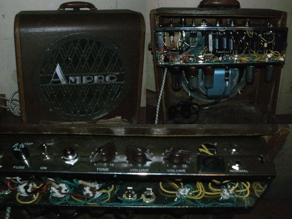

my layout is more traditional useing the stanard chassis but I hav saverlly moded the preamp feeding the output of channel one into the input of channel 2 to get more gain but swapping tube 1 for a 12ay7 as i play harmonica thru it, not guitar.

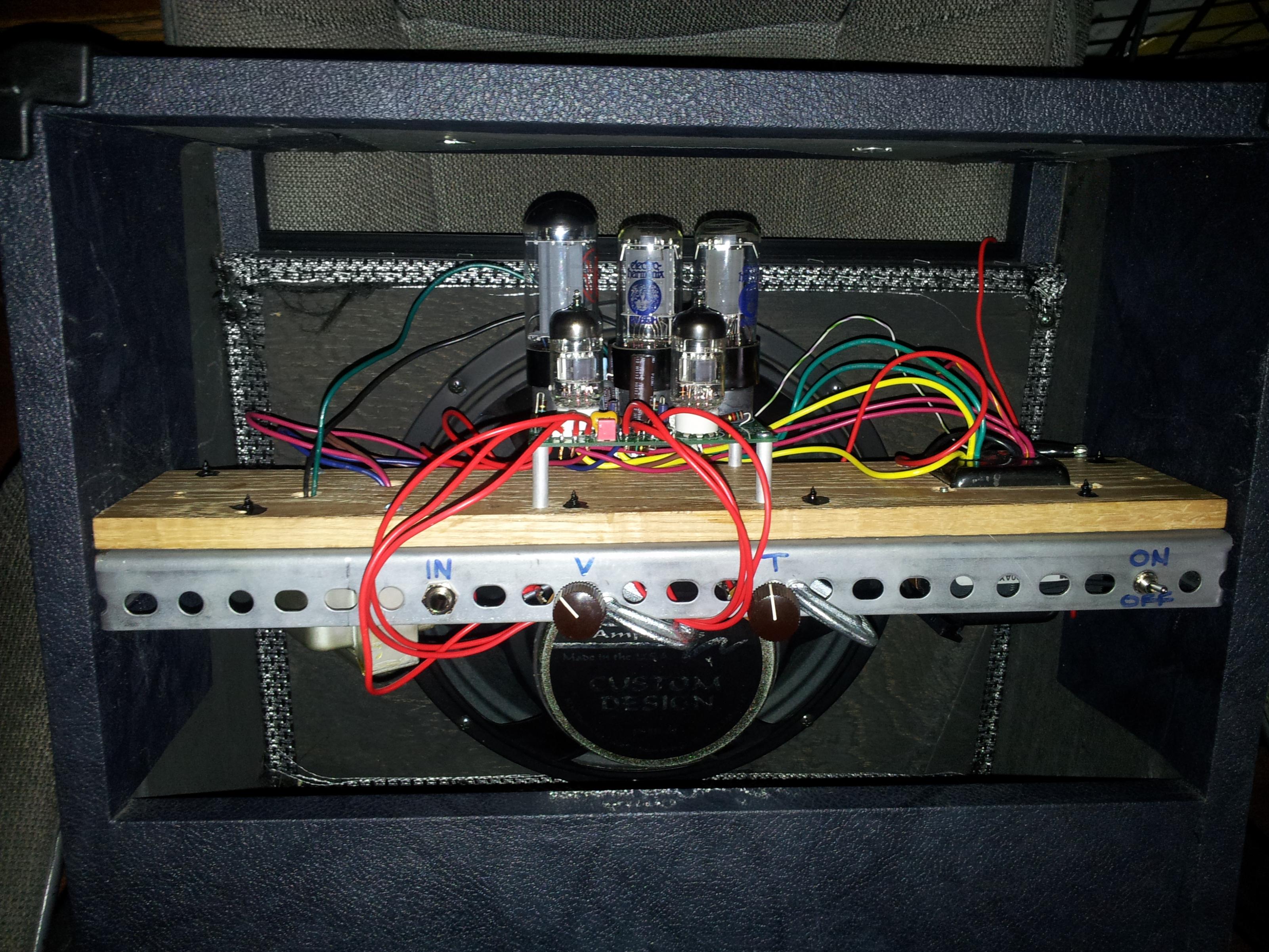

My pro guitarist friend played his fender strat immitation (still a real fender) on the amp today. He said the amp sounded very good even tho he had dead strings. Said he was surprised. Said to get new good quality pots. Said to bias the tubes. Said he felt a little voltage in the strings when I turned the tone low. Said the amp was quiet. It got about 3x-4x more hum when he plugged in he said the noise came from his guitar. Volume didn't bring on big loudness nor distortion and it basically didn't get that loud just low/moderate - slope was more horizontal. The volume control wasn't overly effective. Tone did some things but I was so excited that the dog worked right off the bat that I didn't make notes.
My own comments. If not for 2 minor mods at the outset, my board was good to go otherwise. I had to get creative mounting the pots. The replacements I got locally came without jam nuts - talk about unobtanium. So I c-clamped them on. So far I have not messed with any components but the pots. And that's about it. Frankenamp is born. I'm going to start trying to act like an EE and bias the tubes. Want to quiet the power as my scope shows it carries a little AC. Running cooler.
How do I make it so no voltage shows up on the strings!?!?!? Any comments appreciated.

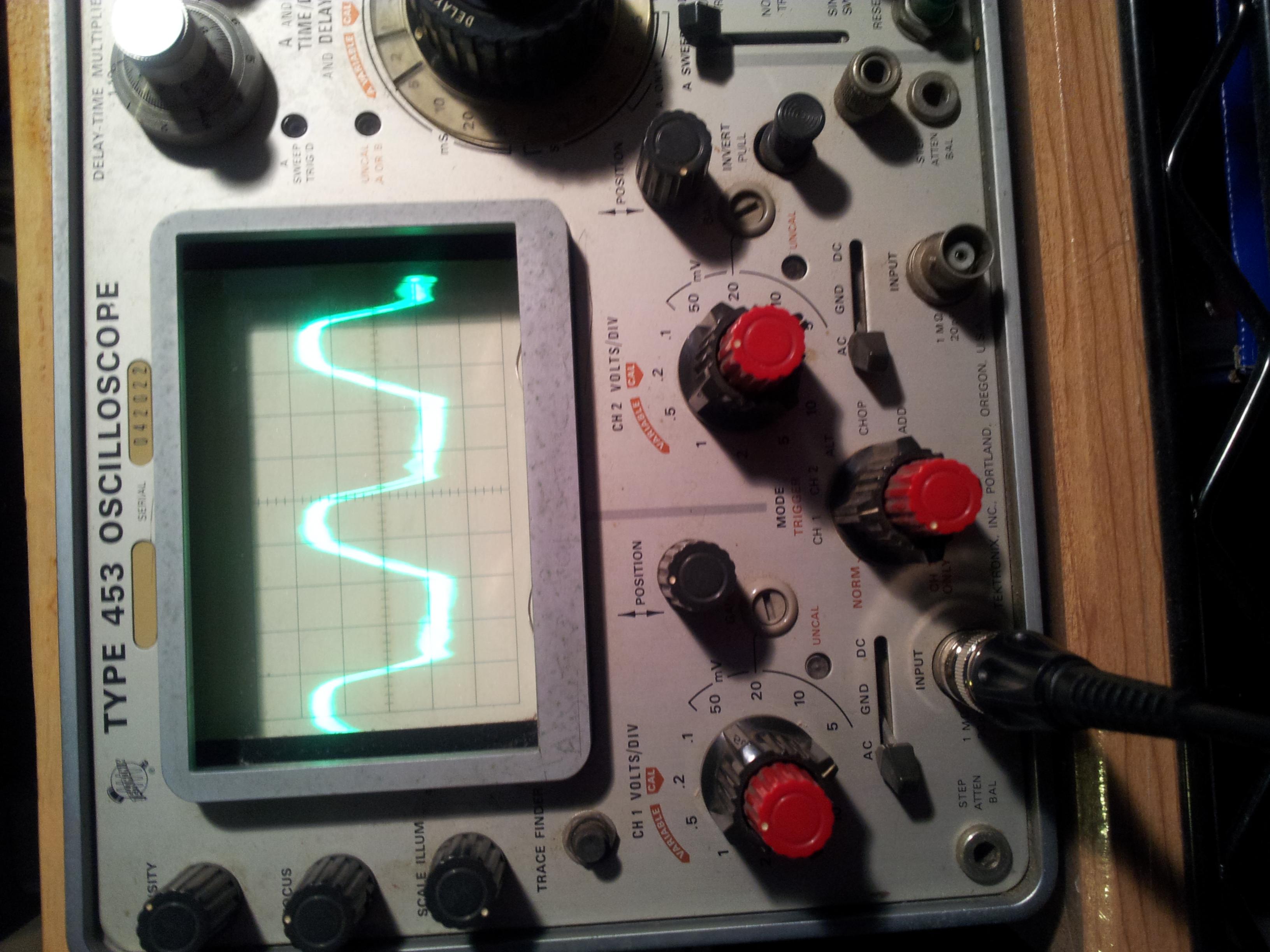

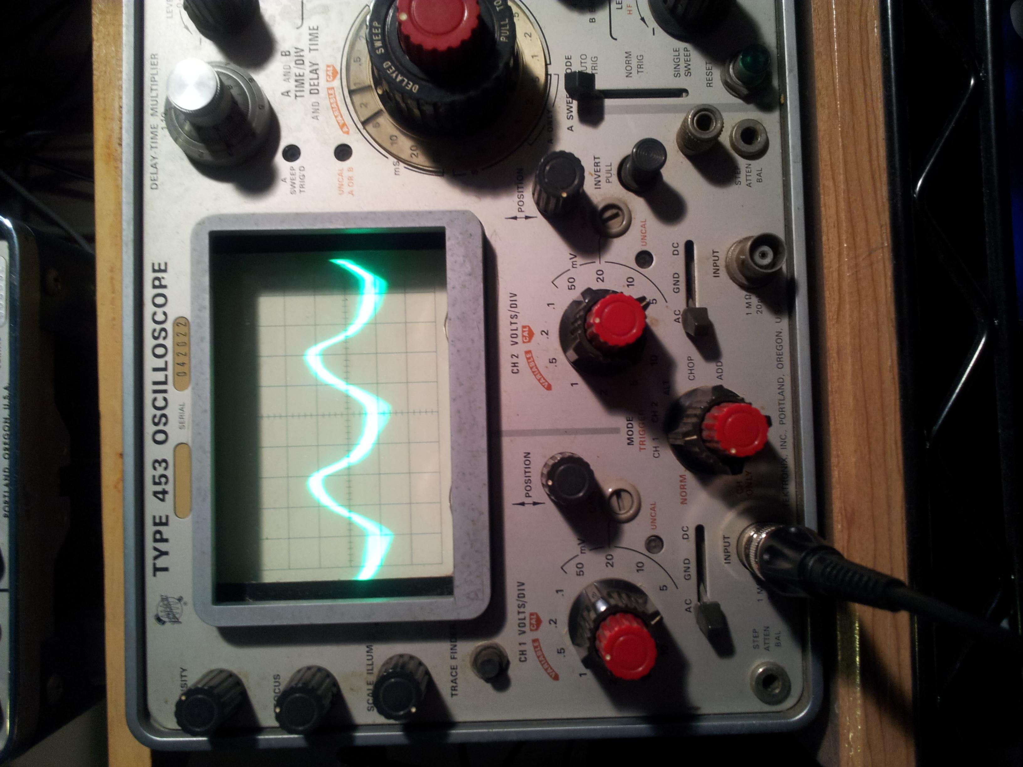

Of interest. Here is AC hum, no signal, at the second 12ax7. Right after the pots.
The first shows vol and tone at about 1-2 for both.
The second shows with vol and tone at about 7-8 for both.
That is probably why the volume response was so lackluster. This waveform is representative of the music that was flowing through it. Not good.
