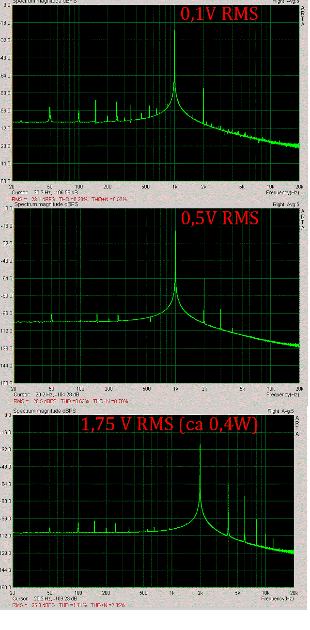

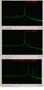

As I remember the difference to the original zca is:
The usable output power ends around 0,5 watts assuming the DMM shows the right RMS Voltage....
At very low power there is only 2. harmonic distortion, adding 3. harmonic at some higher power and up to 6. harmonic at 0.4 watts (~ 1,7 % THD), over 0.5 watts adding more and more highorder harmonics up to the highorder "fence" of negative feedback amps and pretty high distortion over ~ 0.8 watts.
The overall distortion is of course high but of no interest at the 2. and 3. harmonic.
Seems most of the time I listen with just ~ 0.05 to 0.2 watts. Just for interest I tried how loud 5 milliwatts are....I can hear a 0.05 watts 500hz sinus through my whole little house, through 2 rooms of the upper floor, stairs down sitting in the kitchen.
I don`t use any other amp anymore. Any consumer amp sounds like crap in comparison, but I have to add that I got a remarkable nice audiosource, with my older CD players etc it is not so obvious.
regards michael

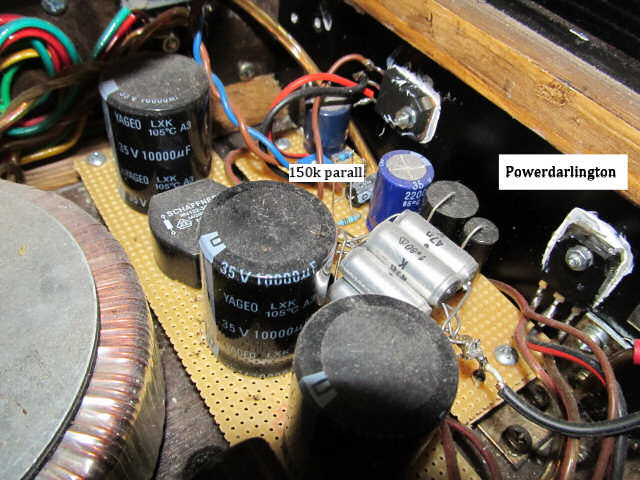

- 20 watt halogen bulbs instead the 15 R, means ~ half the resistance ~ 8 ohms
- 150k parallel to the 1 M, better sound for me.....lower impedance for the C
- Standard capacitance multiplier per side for power supply, I lost some Voltage with it, V is 19,5 V or so..
- Coupling C , 6 paralled Styrene, found nothing better (also tried teflon..)
regards michael
I just soldered a 150k over the 1M Resistor..., I´m really not shure but may be there`s more transparancy and less annoying highs with the Audyn caps. If I`m not wrong, it should no prob to reduce the 1M down to ~ 68k without any changes, the resulting highpass should be still under 20Hz. This would reduce the impedance at 1/15. Could be a good idea either to parallel the 33µ Cap with a Foil, cause I guess it`s more visible at a ground now. Maybe someone else likes to test if there is an improvement in sound and/or a less strong dependence in choosing caps. For the output cap I now ordered ELNA silmic II electros, should be the best choice (and cheaper...) next to BLACK GATES.
My ZCA, chaos again..., improvised red Audyn caps, the long silver ones are russian PIO, the darlingtons for the gyrator are on the main coolers. Getting tighter inside as I thought...

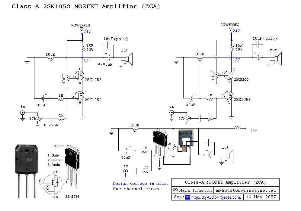

Taking another look at the circuit, the design parameters are quite wrong.
The 'mid point' output voltage should not be 12V. For maximum output into 8R it should be at 8 Volts. This would instantly quadruple the power output!
We'd get an earth shattering 4W rms. (with the original 15R resistor)
I've been thinking about this all afternoon and while yes in principle you could get 4w RMS with the 15 ohm resistor and the midpoint at 8 volts the MOSFET would have to switch hard on with only millivolts across the drain-source putting the transistor well outside the linear region THD would be huge surely. I'm not a qualified EE so feel free to correct me if I'm wrong.

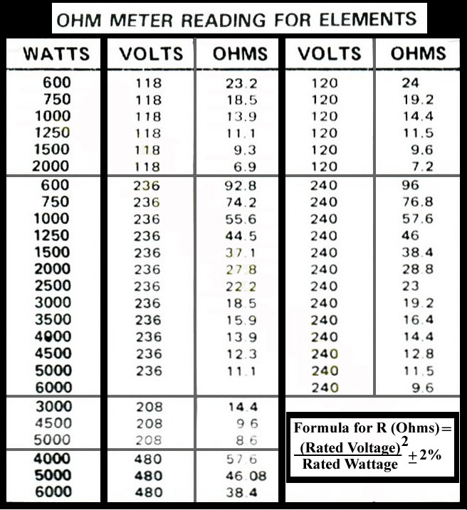

In my recent delve into resistor loaded output stages i found an excellent alternative to resistors or light bulbs, hot water heater elements. Attached is a sheet with info on resistance and type. These can take some serious power without worry, but the size can sometimes be a bother.
Jerluwoo, cool idea only thing is they can only dissipate their maximum rated power when submerged in a bath of water! If you applied full power without the water they would melt or even explode like a kettle with no water in it ( though in reality kettles have thermal cutouts to prevent this from happening ). Still I cannot conceive of an amplifier that would need to dissipate 1000 watts or more, so yeah the water heaters would make great resistors for <= 100 watts.
I work for a local retail\hobbist electronics store. We sell small spools of nichrome wire. Not sure but it may act like heater elements and may not need extra cooling.In my recent delve into resistor loaded output stages i found an excellent alternative to resistors or light bulbs, hot water heater elements. Attached is a sheet with info on resistance and type. These can take some serious power without worry, but the size can sometimes be a bother.

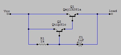

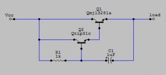

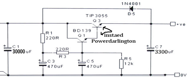

It's possible to emulate a choke easily. Adjusting the value of C1 to vary different size chokes.
I thought the -ve end of the cap went to ground or is that only for capacitance multipliers?
Is it called a gyrator by any chance?
A capacitance multiplier is entirely different. Some may call it a gyrator but it is considered an electronic choke. What the load see's mimics an inductor in that it has rising impedance with rising frequency which is controlled by the ratio of C1's impedance in relation to the value of R1.
Is there a formula for calculating the equivalent inductance that the circuit emulates?
Generally GNFB is the devil. A small amount of local NFB is good.Thanks Jerluwoo
Speaking of that, last night I read Nelson Pass' article on -ve feedback and how it introduces higher order harmonics that are uglier to listen to. It was like realizing that everything I was brought up to believe was a lie. 😱
Guess what all the SS amps of the 60s, 70s, 80s and possibly more have in truckloads?
I don't know off hand, but, the response curve is the inverse of the RC circuit formed by R1 and C1.

Now I am on "cascode fever" so I found the time and I did the mod. It worked. One channel only for now and 16 Ohm test speakers so I cannot comment on sound.
The Cascoded ZCA or maybe nZCA (nearly Zero Component Amp) 😀
The one I did is the mod on the right, with BJT. Feel free to send your remarks and advices.
The idea is to gain experience to upgrade the VFET amps also...
