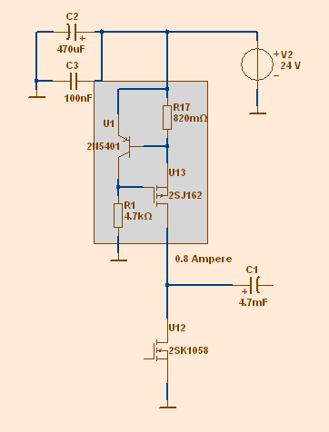

I have built this 5W Class A power amp designed by Mark Houston and feel happy with it's sounding performance. I am wondering now if I could use 2SK1058's complementary pair 2SJ162 to build one more power amp as the supplier sell them together. Please advice.

Thank you for all your inputs. What I mean is to replace the 2SK1058 by 2SJ162 and apply a -24v to it. Other parts and components remain unchanged. Would the circuit work properly with this change? Please advice.

No, it is made for both 2SK1058 and SJ201.
But sure is possible to make such circuit.
It will be kinda upside down because 2SJ162 is P-channel transistor.
Here is a version for 2SJ162.
Note that power supply V+ is connected to GROUND.
And so GROUND is the upper part.

A stereo system should be 2 such with 2SJ162
as 2SK1058 has a bit different caracteristic from 2SJ162.

Hi lineup
Thank you very much for the 2SJ162 schematic. It is clear and very helpful. I want to build two of this amps for my bi-amp speaker system one amp use 2SK1058 and the other amp use 2SJ162.

Hi Andrew.
I'm assuming we are still using the original circuit as in post 1.
To run 1.4A bias current, the 15R resistor will need to be changed to 8.6R.
The peak output current is now 8.6R plus 8R (assuming 8R speaker load), with 12 V peak. Ie 12 volts across 16.6R = 0.72A
Peak power is Isquared times load so = 4Watts, RMS power 2 W.
This is a somewhat inefficient circuit.
You are spot on with the suggestion of going push pull, you'd get the full 12 V peak across the 8R load (assuming no losses), ie. 1.5 A which would translate to 9W rms.

Taking another look at the circuit, the design parameters are quite wrong.
The 'mid point' output voltage should not be 12V. For maximum output into 8R it should be at 8 Volts. This would instantly quadruple the power output!
We'd get an earth shattering 4W rms. (with the original 15R resistor)

You are right. Should be lower than 12 Volt.Taking another look at the circuit, the design parameters are quite wrong.
The original that people build has got output at 12 Volt.
Which is not optimal.
