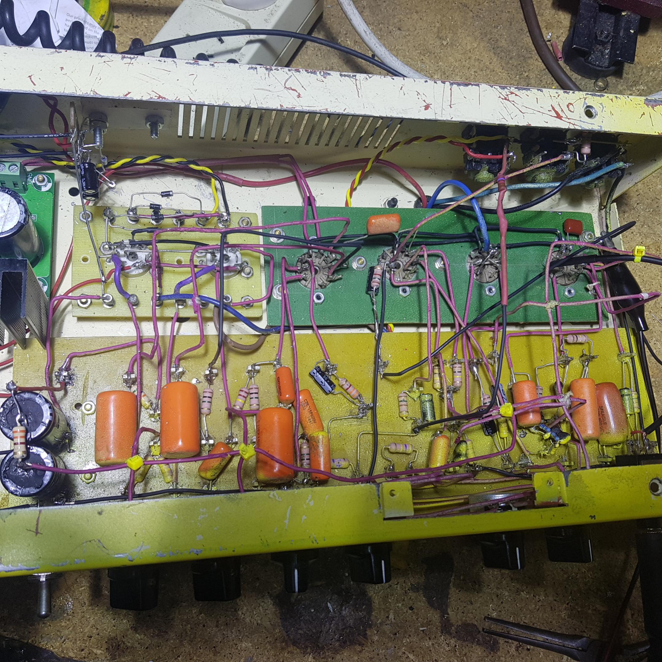

A long time ago I bought two SS amp heads with 12ax7 preamp, faulty (blown fuse ha ha ) Toroid transformer with lots of taps. 250 - 0. 12-0. 17-0-17. very low I for the 250V. .1amp. but should be enough.

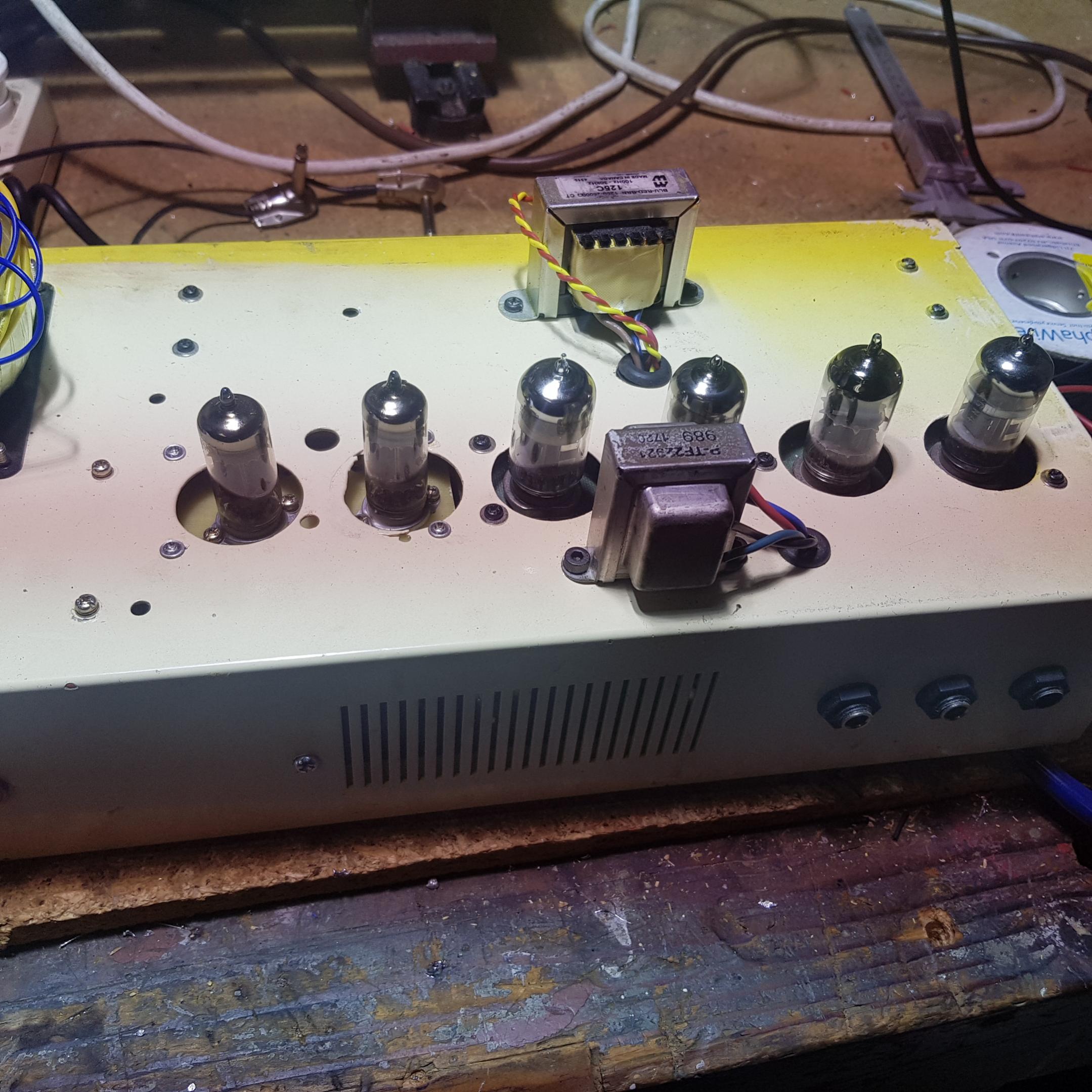

I made a AA1164 princeton reverb in the chassis using EL91 pentodes instead of 6V6. good for 5 watts? They are biased at _19v. EL91 valves are like tiny 7 pin 6V6. I have used 6SL7 triodes in low watt amps but didnt love the sound. The only changes to the schematic other than the voltages (250 not 400) are the dropper resistors (They are 4k7) and the output valves. so, the reverb is there and ok but not over whelming. Like wise the tremelo. There is something wrong tho. No clean tone. Some notes loud some not. No sustain, notes die out quick.

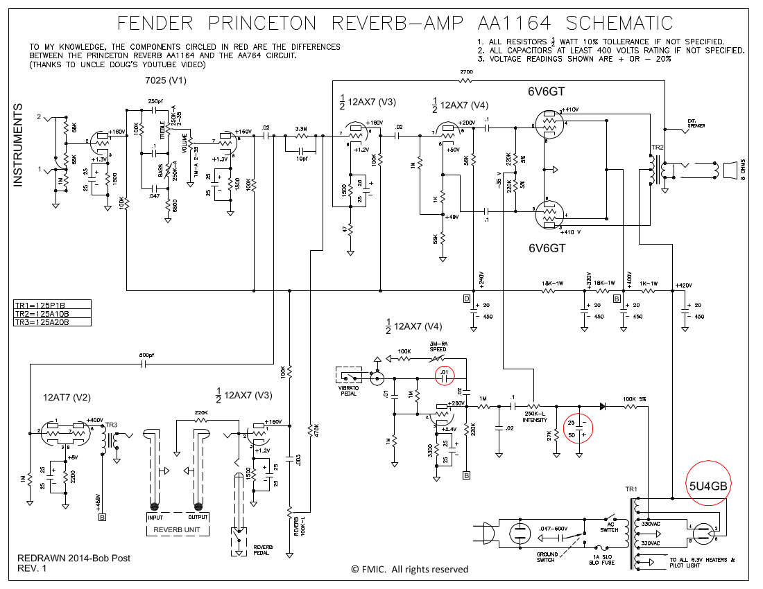

I suspect some oscillating.Grid stoppers the same as the original schematic.... Waiting for new probes today. Sorry no schematic, google princeton reverb AA1164 redrawn brings up a nice schematic love some ideas

Anyway, all good, just needed to reference the negative bias to the cathode. They are on separate winding's, never occurred to me until I hooked the scope probe between signal and cathode and it sounded good.

http://ampwares.com/schematics/princeton_rev_gz34_aa1164.pdf

SS amp heads with 12ax7 preamp, Toroid transformer with lots of taps. 250 - 0. 12-0. 17-0-17. very low I for the 250V. .1amp. but should be enough.
That HV winding was designed to feed a single 12AX7 preamp and in no way can handle a Tube power amp, period.
Wire must be hair thin, and in any case transformer window must be 90% or more filled with 17+17VAC wire for the SS power amp.
Your power amp may work (poorly), and in no time burn the 250V winding.

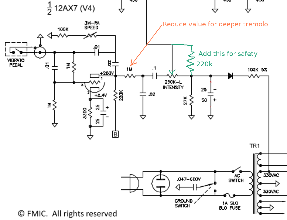

I have zero experience with tremolo, but I'm attaching a cleaned up and rotated right-side-up version of the schematic in PDF and PNG formats for easier reading, in the hope someone else may chime in.

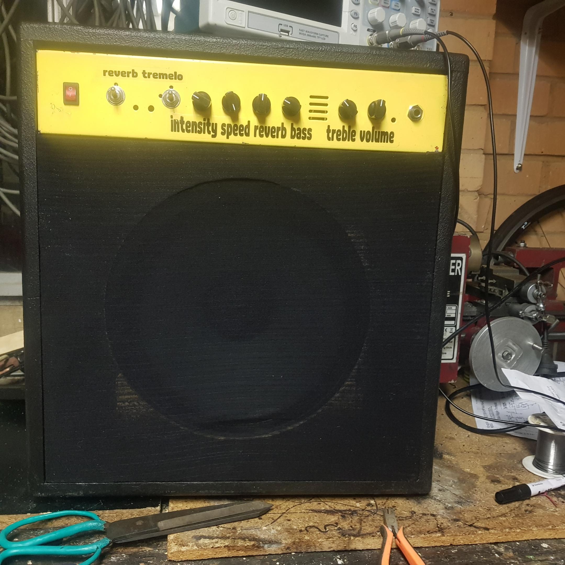

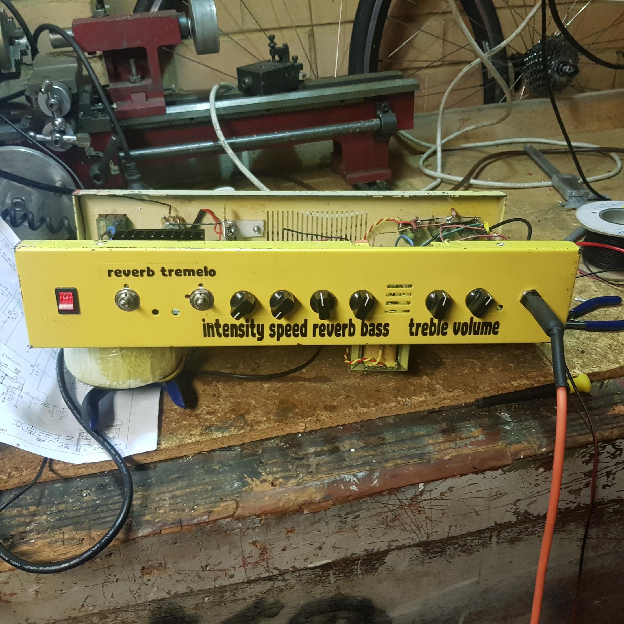

The finished item. The tremelo isn't as deep as I want.tried all suggested mods. Led bias. Lower buffer. Different bias Tec.
I get a lovely sine between pin 1 v4 and the output cathode but after that it's an ugly squiggle. Most likely my lack of scope skills/understanding.
The amplifier sounds good. Like a small PR. I like these EL91 pentodes. Also love the paint on tolex. This amp will honestly never leave the bedroom. Its cheap and looks great
Transformer still hasn't melted......🙂
Have you tried lowering the value of the 1 meg resistor (the one that feeds the tremolo signal to the 250k "intensity" pot)? That should strengthen the signal across the intensity pot, and allow you to dial in more "wobble" when you want to.
Speaking of the intensity pot: as the pot ages, one day the pot wiper will lose contact with the resistive track inside the pot. When that happens, the two 6V6s lose their negative grid bias, and both go to zero bias, i.e., maximum current. Minutes after that you have two red-plated and destroyed 6V6 valves, and perhaps ancillary damage to the output transformer, power transformer, and rectifier valve if you're using one.
I think there's a simple fix, shown in green. Add the fixed resistor so that when the pot fails, the 6V6 control grids are still biased negative.

Gnobuddy, thanks. Tried the 1meg. Its 270k at present. Its good "down on the bayou" but not "how soon is now" 🙂
Then it's time to try 120k instead. 🙂
When I have no way to calculate the proper value of a component, I often just repeatedly halve or double the value as appropriate, until it works the way I want it to. In the E12 resistor series, 120k is the closest to half of 270 k. 🙂

That might be wise. If you take it too far, the output valves will go all the way into cut-off on negative half-cycles of the tremolo signal, and then you will hear thumping sounds in the speaker.
