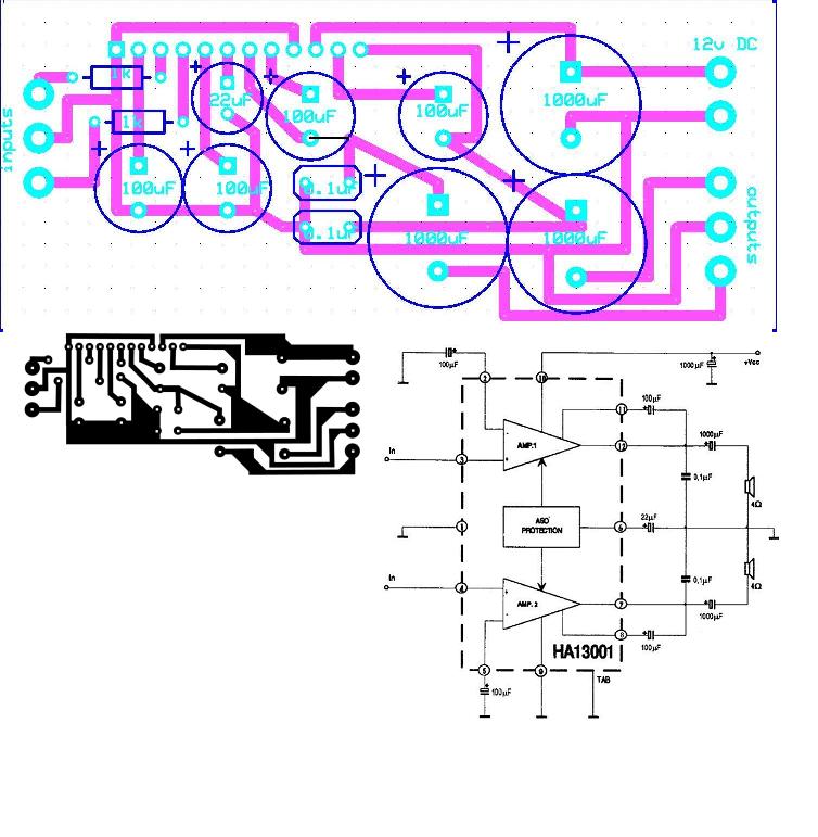

Yesterday i was looking through my parts bin looking for something to build a low power stereo amp for my MP3 player to run in my car , like an Ipod dock type thing ....
Anyways I found a HA13001 chip in my parts bin , it is appearantly a 2 x 5w into 4 ohms amp chip that runs off of 12v DC which is perfect for my car .....
So I did up a home made PCB from the datasheet curcuit and hooked it up to my MP3 player and a set of home theater speakers and a 12v dc PSU and it sounds pretty good , way better than the LM386 amps i have built ......
I don"t think they make them anymore but you can find them on the net , if you can find one I can supply you with a simple PCB design if you want to etch a pcb at home ......
