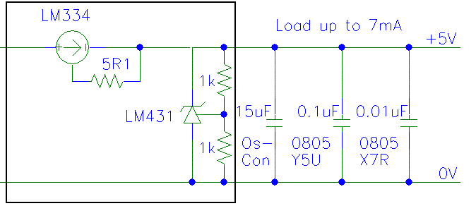

Re: Re: +5v regulator
Kuei Yang Wang said:
Koinichiwa,
I found the LT/LM1085-5 (the fixed Voltage Version of the 1085) to be NO improvement on normal 3-pin regs. There is a simple reason too. The build-in resistor divider has not got the option to bypass the ADJ-2-GND resistor, which in such regulators actually drastically lowers noise and output impedance.
Now you could of course use the Adjustable version of the 1085 and incude the two needed resistors and the bypass cap, in which case it would actually be better than any 7805 I have come across, but ONLY then.
My personal preference for a "precision" 3-Terminal regulator circuit is attached. This is suited of course only to relatively low currents, with a suitable CCS (selected J-Fet) it can be used up to past the 50mA output current region.
If you don't mind exceeding the LM334 rated max current (I have done it a few times with no ill effects) you can have more output current even using the LM334, simply stay well within the dissipation rating of the LM334.
The actual regulator is the bit in the Box, the three decoupling Cap's are my recommended local decoupling scheme regardless of regulator used (7805 or the like do need a larger value Os-Con, more like 100uF++ though).
The actual advantage over the usual 3-pin types is usually realised in noise AND much more imporatntly in circuit if the regulators are local to a given chip the Impedance, which remains constant and low up to around 100KHz.
The Os-Con extends this wide range of low PSU impedance to around 500...600KHz. The other SMD caps IF APPLIED WITH MINIMAL LOOP AREAS keep the impedance low past the 30MHz mark...
I find that wiring up this circuit using the two TO-92 cases superglued together and using 1206 SMD resistors makes for a VERY compact circuit that can be fitted instead of most 3-Pin regulators and is not THAT difficult to make.
I also always have ferrite beads on both input to and output from the CCS, this helps to kill feedthrough at higher frequencies. Adding a series inductor somewhere on the board before the trace joins into the main PSU bus is also a good idea. Often the Designer has already thoughtfully (NOT) provided suitable Wirebridges that can be replaced by radial or axial inductors. If not you can often fit an SMD inductor into a PCB Trace.
Of course, this circuit can be bettered but with it's 5-part simplicity, constant current draw and short AC loops it offers much better insulation of PSU lines against each other and noise and that with components that are cheap and easily obtained. It is not a universal Reg but simple and often applicable in modding existing gear.
Anyway, my experiences and thoughs only.
Sayonara

Re: regarding the LM431 regulator
Koinichiwa,
yves said:
Are there stability problems with increasing the
15u oscon value to 100u or 470u?
What about a large (say, 47u) cap at the 1k at
the adj node of the 431?
Yes, both can be done. BTW, the 47uF Cap needs to go from Adj to positive side of the reg, not the negative side as it would be for 3-Pin adjustable.
The reason for the specified Os-Con and the omiting the bypass is to match the various (parasitic) resistances to avoid nasty resonances. All Cap's have broadly the same ESR and the Reg has a similar internal impedance.
