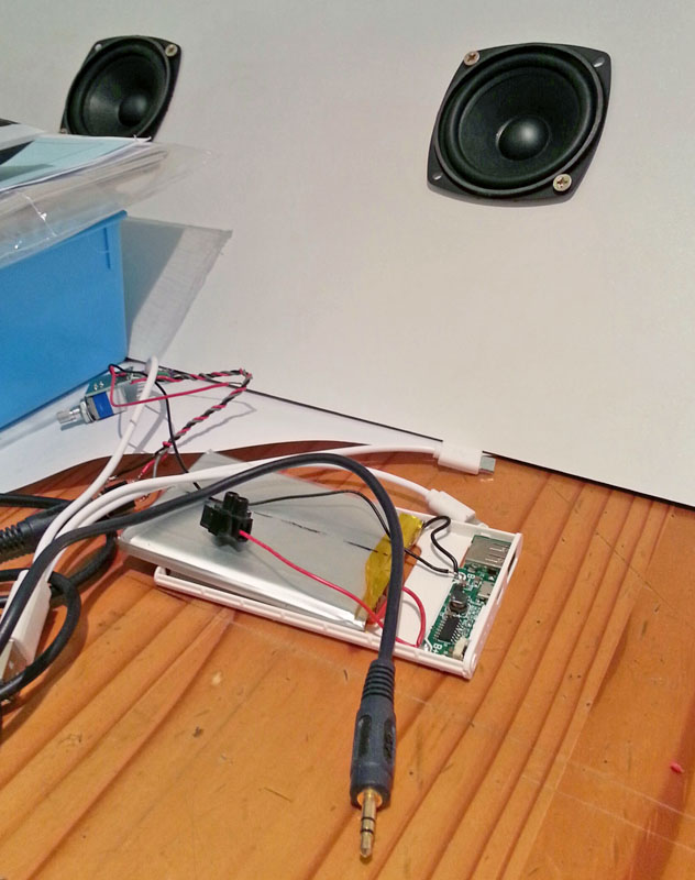

Parts arrived ages ago and went straight into the cupboard. Finally got a chance to take it out and wire everything up (See attached).
I mounted the speakers in an old board just to separate front and back pressure waves and get an idea of quality... These little speakers output A LOT OF SOUND!
Played with the equalizer on my phone and I can actually get a lot of bass out of this make-shift setup... can't wait to hear it in a Cab!

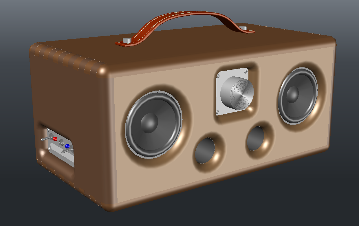

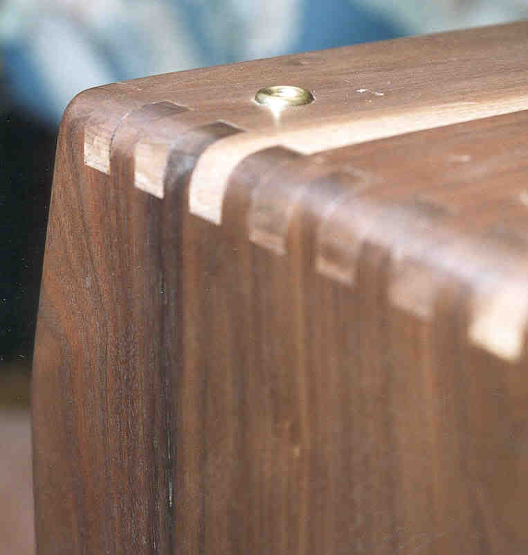

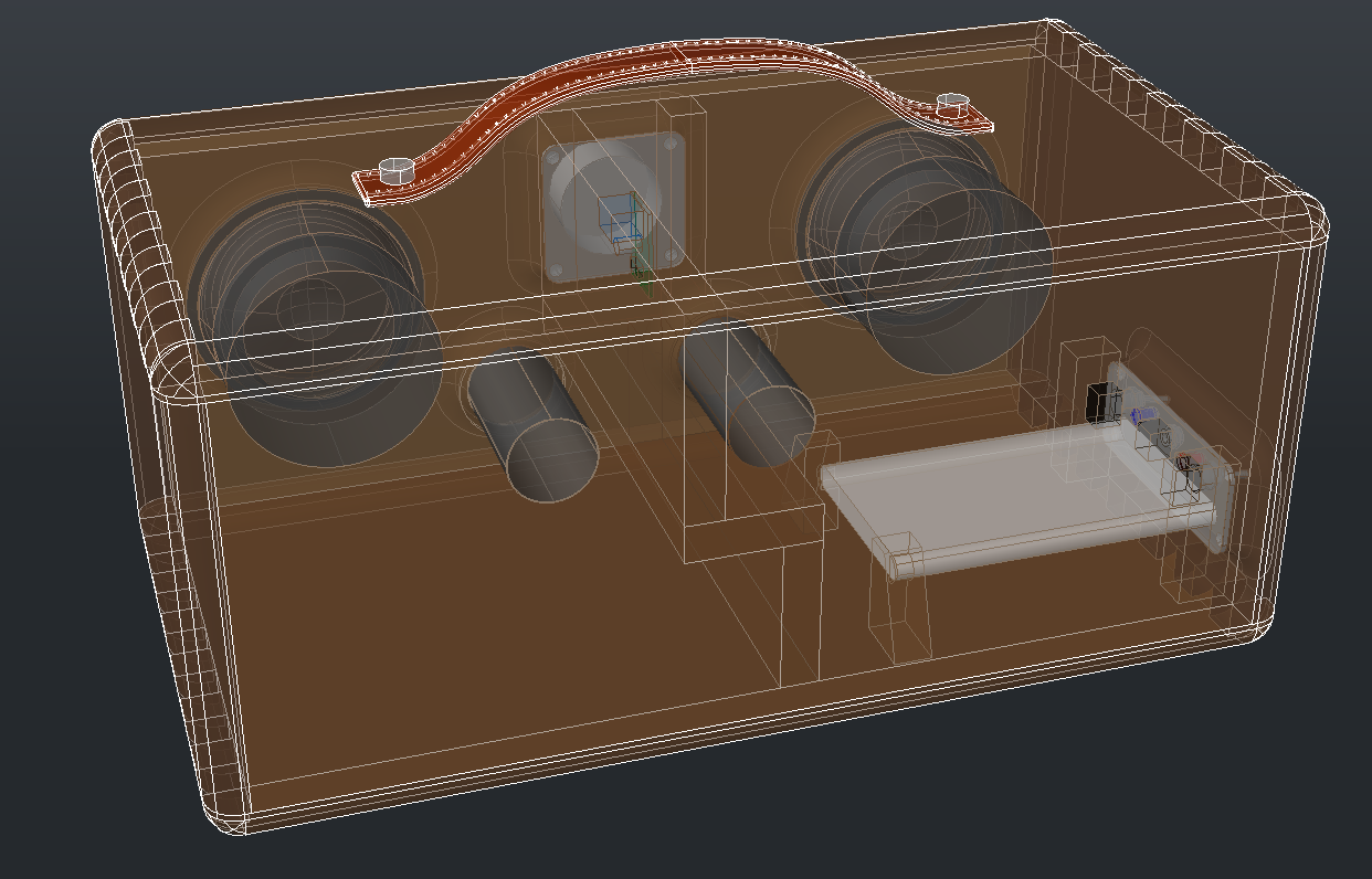

I finished the cutting list for the cab. I decided to make it a bit more compact than the original design, but the cabs are still tuned around 100Hz so there should be enough bass.
So I ended up with 2 x 3L cabs (probaly more like 2.7L each with all the bits and bobs) and the cabs are sealed off from one another.
Amp can be replaced by removing the 4 screws on the front plate. Battery and stuff can be serviced in the same way on the side. The drivers are a bit harder to service / replace since I fit them before glueing the back panel. If they ever die then I'll have to destroy the back panel to get to them (lets hope that never happens).
There is a power switch with red LED to cut main power from the battery. There is another switch with a blue LED to cut the power to the bluetooth module when it is not in use (to save juice).
Let me know what you guys think and/or if I'm overlooking something before I start the build...?

Looks great! I don't have the facilities to do any woodworking to that level but I wish I did..
How do you plan to properly charge the 3.7 volt battery? Bank batteries are easy but finding high capacity units that won't shut down during low current draw (Low Volume) is an issue for me..

I'm connecting strainght across the battery terminals for power (see pic). If I use the usb port to power the amp I get a pretty substatial hum as a back track...
