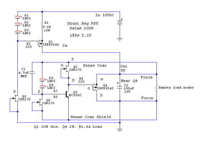

I'm using LT1085 to provide the +5V rail to my TacT preamp. The noise output on the unloaded +5V rail is less than 200uV peak-peak when measured on my digital scope. When it is loaded, the noise is just slightly above 2mV.
I did measure the +5V rail across the ASRC chip on the digital input board, and there is a 7.5mV ripple with 750Hz riding on it. So it looks like I need bigger and better caps to replace the decoupling caps that are already on the main board.

Thanks for all the advice. I do have a digital scope (Bitscope). The 200uV noise measurement from my linear PS is p-p and without any load.
I'm thinking on the same line as you guys have suggested: either there is not enough capacitance distributed amongst load or the output impedance of my supply is not low enough.
Do you guys feel that 2mV of ripple/noise measured on my supply side (when loaded) is an acceptable figure?
Would LT1083 having higher current capability (7.5A) vs LT1085 (3A) be a better regulator with lower impedance?
PS - it is not possible to put an electrolytic cap across the main board's existing 470uF caps, as they are soldered with virtually no gap b/w the cap and the board and this prevents one from sticking another cap across its pins.

Extremely long post - Bypassing, etc - simulations
This will be an extremely long post. Sorry.
I don't know if it will be helpful or not. But I wanted to try comparing different types of bypassing and filtering, with simulations. The raw results are posted below.
Please let me know if there are other configurations I should try.
Tom Gootee
------- Simulation and results, verbal log:
OK. I did some quick-n-dirty modeling and simulations of bypassing and filtering tactics for a digital subsystem.
SETUP:
I used part of the top half of the dual 22V power supply schematic at Spice Component and Circuit Modeling and Simulation , which includes models for mains wiring, a toroidal transformer, some bits of conductors, and the diodes, capacitors, and resistors shown, with an LT-1084 voltage regulator configured as shown.
BUT, I eliminated the inrush-limiter portion. And I changed the AC input voltage to 50V peak and changed R3 to 290 Ohms, to adjust the regulator to have about a 5V output with about a 1 amp load.
I retained the 4 x 25 nH and 4 x .001 Ohm (the .004 Ohms is embedded in the inductors' models), in both the +5V conductor and in all of the ground return conductors, to simulate four inches of some typical conductor for each.
I didn't have any digital IC models that included the power pins and their behavior. So I just replaced the load resistor with a pulsed current source, sucking pulses from +5v and sending them to gnd, to simulate a sort-of worst-case current demand from a digital subsystem board.
I had no idea what amplitudes to use, so I set the "digital load" current source to switch between 0.5 Amp and 0.75 Amp, with 40 nanosecond rise and fall times to make it difficult, and a 0.65 millisecond "on" time with a 1.3 ms period (something close to 750 Hz, just for fun, since that frequency was mentioned as a problem).
The Max Timestep setting in LTspice (free from linear.com!) was set to .00001 Second. More zeros would give a little more accurate results. But I did spot check some of the runs with a couple more zeros and there wasn't too much difference, except that it ran much more slowly.

I'm not sure if the 2mV ripple/noise I see is really noise or impedance problem of my PSU. Would you recommend I go with LT1083 instead of LT1085? Would it lower the impedance of my supply?
My recommendation would be the Salas v1.0 shunt regulator.

Hi Tom,
Thanks for your lengthly reply. You have given me some ideas.
I went on to search for LT1084 in the forums and found some other threads on lowering noise. Now I'm off the tangent and I want try using a precision voltage reference in place of resistor R2 in my LT1085 5V regulator circuit.
I noticed that people have been using LM329. And for 5V output, 2 green LEDs. I actually want to try 2 green LEDs as voltage reference in place for R2. However, I'm worried that the 2 LEDs may not give me the 3.9V reference voltage as desired. It maybe 4V or more, which is too much.
Is there any other voltage reference I can use here in place of R2? What about adjustable voltage reference?

Hi Salas,
Off topic:
It's good to see you in here! I recall my last conversation with you was some 1-2 yrs ago with modding the Benchmark DAC1 using Auricap. Are you still using the Benchmark?
On topic:
I've heard so many good things about your shunt regulator. However, heat and space are my constraints. Currently, my LT1085 is already dissipating 5W of heat. I don't want to have more heat than what I already have. Any other suggestion?
Yes I still have it, but I am listening to vinyl only almost nowadays. I will take it to a friend's soon to compare a couple of DIY DACs with I to V, transformer and valve output, and see if I will like them better. One of those DACs has my regs all over, LV & HV.
If you could use a nice sink and burn 12W heat, that one I posted, people that used it on Buffalo in lower current, still with remote sensing, say it ousts LT and the like in a big way subjectively, even some other special discrete regs. That's the feedback I got, but I can't attest to that personally since I haven't used it on such. My suggestion would be to use a dedicated box that has a back sink so to locate it far enough and not revolve around commercial series reg chips. 4 wire Kelvin connection will make it feel in touch with its load though.
