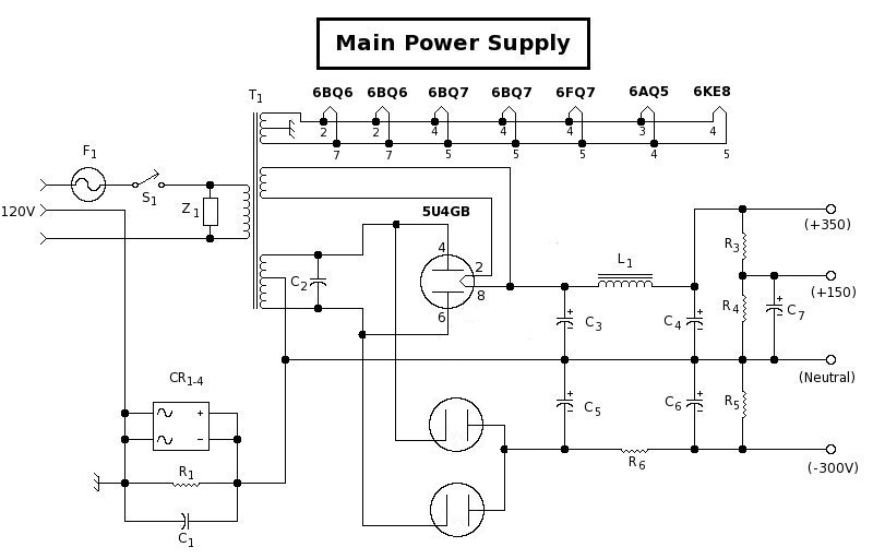

Does someone have a simple schematic including the heater set-up....like, do I need twin heater windings or can I use one winding for both, why or why not???
It would look something like this (attached)
You would power up the heaters of the singleton diodes (TV damper diodes are used a lot for this purpose, and 6DE4s were used quite often as their specs are close to that of the 5U4GB) from a separate heater winding on the main PTX, or better still from their own heater PTX. As always, you need to pay attention to the Vhk ratings of the dampers, and also make sure that you're not exceeding their Isurge ratings in operation. The 6DE4 also had an advantage in that its forward drop is much lower than that of the 5U4GB.
This was done a lot in the making of ham rigs since the FWB configuration also makes for the so-called "economy" PS where the center tap provided a positive rail about half that of the main rail (for use powering RF final screens and/or low level stages).
Using DH types becomes more problematic in that each singleton will need its own PTX, thus the preference for IDH types. The whole thing requires two more holes in the chassis, more heater power, and costs a whole bunch of forward voltage drop. Hence, the preference for implementing these circuits with SS diodes.

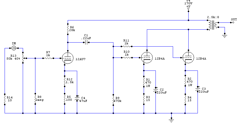

OK, Here's what I have for the amp, a PSE using 12B4s, single ended of course.
I have a decent collection of rectifyer tubes 5U4, 6AX4...

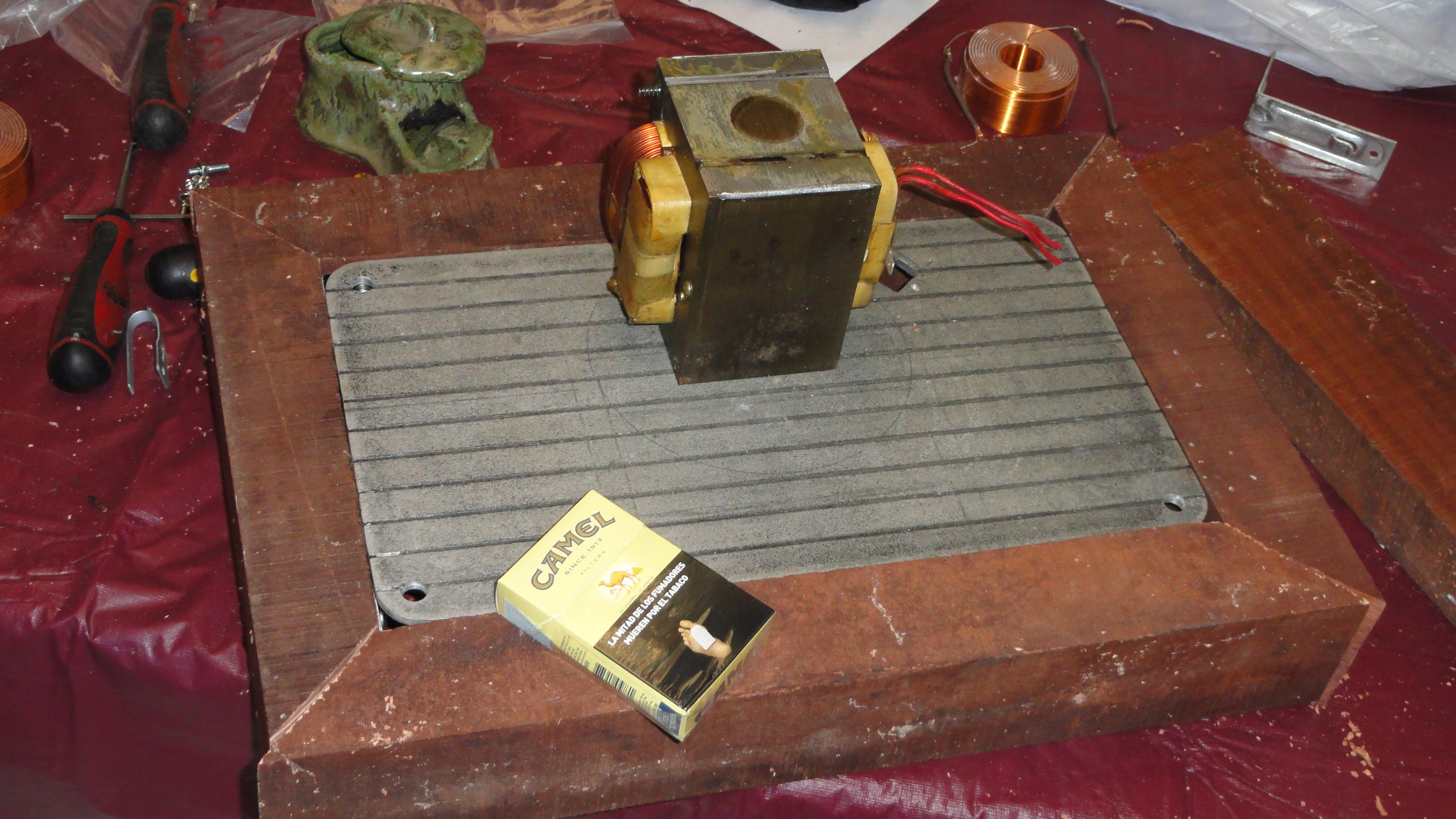

The mains transformer primary, 220VAC @50 Hz, The secondary I will be winding shortly and I will be running all my available wire on the bobbin. It is a pair of 10mH, eighteen gauge, 1.95 Ohm DCR coils....the wire size is slightly less than the primary. Once the first one is wound, I will splice in the second one & resume winding....this kind of precludes having a center-tap. Once all the wire is wound I will reassemble the TX & test for voltage. Once the maximum voltage is measured I will unwind turn by turn to get to my target voltage. I estimate I won't get much past 230 VAC.........aiming for 170 VDC.
The total current draw for the amp is an un-known (Don't know how to determine that).......The 5H coils is rated for only 100 mA....I doubt the total draw exceeds that value.
____________________________________________________Rick.........
