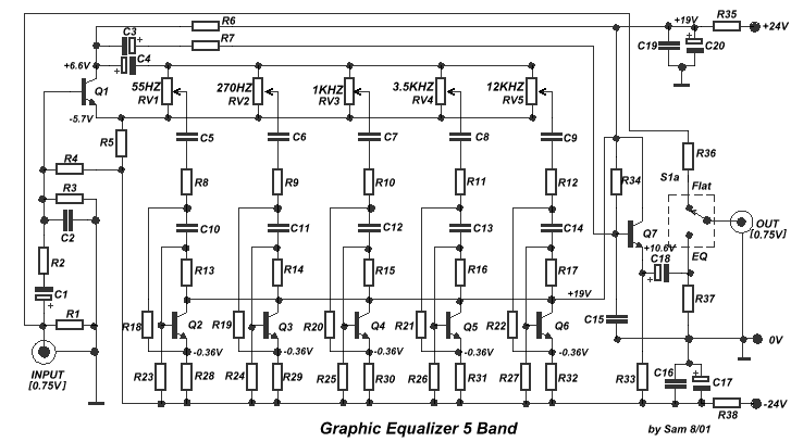

I have found this http://freecircuitdiagram.com/wp-co...e-Baxandall-Tone-Control-2-Band-Equalizer.gif which is a passive graphic equilizer which could be used to let only the voice pass through. Of course this is passive, meaning lossy and I have used an input and output transistor buffer to overcome the loss.
On the other hand I have found this http://www.rlocman.ru/shem/i/users.otenet.gr/~athsam-Circuits-EQ_3.gif which is an active equalizer but it uses more transistors, I wonder if I could omit a few bands without problem. The problem is that it uses symetric psu +-24v

These circuits are basically tone controls, they arent very suitable for speech control.

The 500mW is the speaker output power. Part of the amplifier chain will be used for the phasing modulation combined with a passive audio polyphase network.
The thing is that this polyphase network keeps relatively accurate phases at about 300Hz-3KHz. Out of this range the phases loose their accuracy and the unwanted sideband starts to appear. Also, the greatest audio bandwidth is, the greatest the RF bandwidth is, because the phasing method of ssb generation does not have any RF bandpass filtering mechanism. So I need to limit the audio or at least cut off the higher audio frequencies. Unless my considerations are not right...
A simple audio compressor will allow for almost the same RF level for all audio variations (keeping the SSB signal power at maximum), but for bandwidth limiting I need an audio filter.
I am just wondering if a simple filter can be made using a few transistors. The buffered passive filter works ok but I just wonder if a better simple solution can be done.
