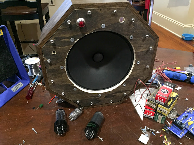

Hello everyone – first time posting here. Getting into amp building after a bunch of pedal builds. But I’m having trouble with my first one and was hoping for some guidance, it’s a 5F1 (simple right?). I initially bought a Chinese kit off ebay that came with chassis, tubes, transformers, turret, wires, etc. But I decided to put it in a small octagon shaped box (I make guitar pedals in the octagon shaped Hammond enclosures, so got it in my head I needed an octagon shaped amp). A guy who makes octagon dice trays made me a cabinet, looks pretty cool.

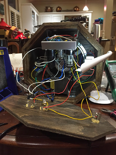

So with the size of the box I could not fit the original chassis, so I did point to point in a small 4.5 x 3.5 x 1” Hammond chassis, following the weber schematic with all the parts I got in the kit. After a few issues (transformer primaries labeled wrong in the provided schematic, thought I fried it) I got everything looking ok. The point to point was pretty messy in the small chassis, but voltages looked ok, and I got sound, but it was sputtery and jumpy. Meaning as I turn the volume up it is erratic on the level. Also at a constant setting, hitting the strings harder will jump to a louder level (video/audio below). Troubleshooting it I replace each tube, hooked up a different PT and OT, but still had the same issue. Speaker works fine with another amp driving it, and when I play this through another cabinet, it does the same thing. It would act differently with a new 12ax7, where I think it would be ok, but then back to original issue. Could I be frying the 12ax7’s?

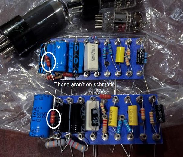

I was posting a build log on madbean and was getting some help but never figured it out (post lost in a crash on the forum). Many thought the point to point could be dangerous (I admitted to a few shocks) and I should start from a kit and turret for my first build. So I took it apart got some turret board and turrets and laid out a version that still fit in the small chassis. Got it all wired up with the original components and sockets, but it did the same thing.
Now, thinking it was a bad component, I got all new caps, resistors, laid out another turret board, new sockets, and it’s still doing the same thing!!!!! Any help, suggestions, guidance, criticisms appreciated. Some notes, video, pics below. I did figure out the switch on the pot for power was wacky and contributing to some of popping, but still left with what is in the video.

- Single input with 34K input resistor to mimic the two 68K in parallel, is this the correct thing to do?
- B+, B+2, B+3, bias voltages change with volume position, is this normal? I just noticed this during last troubleshooting run. I show them in the video.
- Initially used the 330 V windings on the PT, but got kinda high voltages, it had 300 taps, so used that and got the voltages more in check. The issue was there using both voltages.
- Tried probing with audio probe, but not sure I was smart enough to figure anything out. Output of first stage sounded fine. Had trouble hearing the audio probe over the actual amp speaker on preamp pin 7. I have an L-pad, I suppose I could set it for 4 ohms and hook the output transformer to it so I could just get the probe volume. Or is there a problem doing that because of AC impedance vs DC resistance?
- I was checking continuity on some spots and got a continuity beep on my DMM when testing the speaker jack tip to ground, but maybe that was because the low resistance of the speaker, so I pulled the plug to disconnect the speaker, but still was continuous. Should this be continuous across the transformer secondary?
- Is my grounding scheme OK (see pic). All go together to one wire to the chassis. All internal go to same point. Both are u terminals bolted to chassis.

thanks mozz, i saw that tip somewhere, going to do it tonight. of course in my head i'm certain it's all correct, haha. I've done some stupid things with pedals.
More info
B+ seems to vary from 334v to 350v, think B+2 and B+3 vary more.
Measuring the pot i get the following:
Pot pin 3 (after 22n coupling cap)
starts at zero
-0.323v @ 12 o'clock
-0.665v @ 1 o'clock
-0.825v @ 3 o'clock
-1.2v @ 4 o'clock
then falls back to zero from 4 o'clock to all the way open
Wiper (pin 7) follows same pattern but peaks at -0.500v at 4 o'clock
Pot Pin 1: grounded and stays grounded
the 6V6 pin 5 (post coupling cap from 12ax7) does a similar thing peaking at -10v
