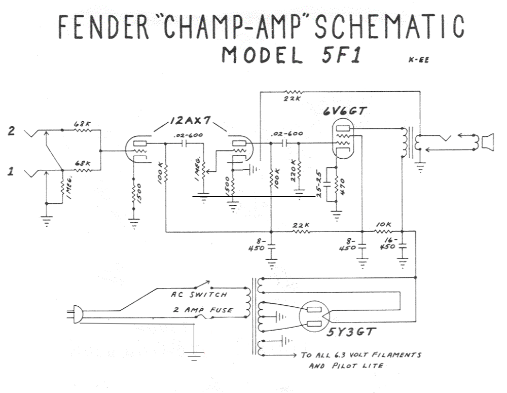

I have built my first amp, a 5f1 from scratch about 2 years ago and it works perfect. I am following the original schematic, just removed the death cap and added a 3 prong cord.

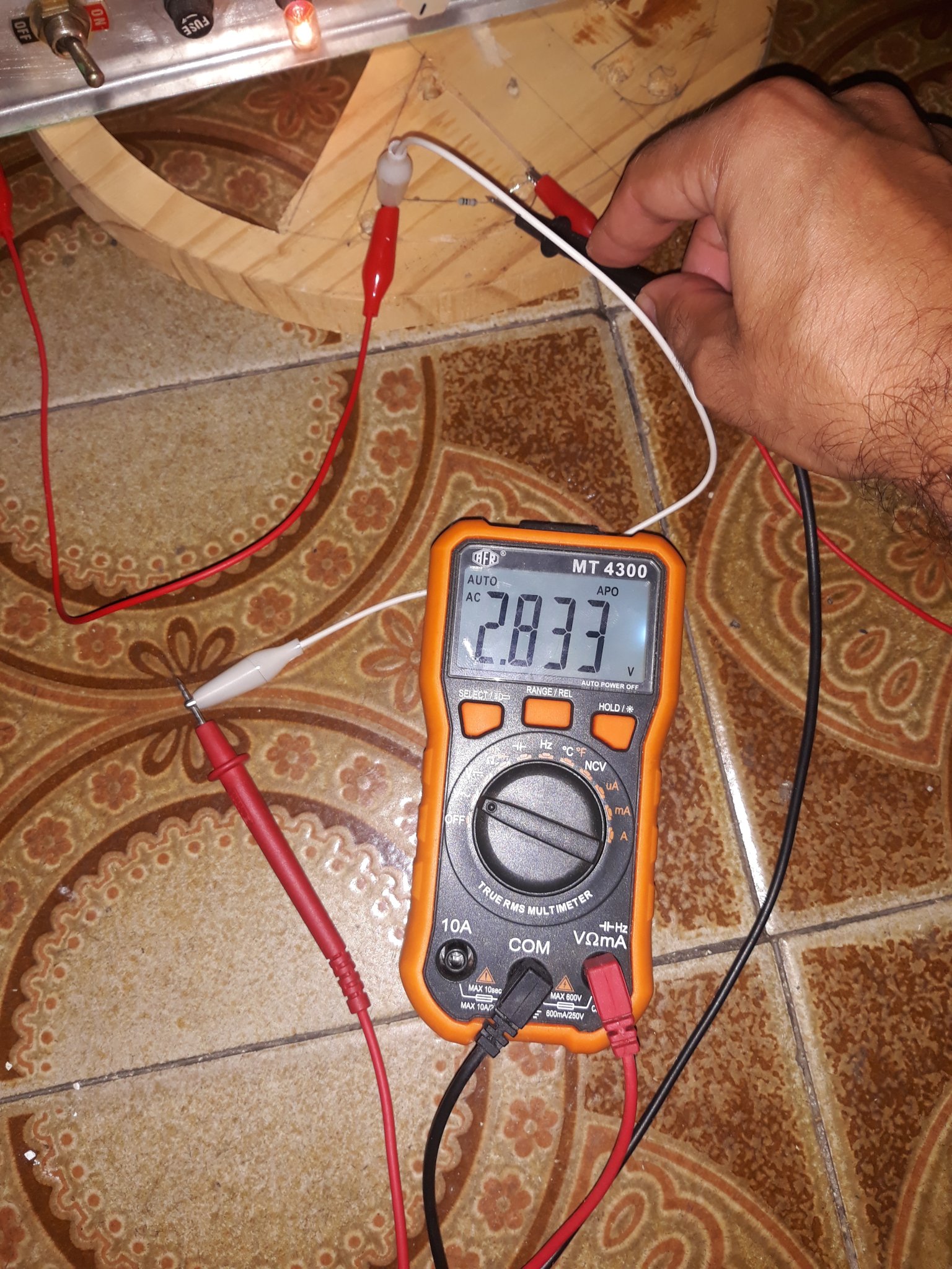

But I have made an experiment: plugged it into a non grounded outlet (only 2 pins) and if I measure with my simple multimeter (I have no LoZ) the AC voltage between the chassis and an earth ground I get about 328.9 vAC but if I put a 10k resistor in parallel with the multimeter probes I get only 2.8vAC.
Can I consider this normal (ghost voltage), may be due to some kind of capacitive coupling in the power transformer?
I checked all connections inside the amp and cannot find any short between high voltage windings and the chassis.
You can see photos of the measurements attached.

The leakage current is most likely the capacitance from the power transformer primary to the high voltage secondary (winding to winding; or winding to laminations to winding).

It may not be very much leakage current. Even through only a few hundred pf at 60 Hz you’ll read full open circuit voltage. If the source impedance (all capacitive) is a few hundred k ohms and the load is the 10 meg impedance of the meter it will read just as if you connected it directly to the AC supply, transformer winding, or wherever it’s coming from. It normally wont be enough to bother you - if you touch it you end up loading it down, usually below a few volts. If leakage gets too high you’ll feel it and it becomes dangerous. If the voltage you measure across yourself gets above about 30 you at least start to get a tingle. The 3rd wire ground provides very low Z and prevents this buildup. Prevents similar buildup of static charge, too.
