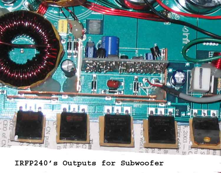

Well i got a free infinity 5 channel amplifier model 255A
When powered up works with no problems at all except the 5th chanel doesnt want to power up. the 5th channel being the 250watt part the subwoofer amp.
All the fuses are all ok no burnt parts or any thing like that. Im wondering where to start. i have tested for voltages near the smps and they are all working i looked at the fets and there all ok also.
any sujestions any one...

try measure punch through ont he fets (gate -> source). If thats good power it up and measure the secondary and primary voltages. Make sure the primary doesn't overlap.
Check secondary dc, if the PWM is getting past the caps one of the caps must be gone.
If that checks out check all transisters for consistancy. (or fets)
most likely a output transister has died without you knowing. Measuring them out of circuit if you suspect their dead, they usually come up with a dead short.
