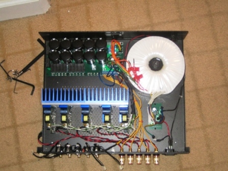

I feel terrible posting such a simple request on a forum like diyaudio, however I purchased a 5 channel UCD400 amp kit and after working for three months just fine, the amp overheated and blew the softstart module. Sent the amp back to Kevin at diyaudio and he basically told me that I wired the amp like a moron and that I should tear it down and rebuild from scratch testing each module as I go. I need some help troubleshooting the amp, and then some guidance on rebuilding it. I thought building this amp would be a fun, expensive project to learn from, but I screwed up the first time and this second time around would like to try and recruit a little help to make sure it gets done correctly.

First things first, do you have a multimeter? You will need one to troubleshoot the amp. Disconnect all of the ucd modules from the power supply. You will need to verify that your supply is working properly first. If it is, then you will need to probe around each disconnected module to look for anything out of the ordinary. We can help guide you here if you don't know what to look for.

Just take your time and fix it as I suggested in the email. If you use the appropriate wire, use wire ties and route everything as I suggested you won't have a problem.
Remember, wire ties are your friend. Neatness counts, especially in these multichannel builds. Use the appropriate sized wire for the job. Part of your problem may have been the 12V mod. The bundles of wires where so large that I couldn't get them to reliably hold inside the screw-down terminals. One of the modules is bad but that is easy to test for if you build & test one at a time.
Just don't get in a hurry and double check your work as you go and you will be fine.

I recieved the amp back from Kevin so I am going to begin the rebuild/testing. I wanted to get some advice on how everyone recommended I wire the amp.
For the power supply rail wires, Kevin mentioned that I should braid them. Should the center conductor in the braid be the ground?
In the picture I attached, you'll see that it is a tight fit if I route everything to the right of the modules (closest to the transformer). The first time I wired it, I ran the wires over the heatsink to the power supply, which I was informed did not exactly follow best practices. Before I start cutting wire, does anyone have any advice for me? I will be pulling out the rest of the wiring you see in the picture and basically start from scratch. The gauge of wire I used for the voltage regulator mod was way to big, I think I am just going to use some cat 5 this time around....
After I figure out how I am going to wire everything, I will move on to the troubleshooting and attempt to discover any bad modules.
