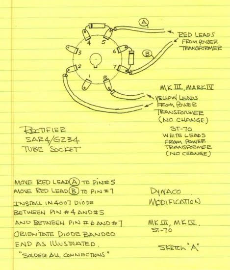

5AR4 "Graetz"/Dynaco Diode Mod for TubeLab boards
My "shop" Simple SE amp (with the outboard sockets for 6AV5 incandescence experiments) wants KT-88s so to play that Rock & Roll Music. I sense some jealousy of the ratty old QUAD 303.
For this mini-project, I would like to get the B+ up around 470-475vdc using current iron:
  • PST is prewar Thordarson 390-0-390v, 200mA.
  • Choke is Thordarson "swinging" choke, measures 8.5H at 100 ohms DCR
PSUD-II says that the options for a rectifier are
(1) Solid State. Nah, yeah, nah...
(2) GZ-37. HA! you make me laugh, PSUD-II....
(3) 2 x 5AR4 (GZ34). Sorry, bubba, not enuf fils current....
(4) "Graetz" 5AR4, which I believe means HYBRID rectification with 4007s on the HV terminals. IF SO, that would work great..

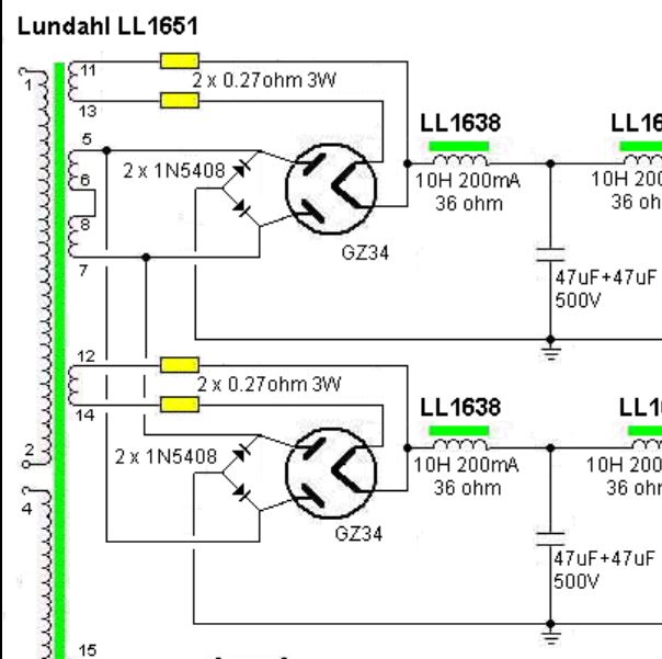

I assume that the 5AR4GRAETZ is like the famous DYNACO "yellow sheet" mod shown below, IIRC necessitated by the dodginess of current-production 5AR4s (have flashed TWO of them myself, one audio, one guitar, and swore them off about 5 years ago).
Is this indeed what 5AR4GRAETZ means in the PSUD-II rectifier list? Can't tell from the limited specs: PIV 1500V, IFSM 99A, IFRM 1.5A. Hopefully it doesn't mean a FULL BRIDGE S/S rectifier in front of the tube...
If so, has anybody used this mod with 5AR4s on TubeLab boards?
I assume it could be done by simply putting UF-4007s in the terminal blocks and soldering the HV leads to the diodes (with nice red shrink wrap, of course). Is that right?

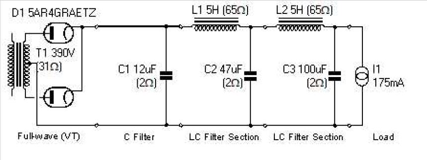

In other news, I played around with a "lower impact" P/S topology using TWO surprisingly tiny chokes I have lying around (Hammond 193 H, 5H, 200mA, 65 ohms DCR). See schematic below. This gives about 470 vdc B+, which is in the ballpark.
The idea would be to use a terminal strip between the chokes, and bring the 47uF cap back to the Star Ground.
Generally, I really like 3 stage filters with low-medium-high capacitance; in this case, the PSU-II shows virtually NO ripple (eyeballing about 0.0something volts RMS; my eyeball has a square root function, but with loose precision).
If a second choke isn't available or won't fit, an RC filter works pretty well, too. I may change out the chokes simply to get the 200mA current rating.
If you're using a choke on your board ANYWAY, it's a simple mod to add a third stage to your power supply filter, and then "tone-down" each stage...

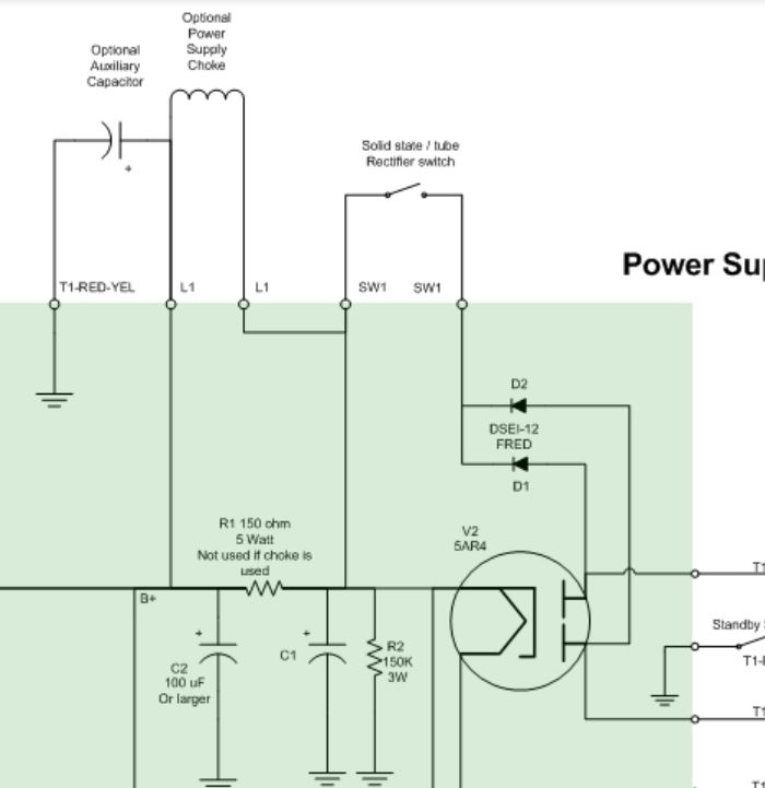

SSE Diodes
Do you mean THESE FREDs?
The "Graetz" mod (apparently popularized by a guy named Eli Duttman) comprises one diode on each red HV input from the PST, "pointed-in". To avoid confusion, I call it the Duttman/DYNACO mod.
It's like two half-wave rectifiers in series; the SS diodes "do the heavy lifting", while the 5AR4 looks pretty and supposedly smoothes-out the hash from the 4007s.
The FREDs on the SSE board are an alternative rectifier (ie you can have a tube rectifier -OR- a Solid State rectifier, but not both). Can't see any way to use those circuit board positions shy of cutting and re-routing traces.
Note that the nomenclature seems to be a little confusing, since the original Graetz design was a solid-state full bridge rectifier feeding a vacuum tube rectifier, if I am understanding correctly. This is why I am asking the question: what does the 5AR4GRAETZ in PSUD-II represent, a SS bridge + tube or a SS Half-Wave + tube?

(a) SS Bridge into vacuum tube rectifier (I doubt this one)
(b) SS diodes in series with the vacuum tube rectifier (with unchanged HV center tap to ground); the "DYNACO/Duttman" mod.
(c) SS diodes between vacuum tube rectifier plates and GROUND, with PST HV center tap LIFTED off ground...
The 5AR4Graetz simulation looks great, just don't know how to build it.

Each plate of the GZ34 has a diode in front of it like the "Yellow Dynaco Mod". The Centre tap of the H.V. has an NTC. Its all on the board now. It just takes the initial surge off the GZ34 at turn on, hopefully preventing the flashover and resulting death of the GZ34 which I have experienced with a J.J. in another amp (TSEII)

There is some conflicting information scattered through this thread. I'm hoping that I can make things clearer, not more confusing.
Andrewbee states that the "yellow sheet" mod is built into the SSE board. That's only true for boards made after mid 2010. The older boards did not have the diodes or the CL140. They were added due to some rather poor quality from all three vendors of new production 5AR4's at the time. Some builders reported one or even two brand new 5AR4's would spark out on first power up, but once a good one was found it would live for years. These parts can be added in series with the transformer wires. The diodes improve the PIV of the tube, and the CL-140 gives the cathode a few more seconds to heat before it tries to fill the empty filter cap when it's only half hot. The thin spots in the cathode coating heat the fastest and try to pass all the current, often unsuccessfully.
The Graetz bridge or Graetz rectifier usually refers to a typical 4 diode bridge, built with silicon or tubes. A hybrid Graetz refers to one that's half silicon, half tube. The yellow sheet mod is NOT a bridge, it's just two diodes in series on each leg of a conventional FWCT rectifier.
Using a bridge on a 390-0-390 transformer will result in about 950 volts of B+, far too much for a typical SSE build.
It is possible to run an SSE from a non CT power transformer. Connect the transformer secondary to the red terminals, and wire a diode from each red terminal to ground. If there is a CT on the transformer, it must not be connected to anything. B+ will be about 1.3 X the secondary voltage.

Still VERY Confused about "5AR4Graetz"
This is good stuff, George, but I'm still confused about the "5AR4Graetz" half-wave rectifier in PSUD-II.
Here are the B+ voltages from the Duncan PSUD-II, with 390-0-390v secondaries, my proposed filter, and 180mA Load
(ie apples-to-apples comparison):
5AR4: ~444V mean (but "IFRM of 0.75A exceeded at 0.77A")
"5AR4Graetz": ~458V mean (no error messages)
FullWave 1N4007: ~464V mean ("PIV of 1000 exceeded at 1004"
The "5AR4Graetz" (under Half-Wave tube rectifiers) is acting like a half-wave rectifier, NOT like a bridge, both in B+ voltage and in the shape of the voltage curve.
It IS acting like a "hybrid" (but a Full-Wave hybrid) in that it tolerates higher IFRM than the 5AR4 alone, and doesn't see the high PIV of the Full Wave 1N4007s alone.
Rectifier Specs comparison:
1N4007 Full Wave: 1000V PIV, 30A IFSM, 6A IFRM
5AR4Graetz: 1500V PIV, 99A IFSM, 1.5A IFRM
5AR4: 1500V PIV, 99A IFSM, 0.75A IFRM
I think "5AR4Graetz" has to be the Yellow-Sheet Dynaco Mod (4007s in series), and NOT a Hybrid Bridge.
