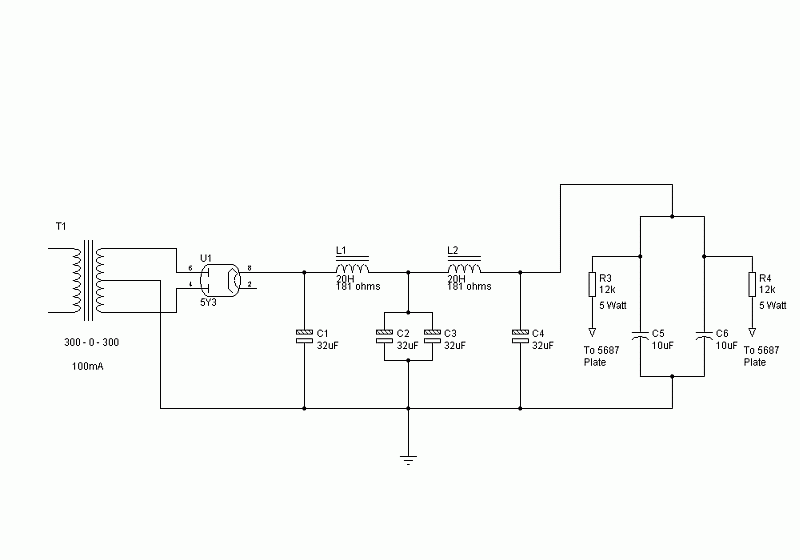

Hi Fingers. Did you use regulated DC supply or a simple filtered one? I chose the 20 H chokes because, since I use steel top plates I prefer for all of the transformers to be above the chassis to give me a little EMI shielding. The chokes that were used in the project that you pointed out are not very nice looking so I chose to go with the 193 series chokes. I really didn't think it would make a huge difference. My chassis is only 12 x 12 but I think that I can squeeze a couple of OD2s on it to do the shunt regulator (one for each channel). I have the caps and SS bridge to do DC heating if I use a simple filtered supply. I also have some Mill's 12 watt 1 ohm and 2 ohm resistors and a couple of Allen Bradley 5 watt 100 ohm ww pots to make it adjustable. I have all of the stuff but I'm unsure of which direction to go at this point. For every idea you have you are going to be given a dozen reasons it willl not work as well as you hoped. Yes I do have several 5Y3Gs as well as 5AR4s. I was just going to build a simple preamp to go with my amplifier. Now I'm not sure.
Keep in mind when you look at this supply that I have no experience with tube diodes. I think it is right but don't take this design and go build it until it is verified by some of our more learned members. I am showing only the supply for one channel. It will be doubled after the rectifier if I use the design. Please give me any suggestions that pop into your collective heads. The 10K resistor may not work where I have it placed nor at that value. Here is my first attemp at a shunt regulated supply:

Gavin,
Unfortunately it doesn't work as shown.
If you want to regulate 300VDC using glowdischarge tubes you need to stack a number of them to arrive at your target voltage, you'll need some spare volts to ignite them and set the current you want to run through them too.
In this case, assuming you'd want 300V you need to stack 2* 150V glowdischarge tubes and set them at around the midpoint of their current range.
That's like two OA2s set at 17mA current for an average deviation from target voltage of 6VDC at a max. current draw of 30mA.
Since you have a Class A circuit you only need to worry about having the tubes firing and staying within the max. permissible current.
After that the two tubes can be shunted with a 0.100µF film cap of say, 400-450VDC if deemed necessary.
Keep in mind you can't add any more capacitance after your shunt reg or it will definetely oscillate.
Maximum starting voltage for the OA2 is 185V each together with a maximum initial current draw of 75mA.
These are maximum ratings for the OA2 so you'd better settle for a little less.
Remember you're regulating a circuit operating in Class A, so current draw is pretty much constant.
Drawing about 20mA from the reg. isn't a big deal as you're not likely to go past 30mA under normal operating conditions anyway.
Hope this helps,😉
