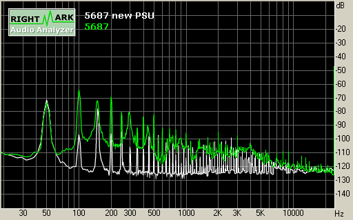

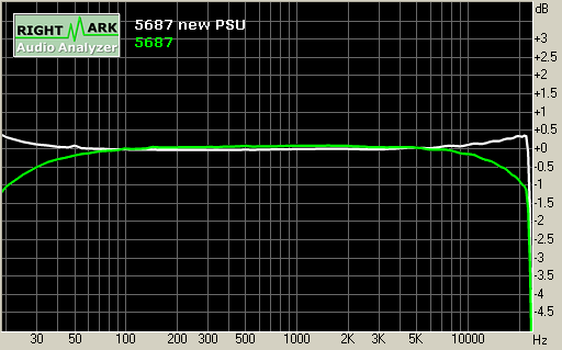

Spike is gone, bass is improved (as seen using RMAA), but lost a lot of harmonics

I've rendered this psu using psud2, but never seen this behaviour
My question: Is it a good thing(tm) to have added this C nest to the 5U4, and is it a normal behaviour for a tube rectifier to go way below ov, and to have this spike going straight up?
