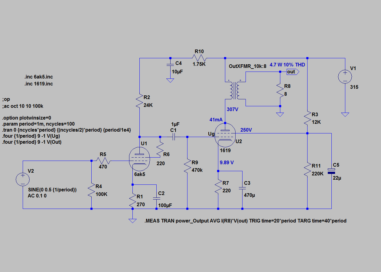

Triode mode: 5K:8 transformer, 330 ohm cathode res., 300V/41mA operating point.more than 1W or so from 1619 triode mode.
0.8W, 1.7% THD.
Finito .
Try pentode mode, with 10K:8 OPT.
4.7W/10% THD.

Euro21, in addition of triode mode and pentode mode. Will there be any advantage in both power/distortion by running this directly heated pentode in Ultralinear mode over pure pentode mode?🙄😕

So it looks suitable to drive a 2A3 or 45 if used in Triode mode ? biased at -2v
How did you pick "-2V" so quickly??
You like the sound of it?
Let's think. A 2A3 may need as much as 60V grid drive. A driver with Mu of 20-30 will give gain of 15-20. 60V/20 means you may need 4 Volts of signal to the driver grid. That's a lot for many Hi-Fi sources. And does not seem to fit a "-2V bias" condition.

2A3 normally -45 grid bias
Mu 30 -35 CCS on 6AK5 triode strapped x2 gain 60-70 v

looking more closely at the EF95/6AK5 Triode curves
suggest a bias of -3v 138v Plate 8mA with a CCS then a total gain of 90 should be possible with 3v input from a line stage pre amp ?
