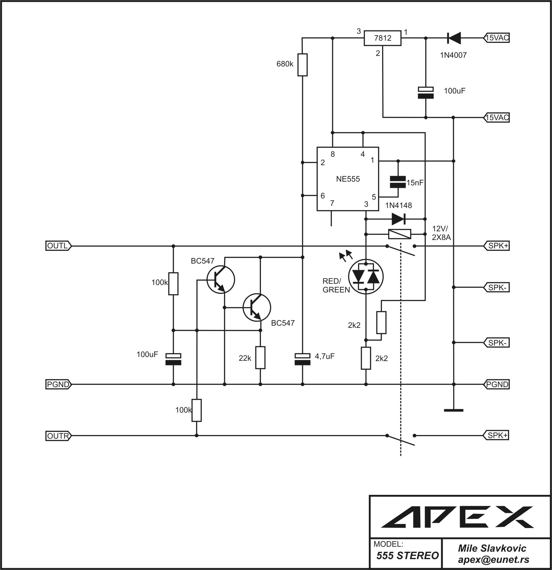

APEX protect with NE555
Hi Mile and rest of guys of this wonderful forum. This speaker with NE555 is interesting but I see that it only detects DC voltage but I would like to add an overload protect circuit to it. What kind of Overload circuit would you add? Once I was experimenting a protect circuit with this famous chip but using the reset pin as a control to switch on/off the timer operation. Well, thank you for your attention. Thanks beforehand for your replies.

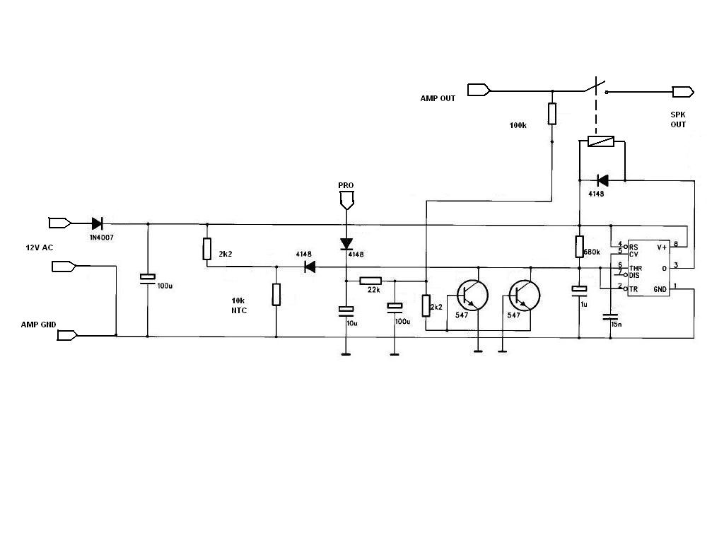

Hello PRR, thanks for replying. Nop, I am not blowing up my amplifiers 🙂 but I want to build circuit that allows me to switch off a relay when a load with very low impedance is connected to amplifier output. For example under 4 ohms. I want to keep my amplifiers operating with loads of minimum 4 ohms, if a 2 ohm load is connected, the circuit will detect it and switch off the output relay. I have see several circuits from vintage Power amplifiers such as old Sansui and Pioneers using Overload circuits for this task.
Hello PRR and jkuetemann. These are the circuits. The first one belongs to SA9500 Pioneer protection circuit and the second one to circuit sent by a friend.
