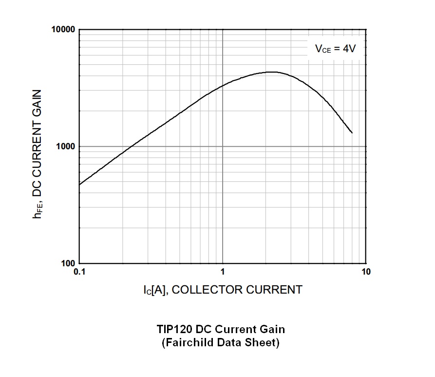

What you have is a low-side switch because the transistor is between the load (relay) and ground. Therefore the transistor shares a common earth reference with the 555 circuit, which is all that matters. The two different supply voltages are entirely unrelated - you could run the 555 from 5V and put a 500V load on there if the transistor is rated for a Vce that high.
A high-side switch is where the switch is between the positive supply rail and the load, in which case it doesn't share an earth reference with the control circuit. That is the case where you need some sort of level-shifting circuit, e.g. an opto-isolator or a second transistor. For example if you're building an H-bridge for motor control, you need both high- and low-side switches, and therefore you need level shifters for the high side. The low side ones are wired directly though, as you should with this transistor.

It turns out the aforementioned Arduino crowd--a wild bunch if ever there was one--use optocouplers only in the circumstances you mentioned. The rest of the time they seem to favor a TIP120 (max rating 3 amps at 60 volts) with a 1K base resistor.
The suspiciously small base resistor works because the TIP120 is a Darlington with enormous gain (1000+). Thus a 5ma current through the base resistor (5 volts / 1000 ohms) turns on the transistor without overloading the Arduino's output (max 40ma, as far as I can tell).
Google never forgets, so for other applications, for the benefit of future generations, I'm attaching the h-sub-f-e chart for a TIP120.
Thanks again laplace, and thanks again for the input of many. Proving once again that there's always a way, if you can only find it.
Yep. And a transistor as big as a TIP120 is only needed if you want to directly switch a moderate-sized load of an amp or two, e.g. a solenoid, light bulb or small DC motor. To switch a relay coil at maybe 70mA, you only need a BC546 or similar, which is a tiny and cheap device.
Don't forget the back-EMF diode across the coil or you will blow up the transistor when switching the relay off.
