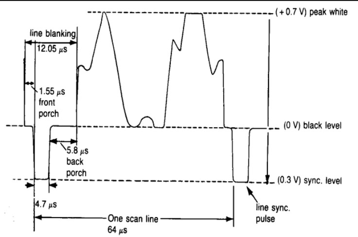

That explains a lot of what I was missing... Thanks! I'll have to try some things. What puzzles me is the 64/12 μs ratio of this square wave. Is there a fixed ratio as I'll be going for higher frequency?

The 12u second is the total of the all the components that go to make up the proper horizontal sync pulse on the PAL system.
There is the 1.55u front porch, the 4.7u sync pulse and a 5.8u back porch. All that adds up to the 12.05u sync/blanking pulse.
