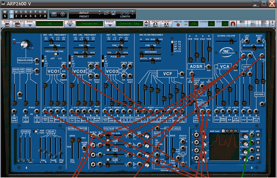

I stopped spending mad money on real hardware 5 years
ago and now enjoy 64 voice triple VCO's while even keeping
"classic" analog flexibility. The ARP 2600 in the attachment
even has the subtle nuances of the pearlman filters (I once owned the real unit)..
I even use line in through the VST host to add post
processing effects.
OS
