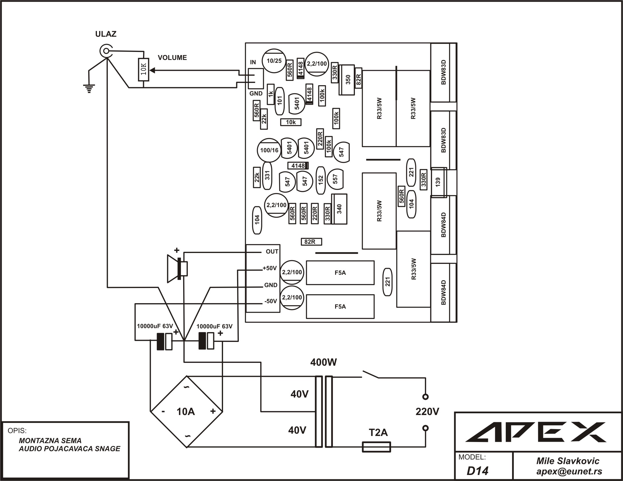

50W mosfet amplifier IRF540/IRF9540

Pioneer A-509R use IRF540/IRF9540 and there is OP amp in input stage. Have anyone expirience with this amplifier?

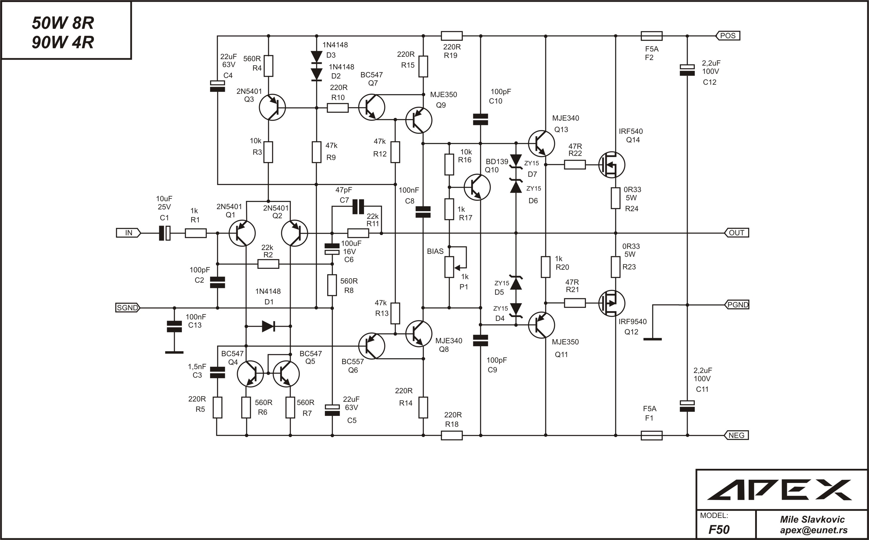

Surprised me that you have interest with amplifiers of "that" level. Cheap opamp, cheap drivers and most importantly cheap output devices. It only interests businessmen for creating commercial amps. But I will tell you that imho you don't understand who these DIYers are (in this forum) and may be the audio market. They aren't after cheap stuff like that (yes, some of them are after good brand name such as sony/pioneer, whatever the sound quality).
What I don't like from that hexfet simple topology is it surely require output relay protection, but the most important thing is I don't believe they can sound good even in class-AB. With this simple approach, the best sounding topology I have found is your darlington you posted previously, but with discrete darlington. May be a little bit expensive but definitely better than those fets.
Add/Edit: Oh, for high power one (such as PA) the darlington topology is I think cheaper (e.g. triple darlington), and a lot more stable.

I have interest for this amps only for hoby and fun, I agree that topology in my 100W Ultimate Fidelity Amp is superior in any way compareing with this Sony and Pioneer. Pioneer A70 from 80' is some different thing...
F50
IRF540/IRF9540 Amplifier +/-40V
