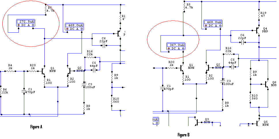

Balancing LTP current
Hi in the picture posted could anyone tell me which arrangement is showing the current flowing through Q1. Is it figure A or figure B?
Hi zeus-threat
they both show the current in Q1!
you've already got red circles round the "meter" showing current in Q1.
Don't think you need to try too hard to balance the current, but think that the currents could be a little higher.
With temperature change, the PNP next stage will change the balance anyway.
cheers
John

fig b is the one you want
but don't try too hard to balance currents, as PNP Vbe changes with temperature, so even if you get it right at one temp it will change with temp..

I think the current in the LTP emitters is the parameter that should be balanced. It can be measured across the emitter resistors.
When in balance the voltage across both Re are the same and then both emitters are at the SAME voltage. When that holds true then the Vbe of both transistors will be the same WHEN the inverting input voltage = non-inverting input voltage = zero output voltage.
I think that last bit is important so I'll re-phrase it.
When the difference between inverting and non-inverting input voltages are zero, the output voltage will be zero IF the emitter voltages are the same (assuming matched Vbe at quiescent current).
The difference between 272mA and 367mA (95uA) is the current coming from Q4 and that is Q4's [quiescent current/hFE]. A higher gain VAS will reduce this current fed back into the LTP. That higher gain has the effect of letting R5 define the collector load more closely. That 95uA indicates a high VAS current AND a low gain VAS transistor. I would be aiming for <=30uA (6mA/200).
