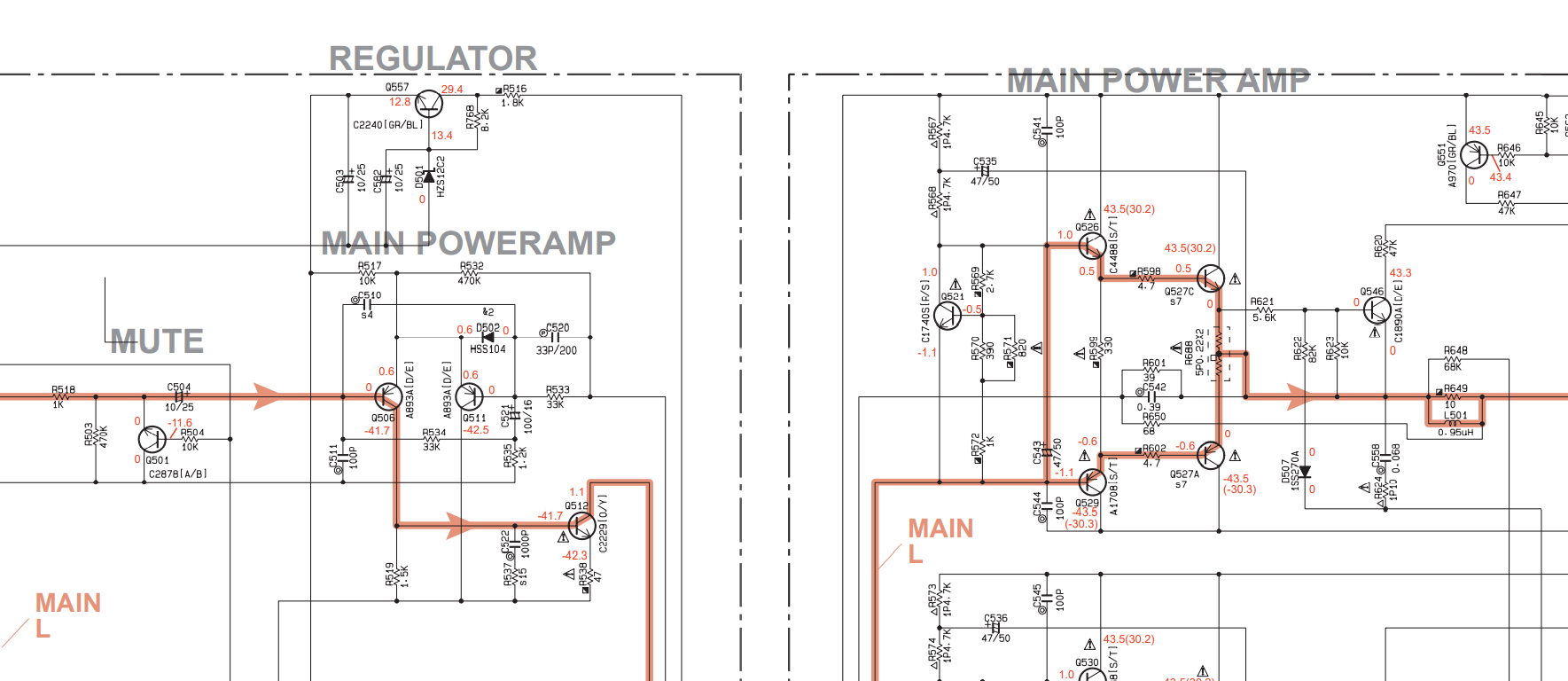

Yamaha use a similar approach in their older Home Theatre amps. But I think its to keep cost down on these multi-speaker amps.
Lets see what the guys come up with for improvements to ur one. Im not sure if the regulated input stage like in the Yamaha would provide a noticeable improvement
