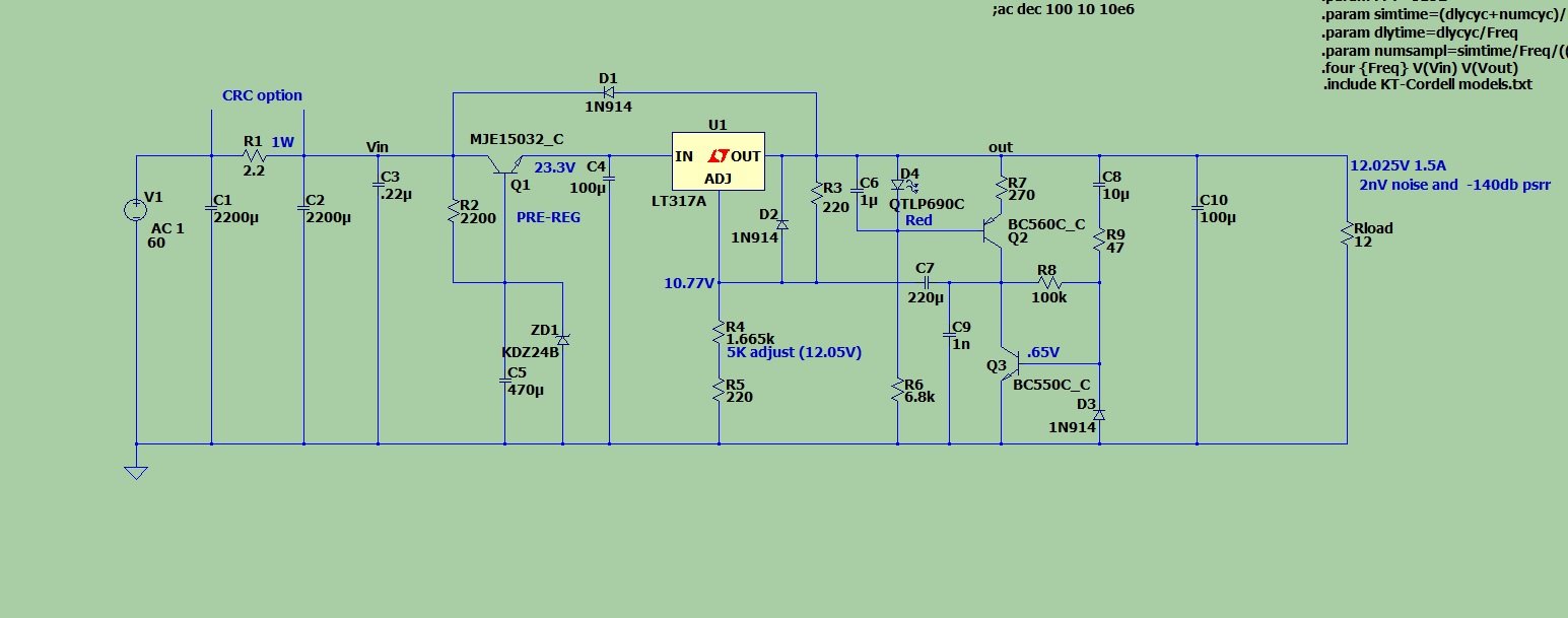

My exact situation was solved by this - (below). +/- 55V rail subamp , with a +/- 12V LPF "tap".I'm repurposing some gear I've acquired over the years to build/rebuild a subwoofer plate amp.
The main power source is approximately ±37v AC from a Toroidal transformer, which should give me around ±50v DC after rectification (I think).
"PreReg" can be a 24V zener. last stage = LM317 +"denoiser" will give -140db PSRR , even under the worst amp duty.
I just use the 317 alone for my 400W Hypex amp.

I did this with simple insulated wire to get a small single 8 V AC voltage for the protection circuit. The single AC is then rectified to a dual (symmetric) DC supply with increased smoothing caps.Add another winding over the whole works, using 22ga. solid insulated wire. Without taking anything apart.

The OP needs 4 times as many turns (to get 2X16 VAC, before rectification and a pair of 7815/7915). That does not look like a stretch at all, and by the time it’s all on there, can be made symmetrical. Radiated field won’t be much at preamp current draw, even if unsymmetrical.
My experience is that there is enough winding window in there to DOUBLE the output voltage at the full VA capability of most trafos if regular magnet wire sized for half the original current is used. That’s even using a proper winding shuttle. A 2x16 winding with bell wire will fit.
