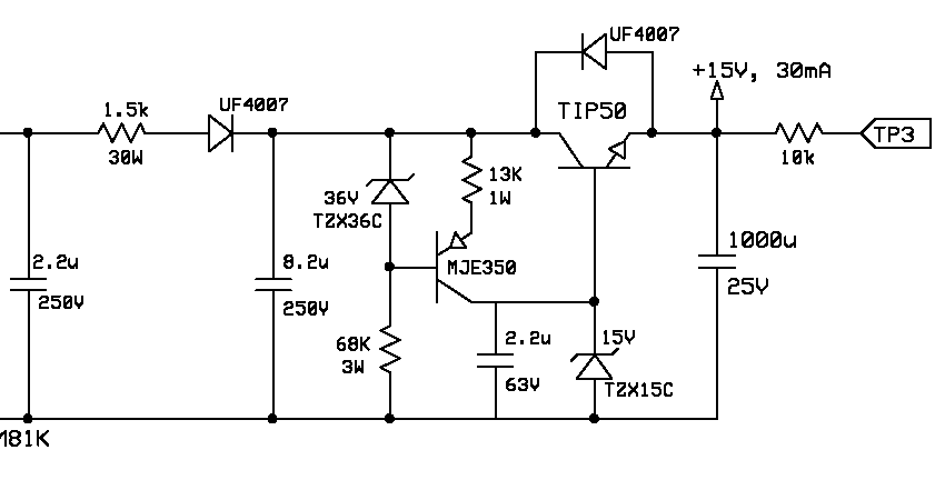

You do not have a very high voltage to start with, and the range of that voltage is not very wide. I would pursue something similar to this, in keeping with earlier recommendations.
This particular design was built for a very wide range of input, something like 50V up to 200V, and maintain regulated output and cool operation with the heatsinks. So the values look extreme, since it had to run with such a wide range. But the heat loss in your case will be very small, if you are confident of the input. Resistors can be made 0.25W, caps perhaps removed, etc.
