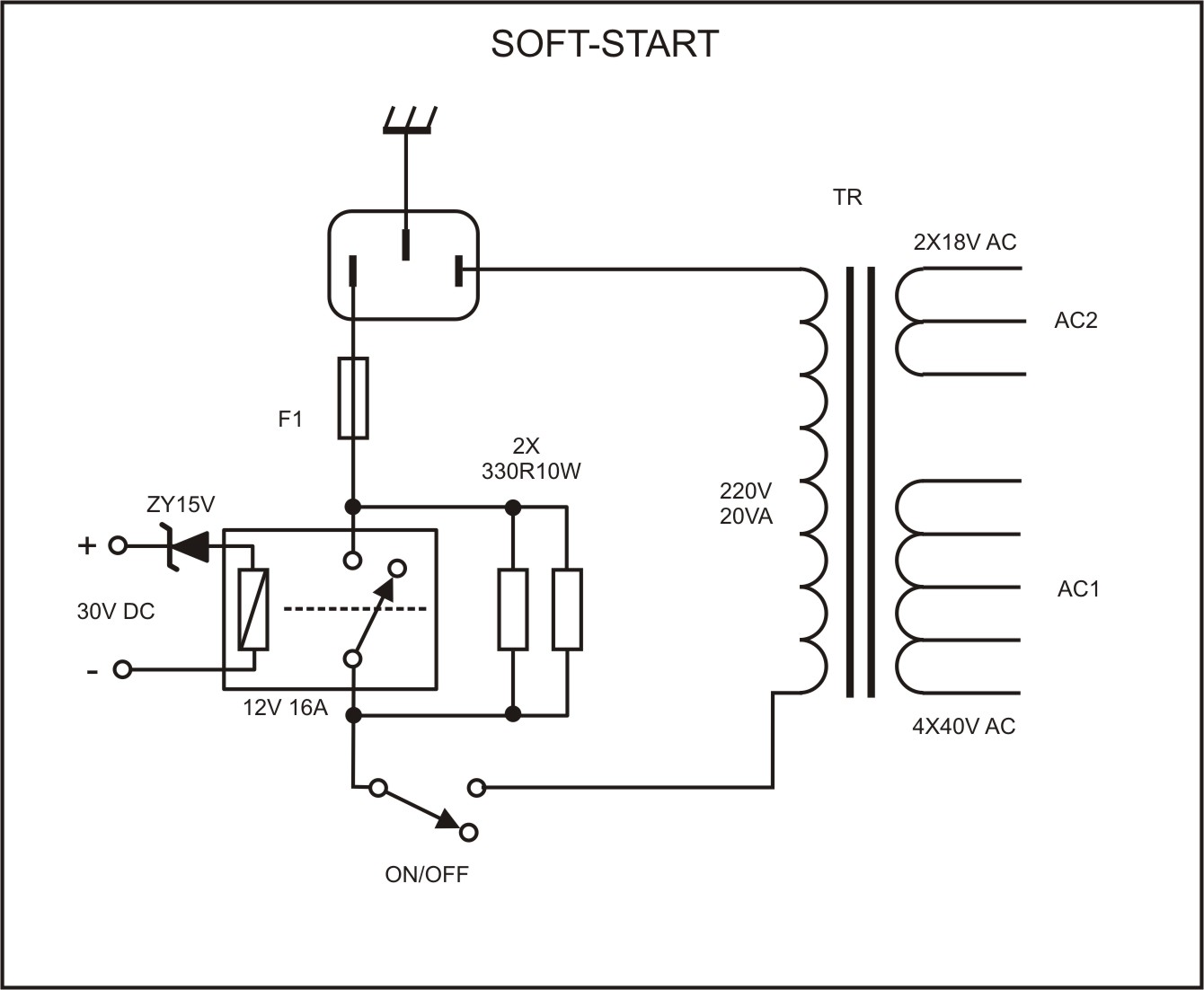

Lastly,for the first power up, i can't find 150ohm/20w resistor....
Is it ok if i use 2x330ohm/5w in parallel?
Or should i use 4x680ohm/5w in parallel?
