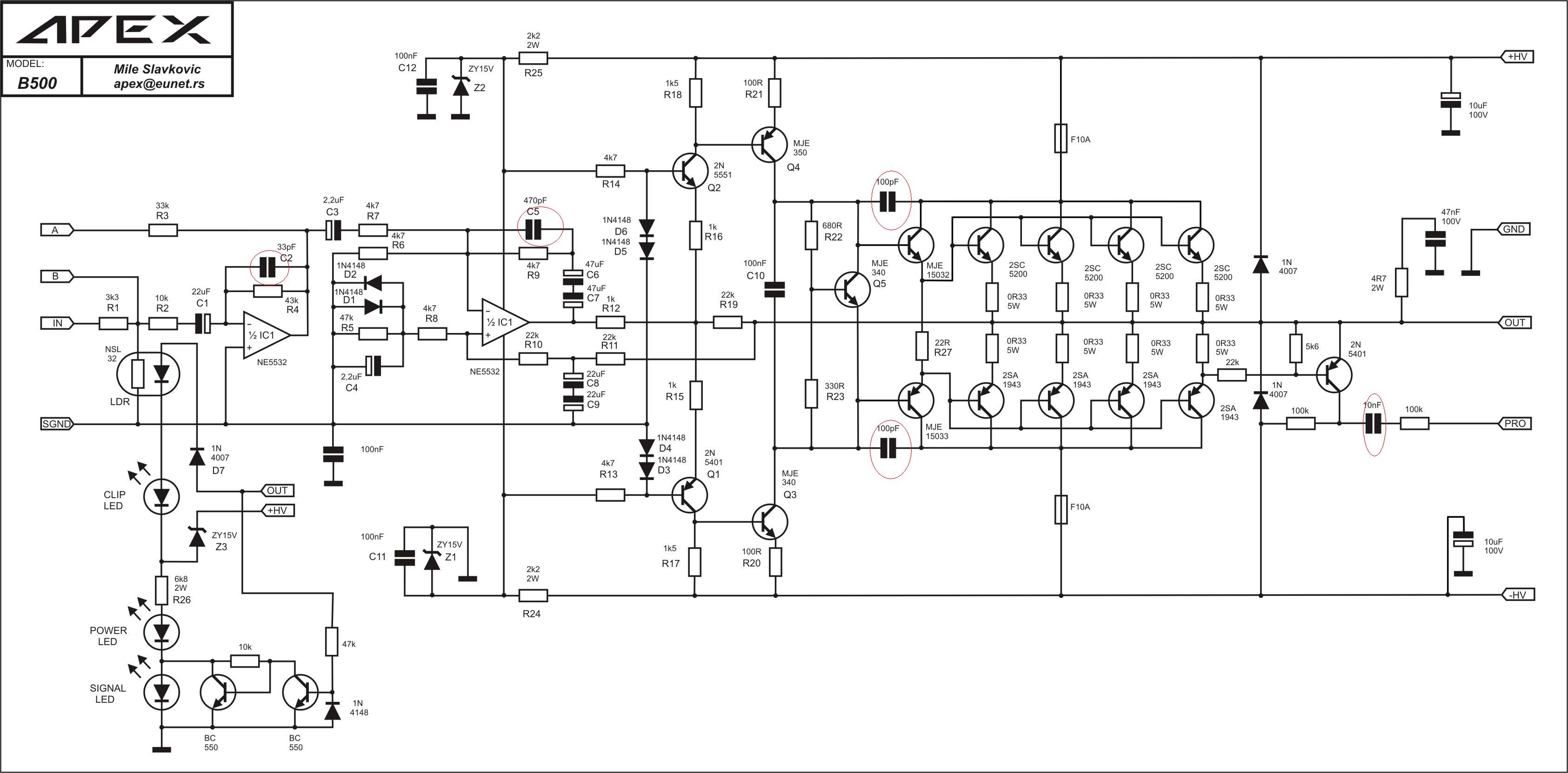

@APEXAUDIO, ive been trying to view this design before but i hadn't a priveledge,now that i can see the diagram probably in next month i will build this stuff for my mobile sound system and test it for my PA subs.thanks for sharing...Mabuhay ka!!!!

ive not regret building this amp...

Oh i,m sure as i can see in your photos on facebook,i cant wait to hear what it has for my PA subs...thanks BiBoi...my great influence in building such circuit.
Apex B500 is the most popular PA in Indonesia, in 500watt class.
Many Thanks for apexaudio
and is now on going in the philippines...
this is really a great amp that everyone would love to build...

sir what is the exact size of this lay out sir?Hi aman khalsa and all.
Thank you aman khalsa for final check B500 easy drive and i corrected for PCB.
