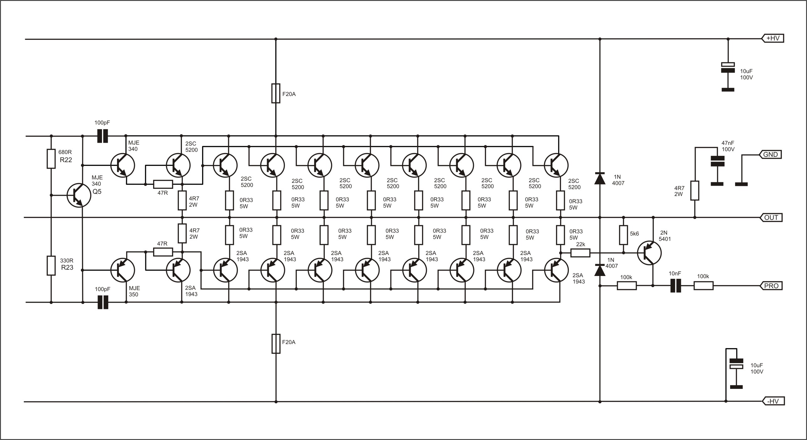

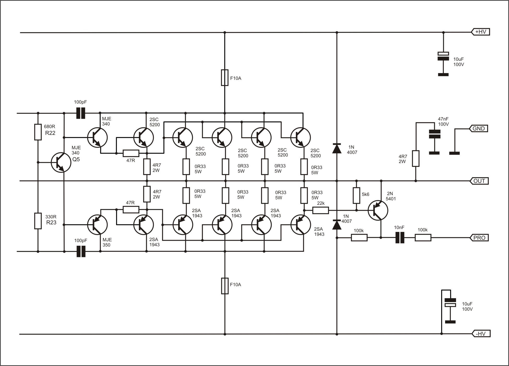

hi apex sir,
whats the difference of darlington,triple darlington. i mean the procedure.

You need triple darlington if you want drive 8 pairs of outputs for 2ohm load...

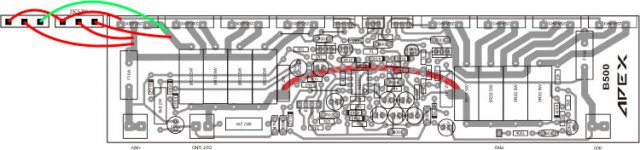

can u share the pcb layout of darlington or triple darlington.

if u dont have the pcb pls draw and show the additional darlington parts where to come and the paths in the board.

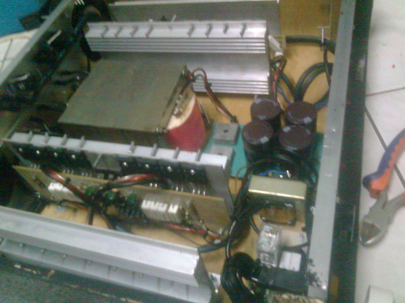

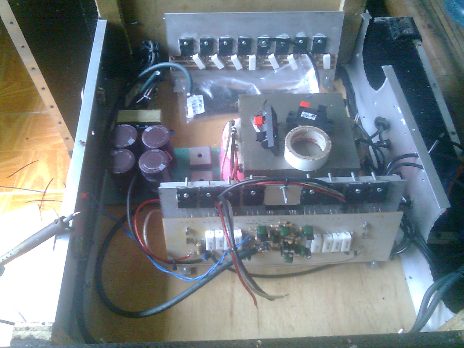

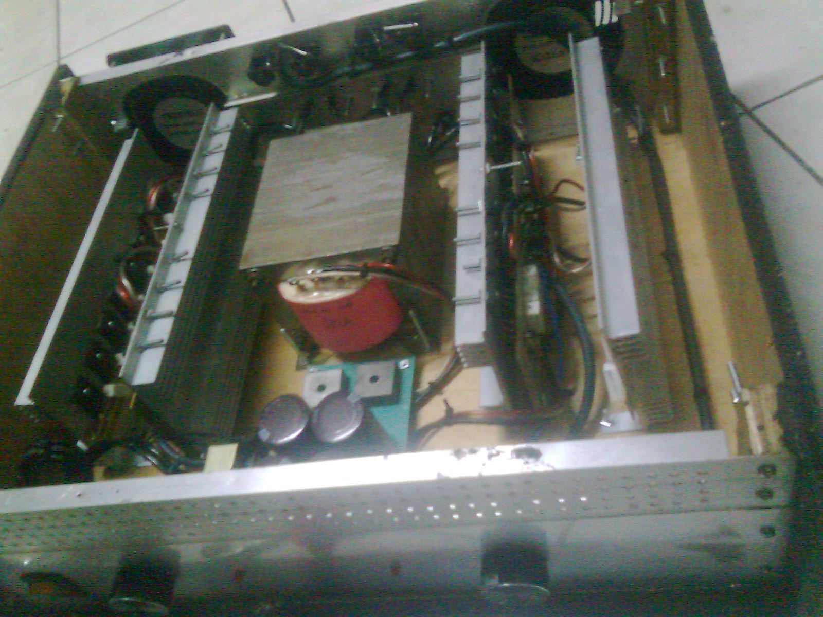

greetings everyone
this is my second amp build of b500...
8pairs output tranny
50 0 50 20amps trafo
thanks to sir mile a lot...
regards
ees
Nice work, can you post hi-res pictures?

greetings everyone
regards
ees
HI EESIBOY. GOOD WORK.

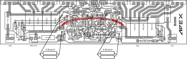

CAN U SHARE THE EXTRA 4 PAIR LAYOUT.
WHAT ARE THE CHANGES U MADE.
WHICH POWER SUPPLY U USE.

IF I ADD 5 OR 6 PAIRS OF OUTPUTS WITH 80V DC, WHAT ARE THE BENEFIT I WILL GET?
CHECK THE IMAGE IS IT CORRECT?
If you want add more outputs use triple darlington...
Regards
im sorry sir mile...
i only use my phone camera for pictures...
i do not have digital camera for clear pictures...
i will post clearer pics when i have better camera...
more power to you and to DIYAudio...
thanks
regards
ees...
