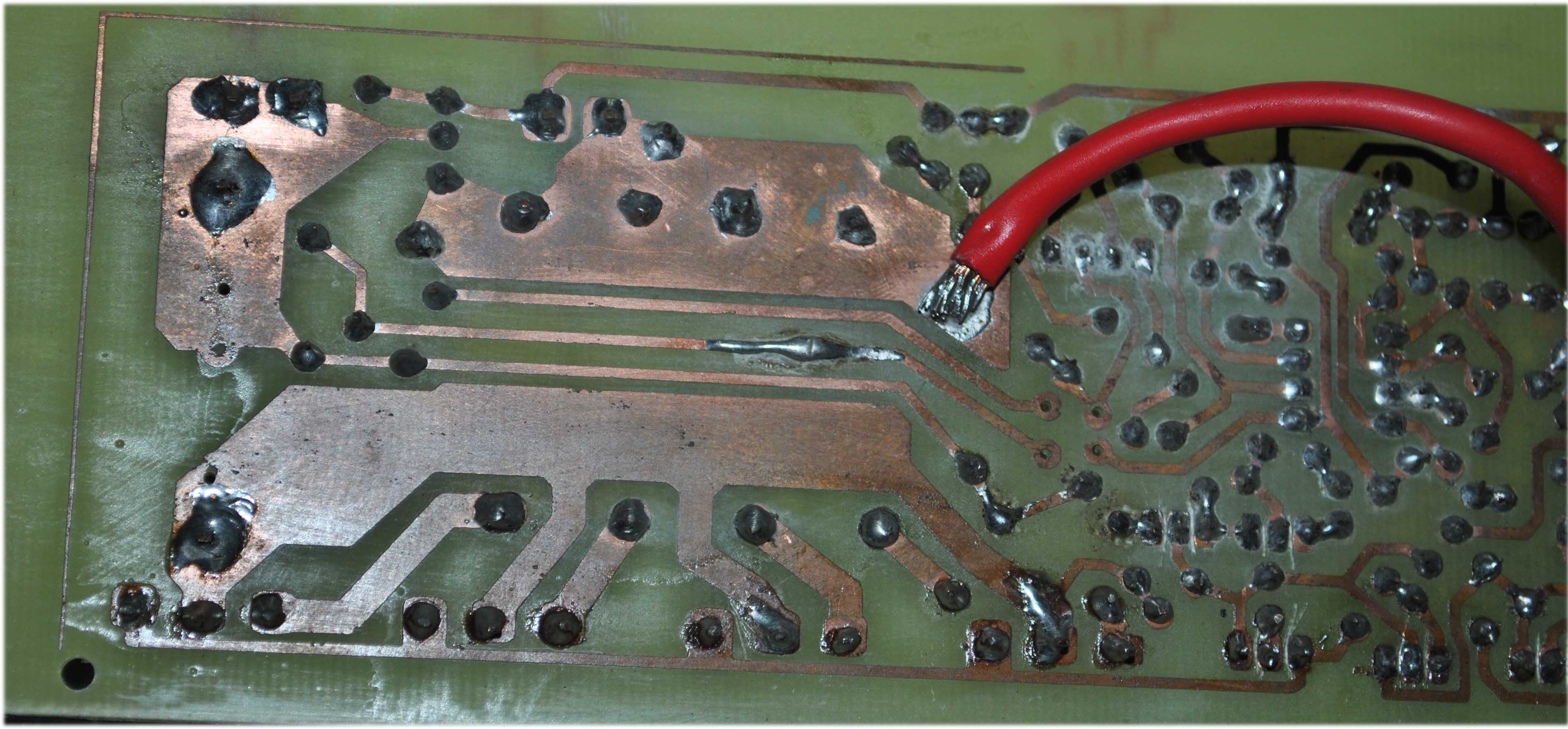

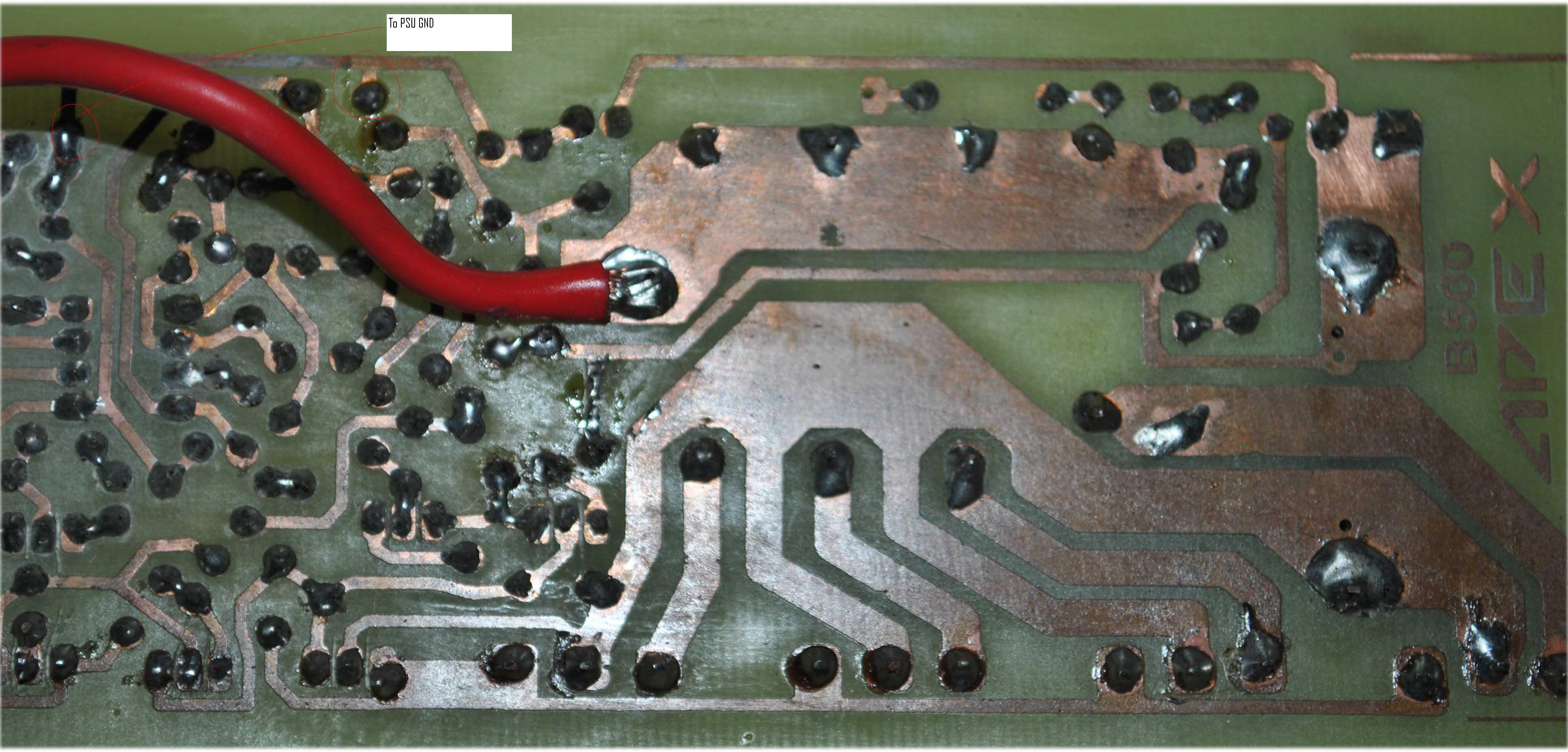

I am using low power transformer , could that be the reason.

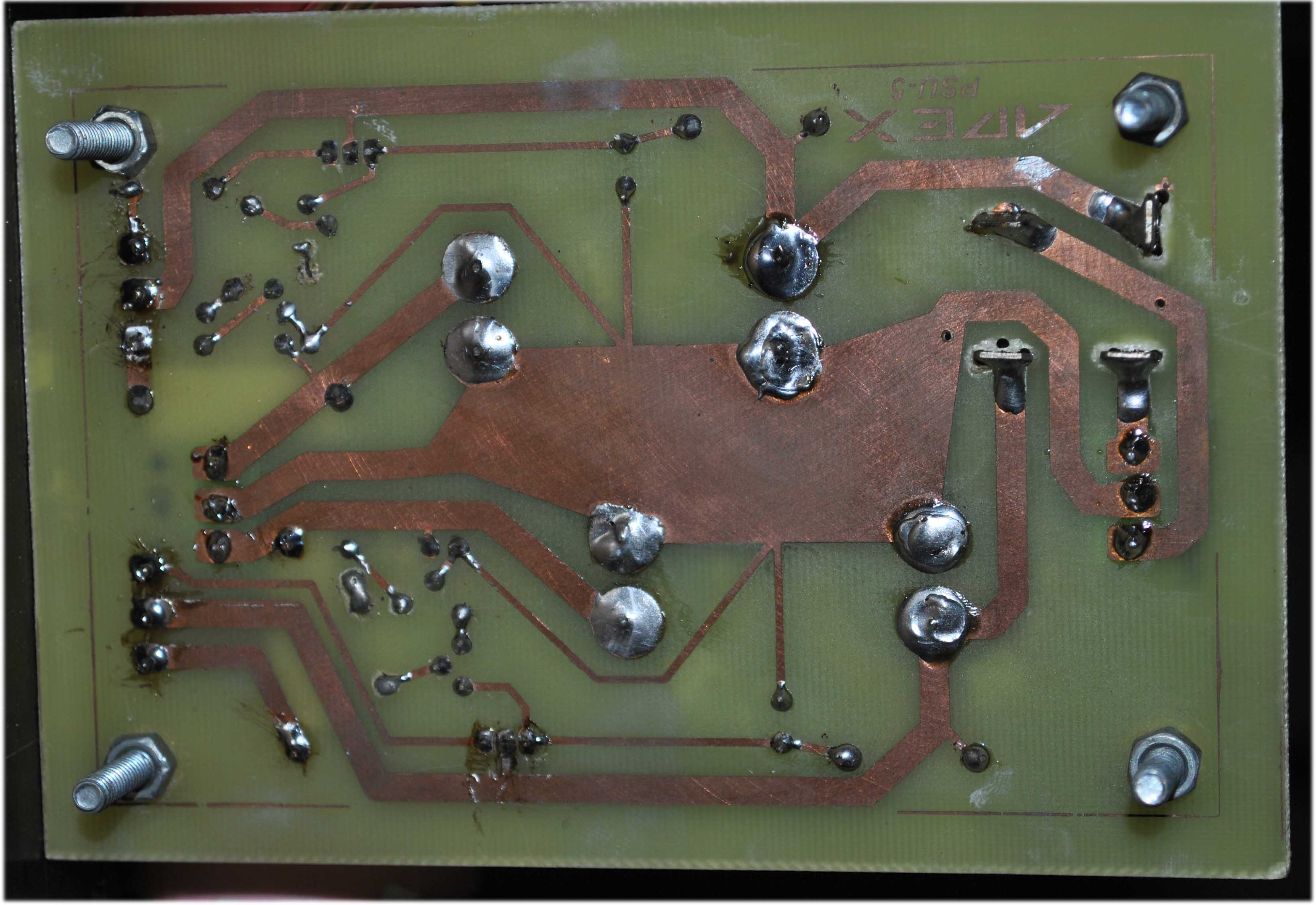

I have checked the tracks continuity, Its fine.
whats the voltage you used?
i did it, i checked each and every pin for shorts and cold solders, there were 2 shorts at mje340 and 15032, i cleared them, still the problem persists.
24-0-24 3 amperes, after rectification it is 37-0-37.

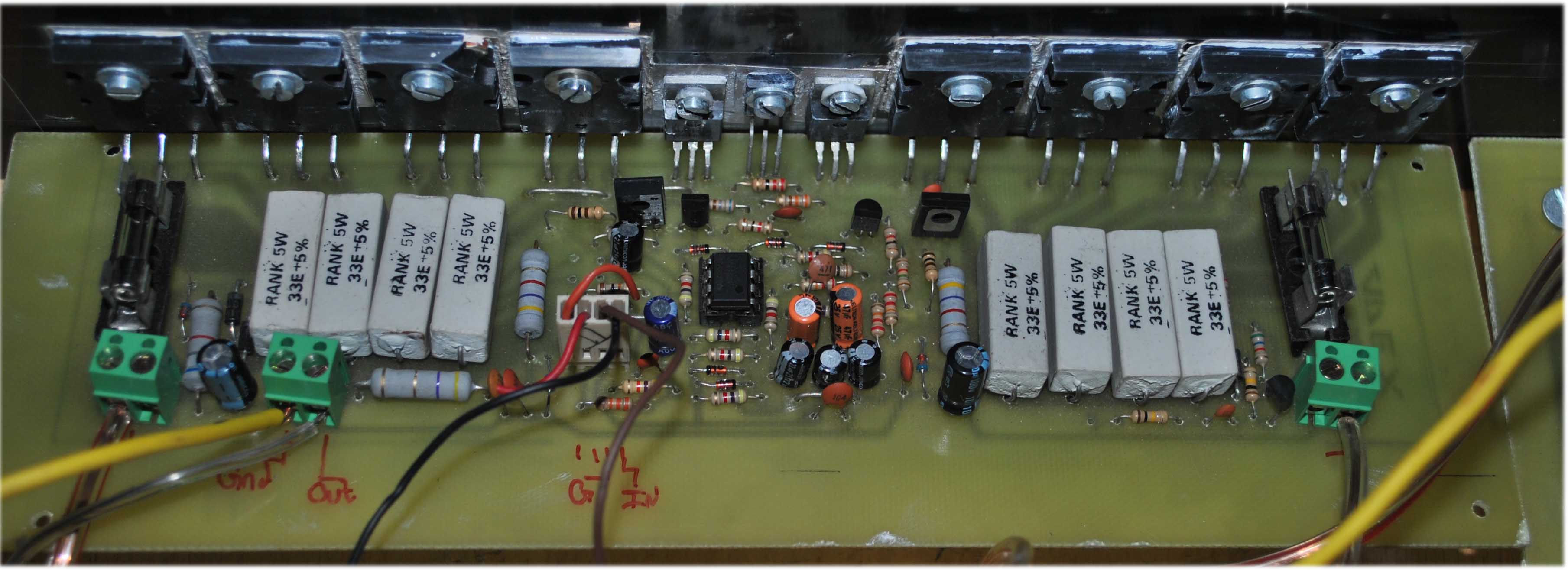

Maybe fake, some transistors?
not at all, all are original toshiba trannies.
post some more pics bro....
Check the pics and guide.

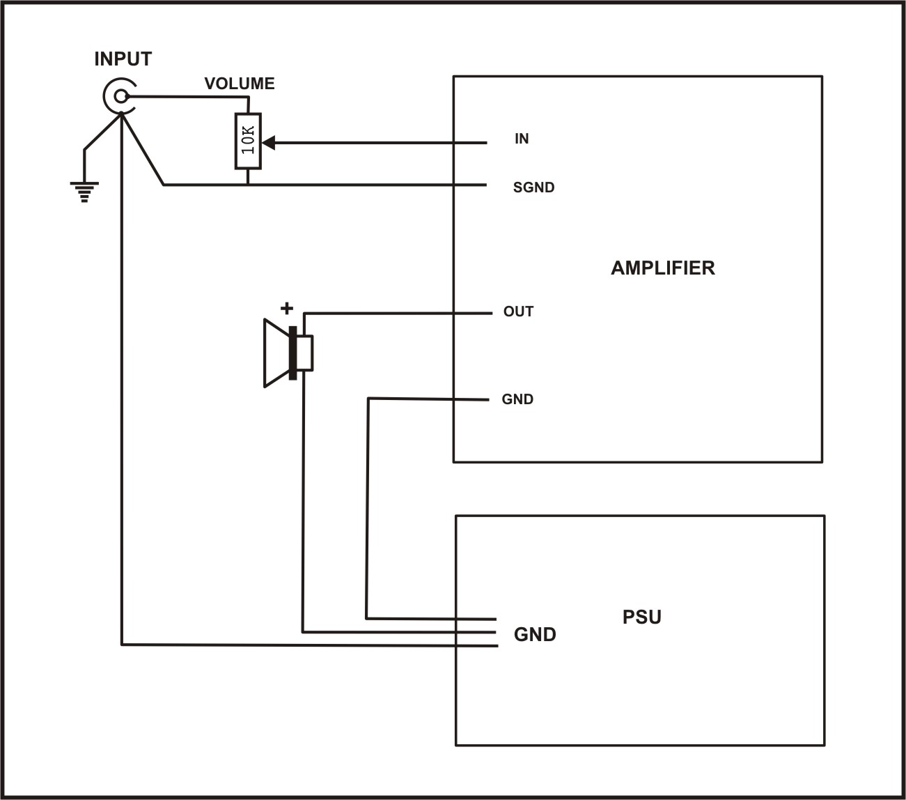

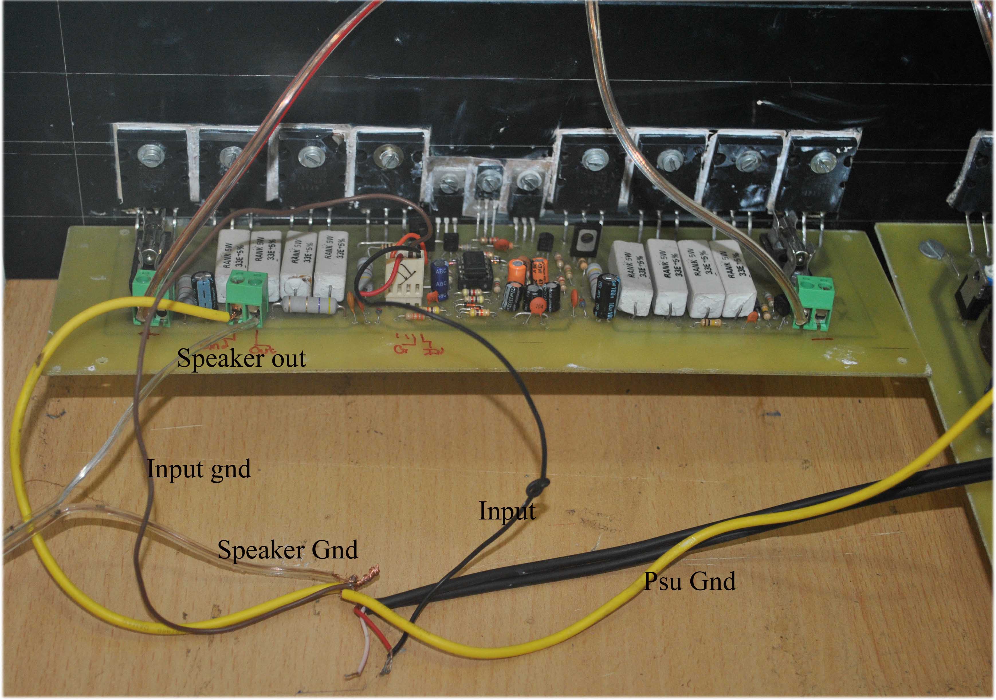

Grounding
I can't see input ground to PSU did you follow this?

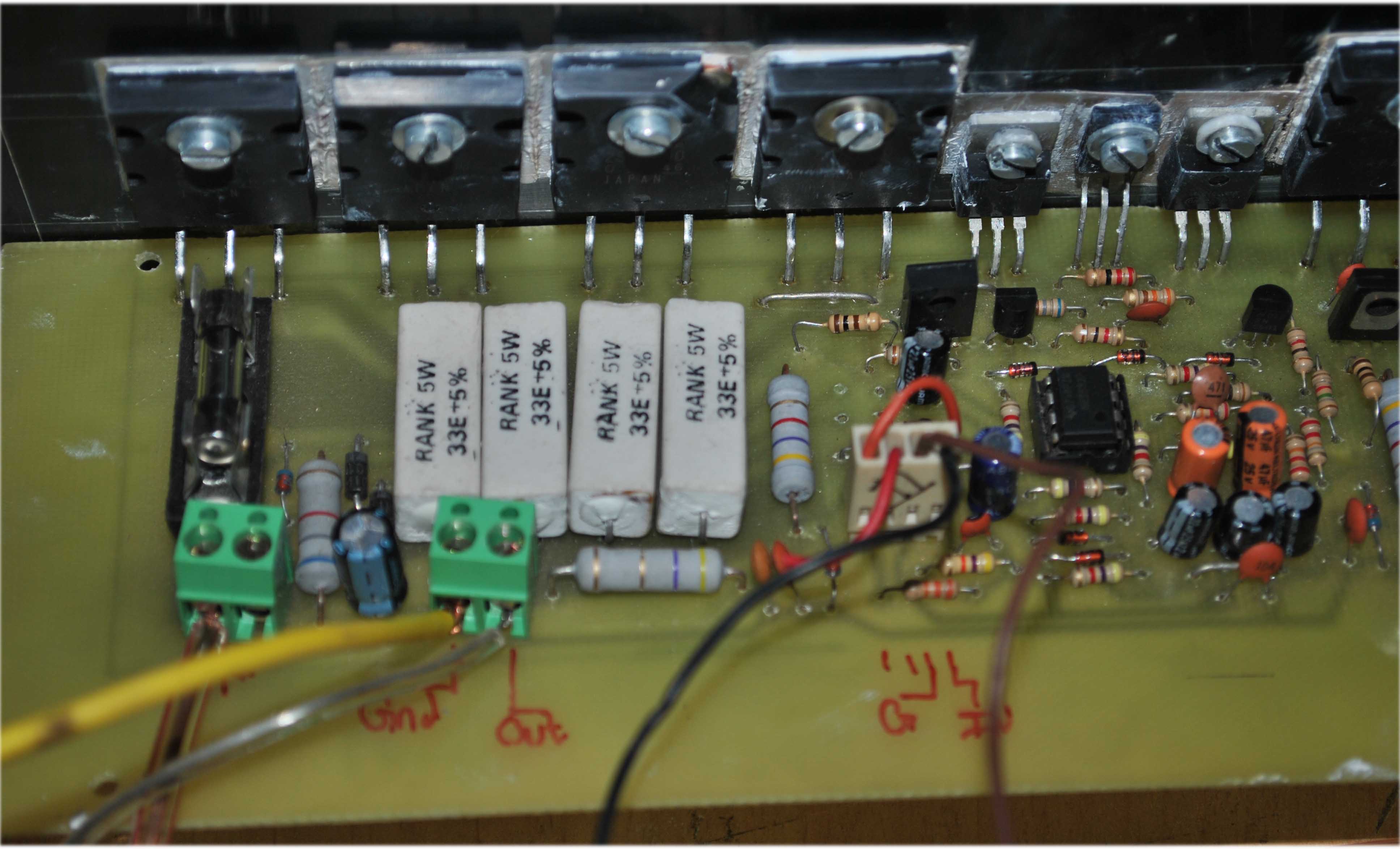

Hi..Viki.. I see your B500..that original resistor 47K (red code), but applied 4K7..is wrong..this picture:

The sound is very low and distorted.

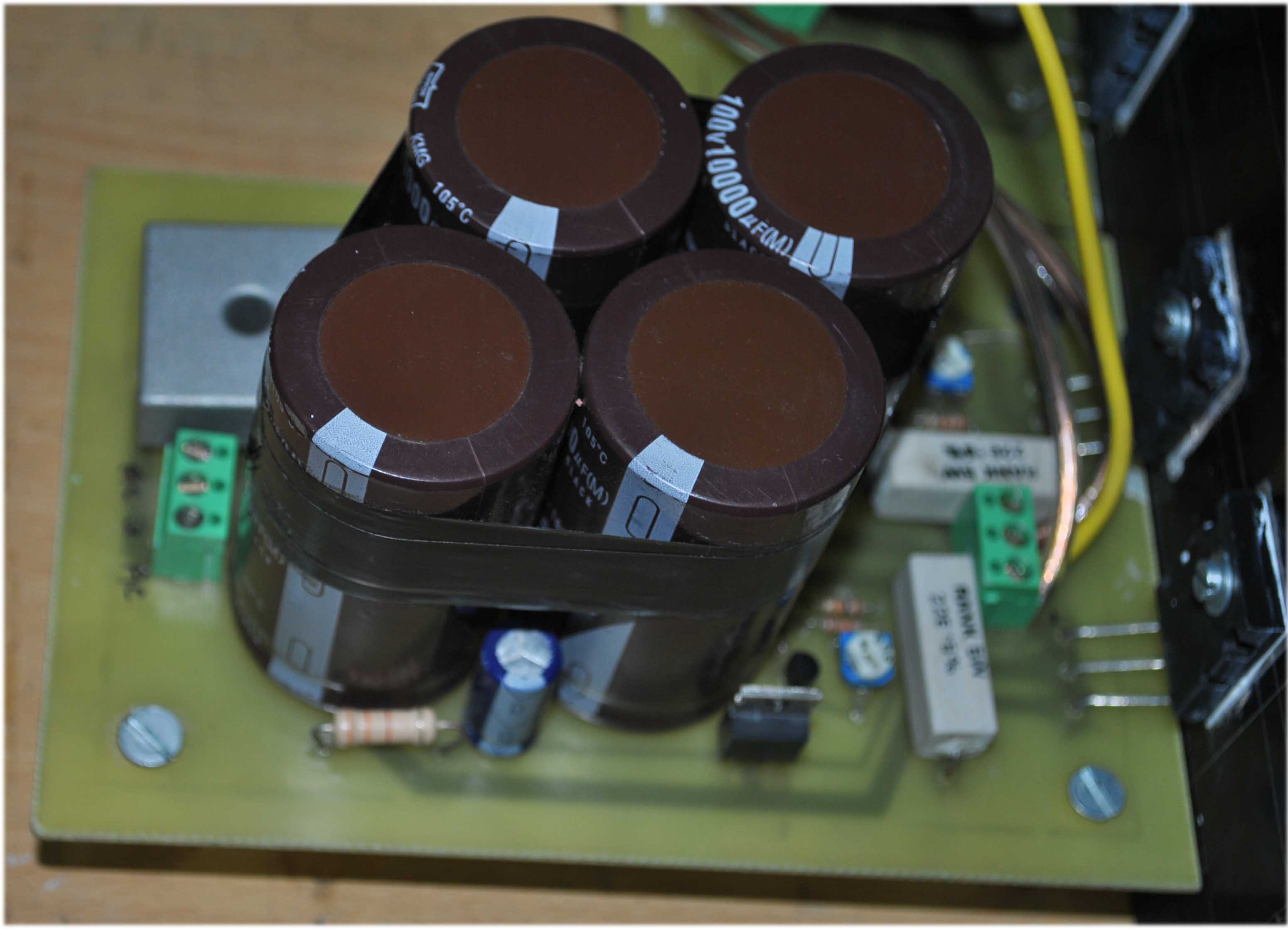

The resistor 0r22/5w in front of 2sa1943 on psu board got burnt .
My psu 24-0-24 before rectification, after rectification 37-0-37.
Yes i followed the diagram. connected the psu gnd , input gnd and out gnd at a common point on gnd next to out
voltage on negative terminal drops to 20v, after connection to b500.
positive voltage is proper at 37v.

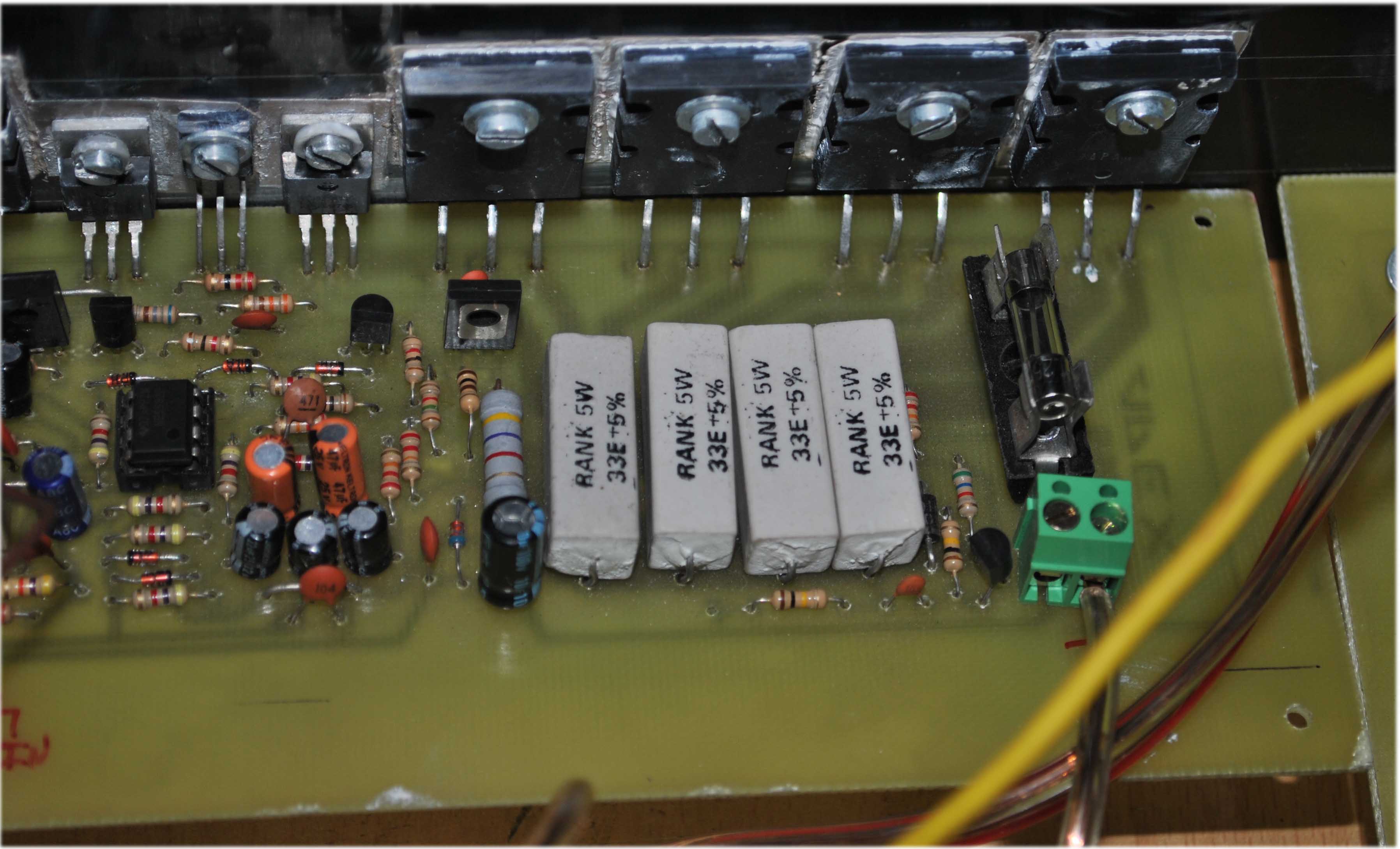

did you test MJE340/350 and 2n5551,5401 unmount it on the pcb then test it with multimetervoltage on negative terminal drops to 20v, after connection to b500.
I tested them, seem to be ok.
I changed 5401 near -90v . The problem of voltage drop is solved. Equal voltages on both terminals.
Psu is also stable and fine no burning , no heating of any parts.
Still no sound.
No current on out.
Still no sound.
No current on out.
I think you mean 33E = 33r = 33ohm resistor.U use 33E or E33 for emitter?
If that is the case, then E33=0r33 = zero point three three ohm resistor.
Do not drop the leading zero. It is important to accurate transfer of information.
