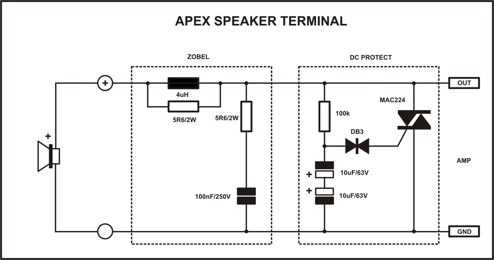

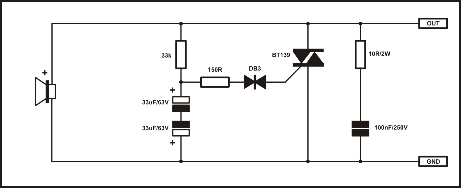

apex sir which is right resistance and cap value for b500 in dc protect. love you.

The Zobel you have added to the right most diagram is an amplifier output Zobel.
It belongs at the amplifier output, not on the speaker terminals.
hi bro , i will use this circuit in b500 amplifier for dc protect if dc out more than 29 volt it blow the fuse and right place of this circuit is on speaker terminal but inside the amplifier. if this circuit use in speaker box then what is wrong? i need value for resistance one use 33k and other use 100k but in studio master amp it is 220k and cap value are not same. thanks for comment.

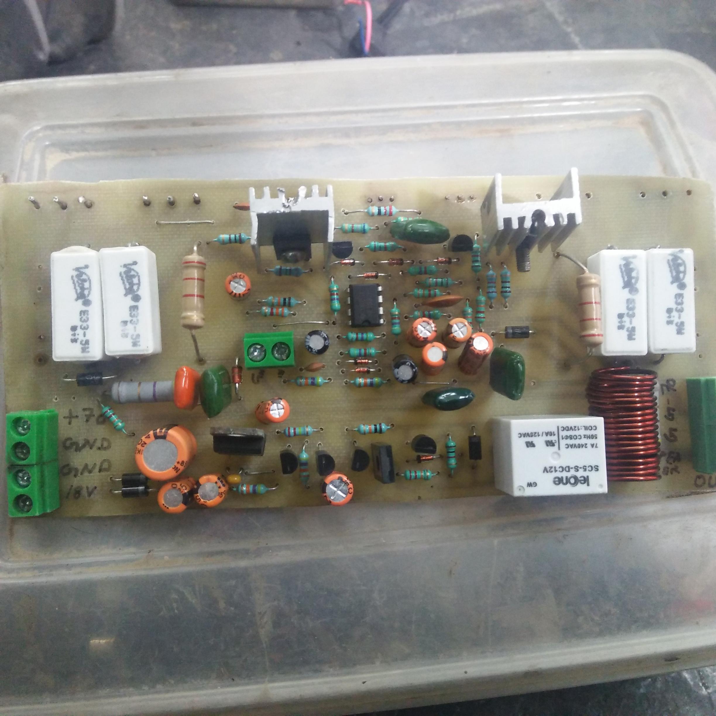

apex b200
apex b something feed with +- 50v dc and with dc protection sound is apex .for indoor use i will set 50 milli ampere per out with hifi speaker.thanks my dear mile.
