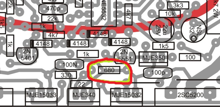

Hello everybody! I did B500, it works, but it does not play cleanly in a small volume. But with an increase in volume plays perfectly. What to check?
Amp is underbiased, replace 680R in bias circuit with 1k pot and set bias to 30mA
This 680R?Amp is underbiased, replace 680R in bias circuit with 1k pot and set bias to 30mA

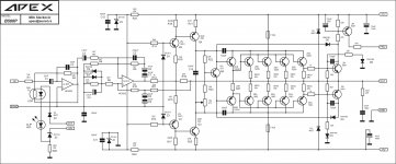

I've made B500 and it has 50mV output DC offset that seems OK, but input has 375mV DC too.
what is the root of this problem, how to fix this issue?

Please check,, input ground should be connected to power supply ground...

I've checked it, there is no conection between power supply GND and input GND.
I've also checked schematic, i couldn't find any conection between them.
it seems that input GND and power supply GND aren't same.

Connect input GND from input terminal to psu GND.

i connected input GND to PSU GND, but it still has -9mV dc at input.
