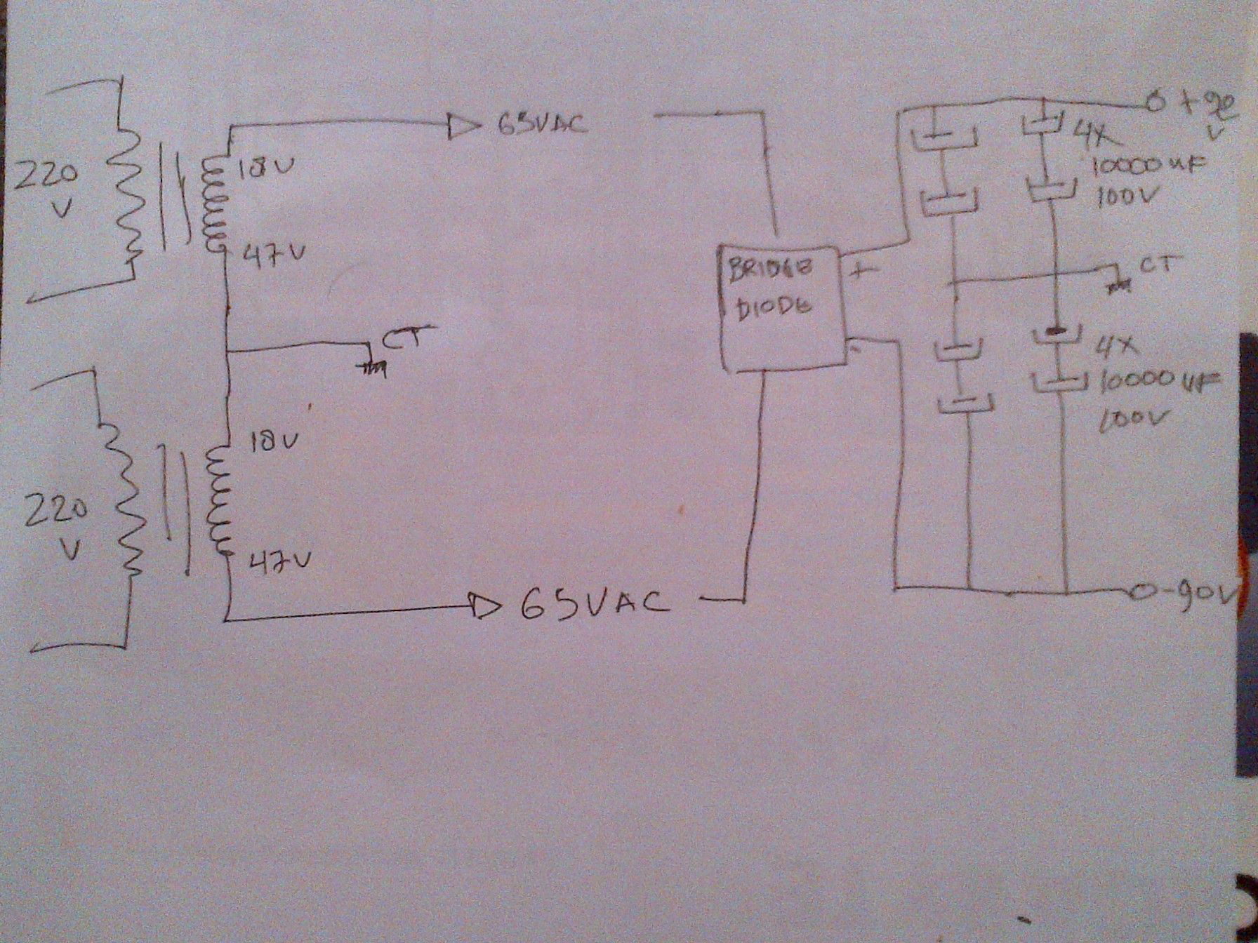

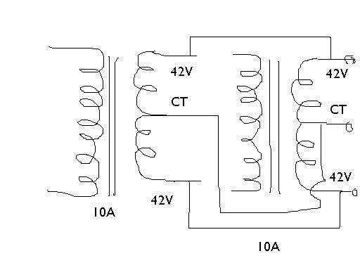

Just Use in series,
18v and 47v using two Oki 10amp transformer (ignore the CT).
Conect 18v from Oki 1 to 47 volt Oki 2 transformer and Use it As CT.
So you will get 18+47 x2
So the pin will be 18, CT and 47 from the second transformer.
Dont forget to Use HI voltage capasitor, im using rayden 10000uf/100v in series and parallel configuration.
Goodluck
Regards from bekasi

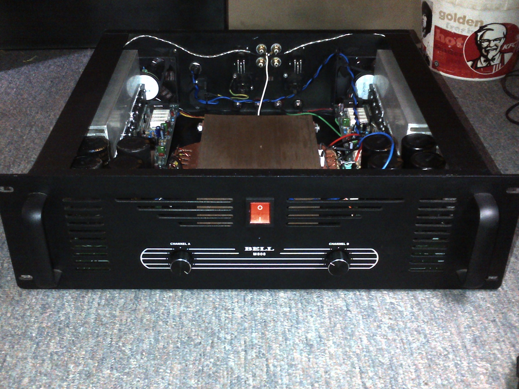

Dear sir apex....just wanna say thx for sharing your design in to the diy comunity, 2days ago i just finish build this super clean amp and the sound is so cristal clear! I cant event heard any noise came out from the speaker. This is super! Cant wait to try H900.
Thx again mile.
Regards

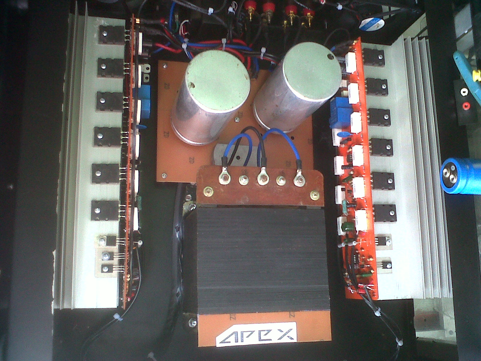

Why not? this is how its look:
Few things need to be done:
1.Replace 680R with 1kohm Trimpot to adjust bias (i still heard crossover distortion when i use signal generator from my iPad).
2.Speaker Protector and Zobel 10uh,10ohm Resistor
3.Balanced Input

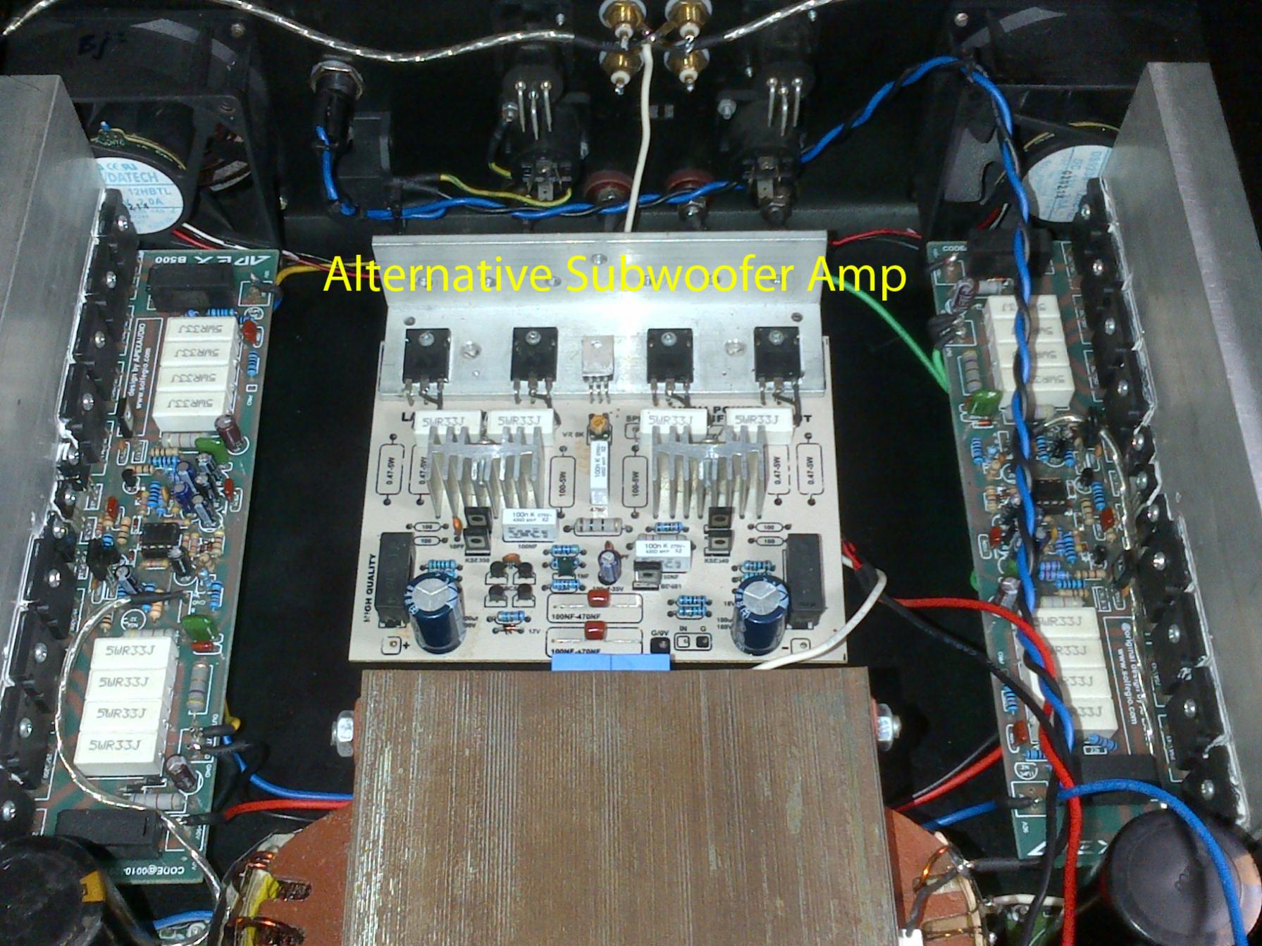

4.Subwoofer amp. i plan to use another b500 or HV230 as sub amp.
5.Add thermal protection.
thx again sir mile...this is the best amp I've ever build.
Regards

i'll try to understanding that, can you share the diagram connection of those 2 tranformer?
regard

Nice amp,
Regards
@vostro...thx for your sugestion.
I need At least twice the power of b500, maybe 500watt @ 8ohm is enough.
To be honest i dont like class d topology, mixing audio signal with square wave, its like a dithering technique in computer DAW for converting hi bit depth to lower bit depth...its sims fake to me. I know class d Efficiency is higher than class ab and also less heat, but class H seems more Efficient to me. Do you have any other suggestion?
