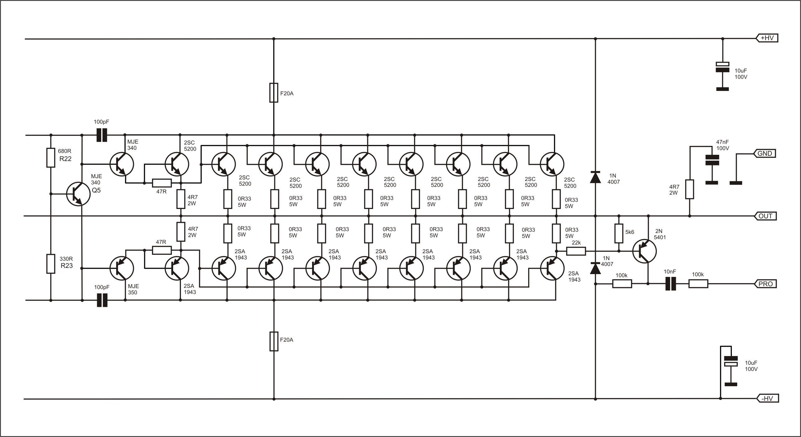

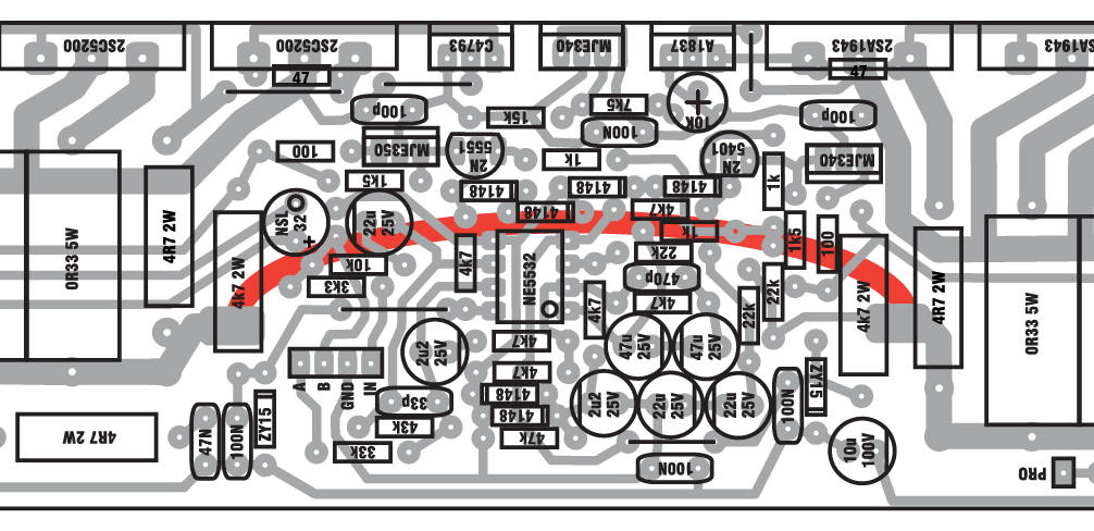

hi apex sir, pls help,
in b500 protection section can i connect 22k resistor to any one of the outputs of 1943 emitter.
in the image it connect to last output of 1943 emitter. is it possible?
can i use emitter resistor .22/5w instead .33/5w.?

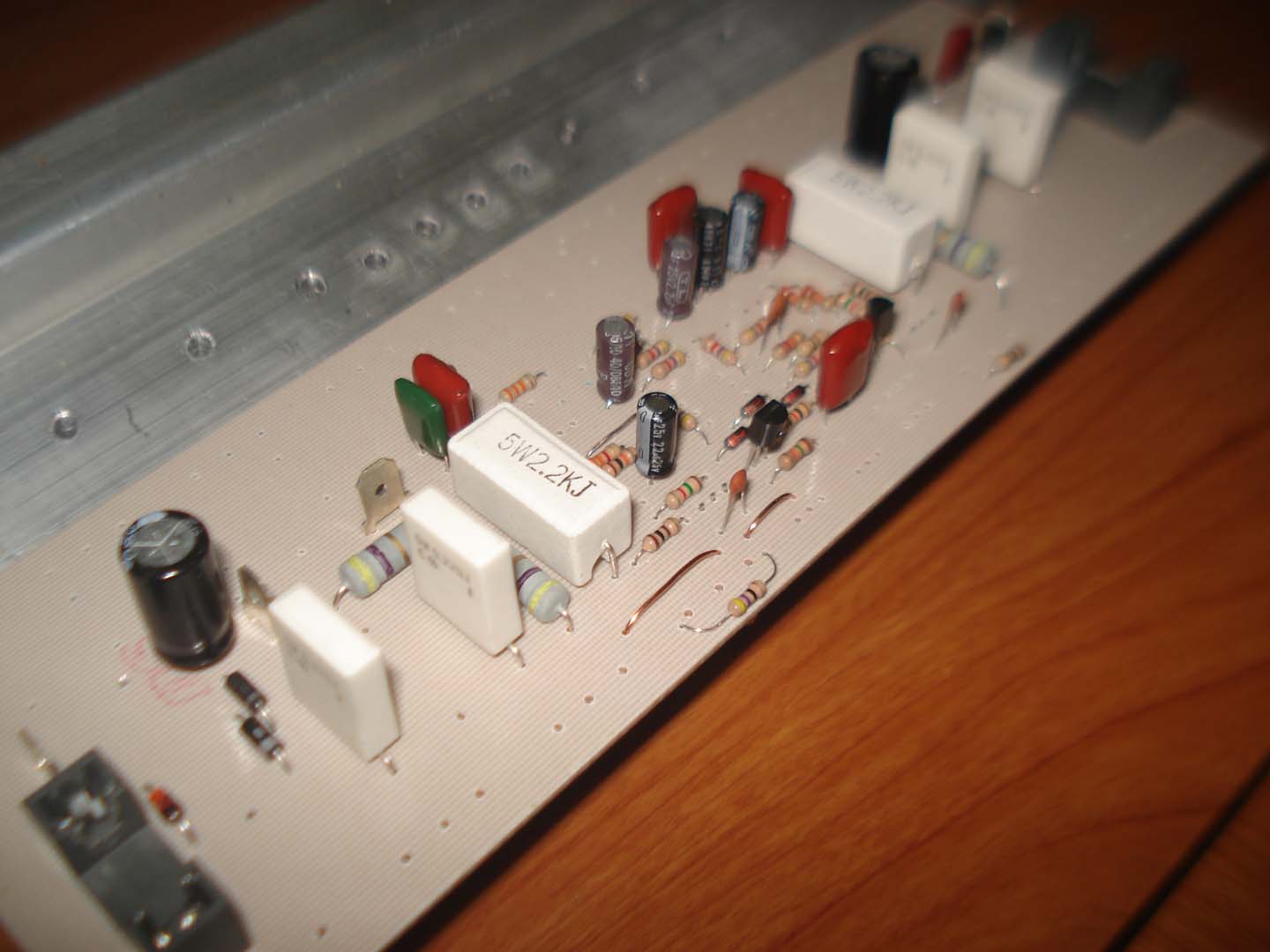

greetings b500 TEF driver stage is working very good only problem when
volume control is fully closed hissing sound comes in speakers any way to make it less
on taking finger near NE5532 IC audio comes i think gain is to high otherwise audio quality is very good
warm regards
andrew lebon
Hi Nazirdigi
greetings just take out BD681 and replace with MJE340 it will work tested it today
warm regards
andrew lebon

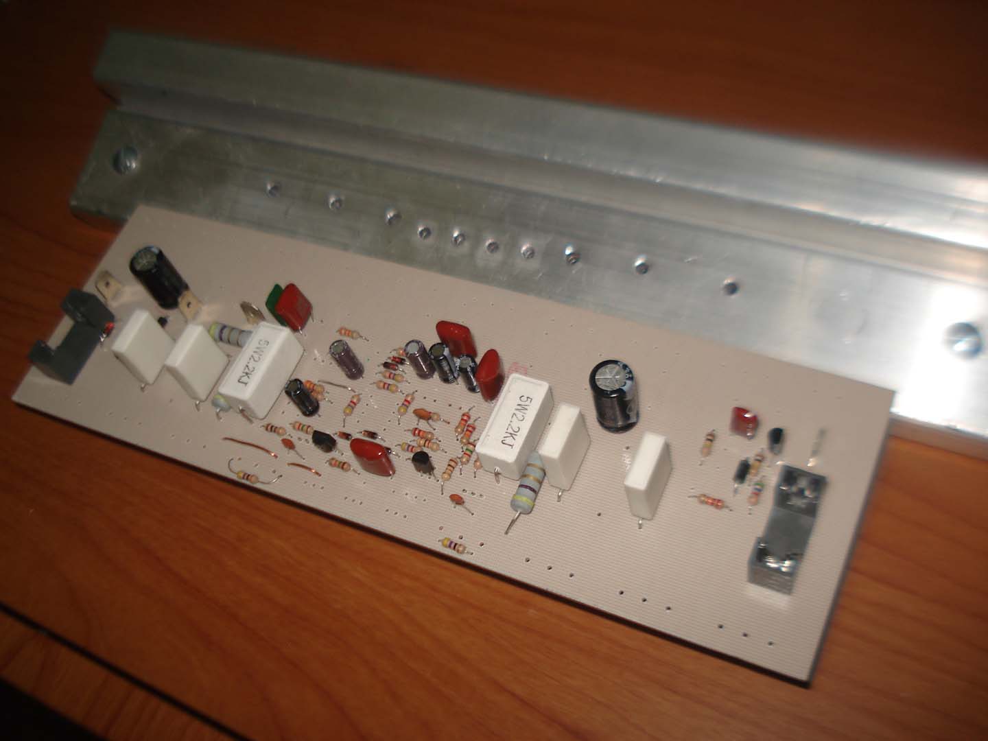

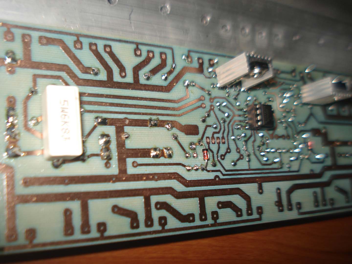

hi andrew lebon,
good result.
1-i want to know what are the problem u faced before?
2-is my b500tef pcb layout correct?
3-which schematic u following?
4-how u adjust the bias? and bias voltage?
5-can u share pcb image of ur layout.

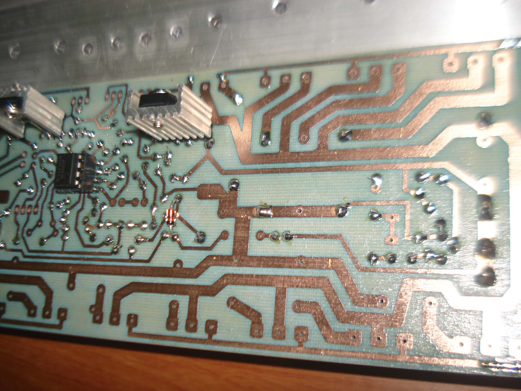

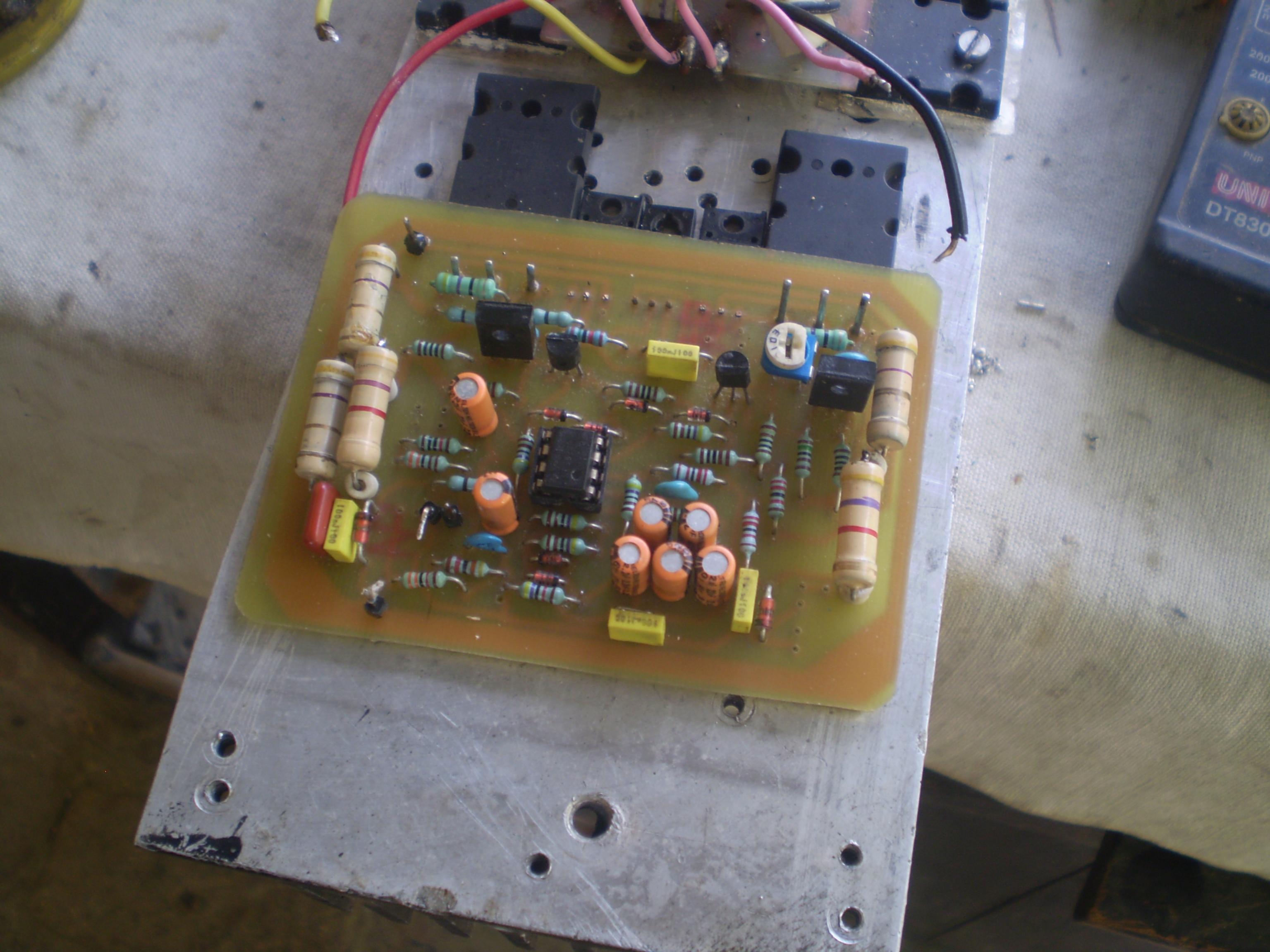

hi apex sir pls help,
tef is working,
i adjust the 10k pot to 2vdc with 10r/10w resistor in rail.
below 2vdc cant adjust because 10k pot is minimum clockwise, if i turn to anticlockwise dc v is increasing, so how can i decrease dcv ? pls reply to this.
the bias transistor is bd681 not mje340.
in the image shows mje340.
