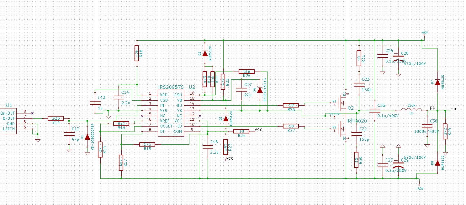

500W amplifier using IRS20955 and IRFB4227
I always insert a low value (10 ohm) resistor in series between pin 13 of the IRS20955 and the centee node of the upper and lower mosfets. Then from pin 13 to pin 9 of the IRS20957 insert a catch diode rated at 400v 25-35nsec Trr right at the IC. This will prevent destruction of the 20957 if there are some unwanted switching spikes due to "poor" layout.
The PCB trace from pin 13, through the 10 ohm and to the centre node must use thick traces (3mm) and be as straight and direct as possible.
Would not this make OCP , over current protection out of operation?
If I am correct, , 500W around 15A, and 25W dissipation caused by Rds (on),
could work with good cooler, but, what about paralleling two mosfets in half bridge ? can that work? half bridge with 4 mosfets than only 5W per mosfet. Usually mosfets can be paralleled cause positive temperature coefficient without any resistors
Sounds like a nice idea to parallel two of those. Paralelling two smaler devices instead of uing one bigger is on the on hand very nice, becasue of halving the thermal resistace to heatsink and halving the parasitic inductances, but it also complicates the layout, heatsink mounting and increases costs.
Mosfets are perfectly parallelable with independent gate resistors.
Regardning Rdson I suggest not allowing the body diodes to conduct, anoher words to ensure that current times Rdson is lower than diode drop (0.45V or so)
I think that inductor from LC filter current makes it conduct no matter what you do

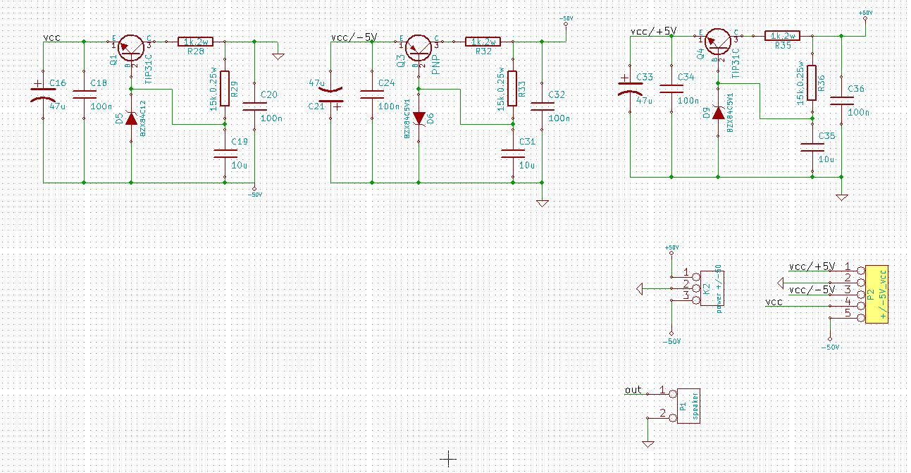

There is attached power supply and IRF20957 schematics
please check for mistakes , bad connections and orrientations..😀
Thanks 😀
irf schematics is according to iraudamp7 and iraudamp4 and other irf notes
